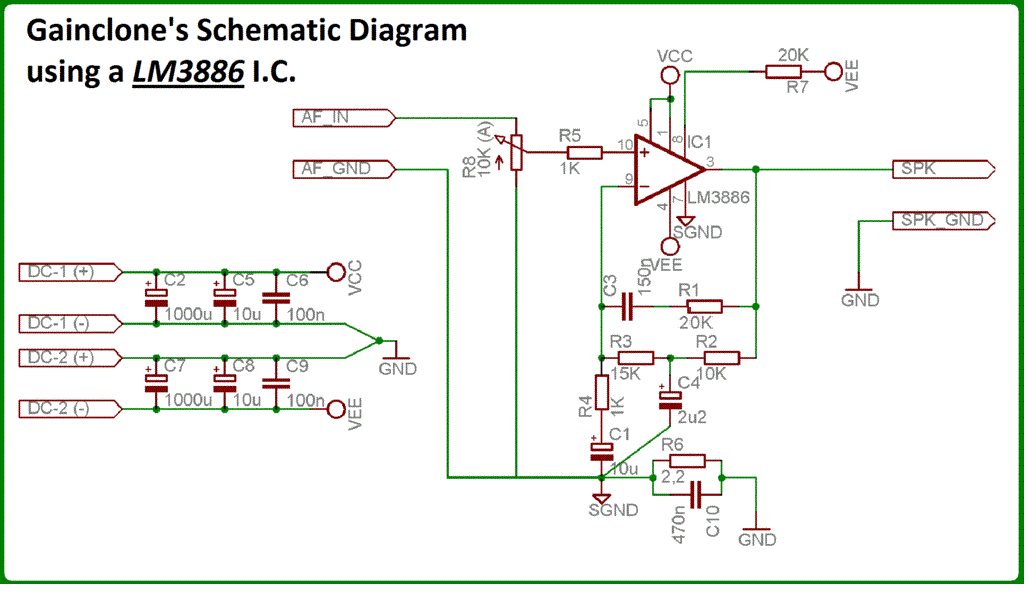

put the negative meter probe on the power supply ground, put the positive probe on the input ground next to the input connection. you showed that on the board layout as having been isolated from the power ground by a 2.7 ohm resistor.
Jed, None of the board layouts are his. This is kind of a double hijacked thread.
that's ok, since there are serious problems with both layouts, and neither of the people posting them seem to have a clue what the schematic of their board is, or how they work. i'd like to help them out, but if they had the basics of op amp troubleshooting down, they should be able to figure it out themselves. there are a few aspects of an LM3886 that are a little bit different (such as the zobel network at the output, and the need for carefully planned ground and power traces). one of the things that makes the board layouts shown in this thread problematic, is the fact that power and ground traces have been laid out poorly, and can cause distortion or instability through magnetic coupling, and neither board used a true star ground. the second board with the isolated input ground (through a resistor) also has the wrong component values in the zobel network. a rule i have with power amp designs, is don't do anything in the design without knowing why. that includes the schematic design, the types of components used (metal film vs carbon film resistors, etc...) and the board layout. if you don't know the WHY, then when something goes wrong, you won't know WHAT or HOW. i was trying to help alexisk10 troubleshoot an offset problem. offset problems are super simple to figure out, if you know the usual causes. in this case, i think he either got the wrong isolation resistor (too high a value) or forgot the isolation resistor from the input ground to the power ground. so the input stage has no ground reference, and you get it latched to a rail. if it were me building that board, i would replace that resistor with a jumper, first of all because National's reference designs don't include it, and the WHY of that resistor isn't made clear. the WHY of National's reference design is simple and clear. the data sheet, and any application notes for the chip should be read carefully to understand the proper way to design an amp with this chip.

if you look here https://www.electro-tech-online.com/custompdfs/2012/08/snaa021a.pdf and read the app note, several functional amplifiers are described, and nowhere does it mention isolating the input ground. with the amp designs shown, the noide level is below -100db. with a properly laid out star ground, no isolation resistor is necessary. the "feedback" through the ground you are talking about is from a poorly designed ground, which will have voltage drops across it, causing instability, noise and, distortion. the isolation resistor is a "band-aid" for a much more serious problem (an improperly laid out ground system).
an app note that shows as well as describes proper board layout for an amplifier is here: https://www.electro-tech-online.com/custompdfs/2012/08/snaa031.pdf

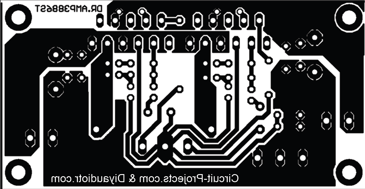

ok, i'm going to post this just for information then.... in case anybody comes back later through a forum search. the PCB layout in post #7 has a poorly laid out ground system, and the person who laid out the board has chosen to isolate the input ground from the power supply ground through a resistor. this isolation is only a "band-aid" and really doesn't help much, as it will become clear. shown below is a rough model of the ground system showing the arrangement of resistances within the copper. the ground trace carrying almost all of the ground current begins at <spkr_gnd? and ends at <vcc_gnd>. since this is a buss ground and not a star ground, currents travel linearly through the copper, creating a voltage divider between the various points along the buss. the <zobel_gnd> is next in line, followed by the <input_gnd>. with current returning through the <spkr_gnd>, there will be a voltage developed across these copper resistances, in phase with the input signal. a portion of this voltage will appear on the <input_gnd>, in phase with the input signal, resulting in positive feedback to the amplifier. positive feedback reduces the stability of the amplifier, often causing oscillation. oscillation will be snubbed by the zobel network, but since it's ground return is attached between the speaker ground and input ground, will also add positive feedback to the amp input, continuing the oscillation. another problem is that <+vcc_gnd> is also on this side of <vcc_gnd>, and any ripple current through the capacitor will develop a voltage that will also appear on <input_gnd> and add a 60hz sawtooth voltage at the input of the amp. granted these voltages are very small, but they are there and they do add up, and are reinforced by the speaker current when they appear at the amp's output. adding a resistor to isolate the input ground doesn't help much, because the resistor floats at the same potential as <input_gnd>. to eliminate this voltage divider within the copper, a star ground is required, terminating at the <vcc_gnd> wire. the ground system on the board layout in post #1 is better, because it is a star ground.

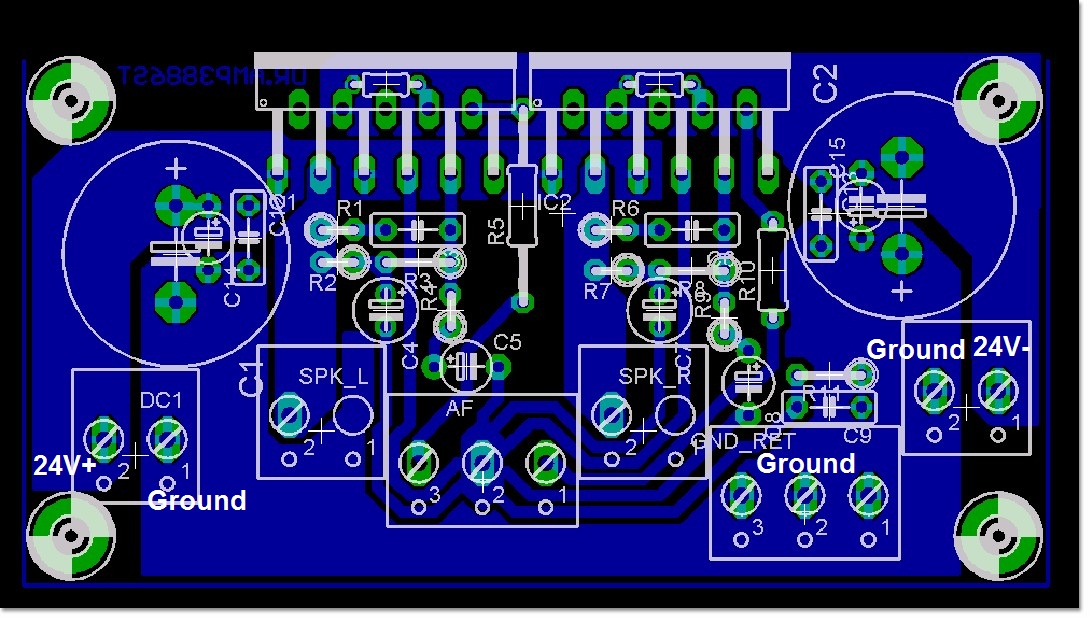

Hello friend can you check my circuit and pcb image is this circuit is o.k
when i measure my output from pin 3 and power ground it showing -32volts what's wrong with the circuit. plz plz help me.
you probabbly don't have the jumper between the power ground and input ground connected. and AG is right, how can you have -32V at the output with +/-24V supplies?.... maybe you're measuring from the wrong point? or if you are measuring from the input ground, and it's isolated from the power ground, the input ground is a few volts positive, and your output is at the -24V rail, and that could add up to more than one half of the supply voltage.
