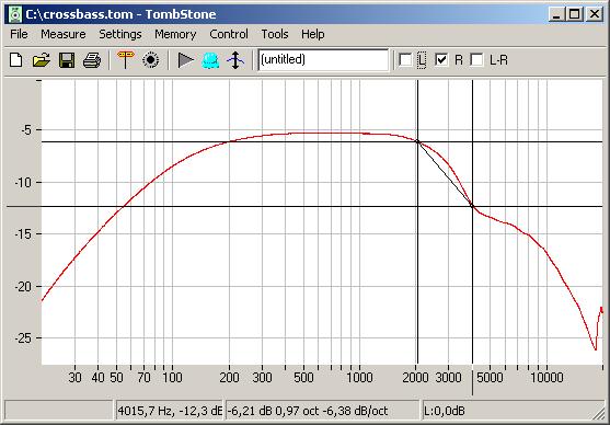

hi the graphs look better now:D the slope is where the amplitude drops with increasing freq in a low pass filter (for the woofer) and when the amplitude drops with decreasing freq in a high pass filter (for the tweeter). Its the steep part of the graph in each case.
Have u checked the coil value? it seems my guess was far off :D from the looks of the response and the capacitor value (3.3u if u haven't changed it) i would say its between 0.4m and 0.6m :D.
actually no.. :D i was waiting for you to explain what is slope...
if i am correct the slope is exactly at 2000Hz for the woofer and
and about 5000Hz for the tweeter...maybe? :confused:
I don't know if i should use this calculation "L=2.54/F" or the first one.
The photos in the first pages aren't helpful to understand which type of crossover i have?
so......what's next?! :)
the slope starts at those freq. Set the cursor at 2000 and the next cursor point at 4000 Read the diference in level it should be 12 dB for a second order filter (12db/octave). A closer look indicates that ur filter is a second order LR at 3kHz which means ur coil is about 0.8mH 0.85mH. See at what frequency the level is 6dB lower than the linear region (300 -1000 Hz). If it is around 3kHz then ur coil is likely to be 0.85mH.
if i zoom more i see that the slope starts at 1440Hz
anyway...too much detail probably! :D
from 1440Hz to 4015Hz it's -12,2dB
the program has 3 small windows which one i look? the second says "1,48oct -4,49dB/oct"
from 2018Hz to 4015Hz it's -12,1dB (0,99oct -6,21dB/oct)
i think that 6dB lower than the flat region (350-1000Hz) it's at 3700Hz :rolleyes:
look at the xx dB/oct and look after 3700Hz this time.
well my guess is that its 2nd order LR and ur coil should be about 0.85mH. Between 0.4mH and 0.9mH anyway hahaha. Well if u like the sound with those filters the next improvement is to add a Zobel network for the problematic woofer when u'll have the parts available. U said u have some 1st order filters? How many? and do u know the components' values on that one?
Most comercial xovers are either LR or butterworth and are usually cut around 3kHz. Seeing that u have a 3.3u I figured it had to be a LR, butterworth uses bigger values for the capacitors. The fact that u found -6db at 3.7kHz further more confirmed that. If it would've been butterworth it should've had -3db around 3kHz...
If u want to addapt ur xover for ur drivers impedance u should cut the coils in half (the wire lenght i mean) and double the capacitors...
The zobel makes ur woofers impedance linear so at the xover freq the woofers impedance will be around 4 ohms not bigger. This will give u more balance because without it the xover point for the woofer wont be at 3k but at bigger freq.

Dear friend, for ur further understanding of the intricacies of xover design (I just learned this word and i was dying to use it :D ), i will reveal to u the secret formulae for a 2nd order filter: the inductance is
L=Z/(2*pi*f*Q), the capacitance is C=Q/(2*pi*Z*f), where Z is the drivers impedance, f the xover cut frequency, Q is related to damping and is 0.707 for Butterworth (wich gives -3db at f) and aprox 0.5 for LR (which gives -6db at f). As u can see from this lowering Z by half will also lower f by half increasing Z also increases f.
The reason i dont encourage u to cut the coils is that u cant tell for sure where is the half of the wire's lenght. u could cut in steps and measure the response after each cut.
Lets see what we've learned until now. We have a xover that cuts at 3k (aprox) 2nd order at 8 ohms. With ur woofers impedance at that freq being bigger than 8 ohms its fair to say it will cut higher. However the tw impedance is quite linear so the tw is cut about 1.5k-2k which is 2 low. From the pics u posted it seems much easier to modify the tw coil so do it. cut the tw coil in half and double the capacitor. BUT I remember there was a 4 ohm resistor between the filter and the tw if this is so leave it right there for it will make the total Z around 8 ohms so the above modifications wont be necesary. Also that resistor provides a 3db loss in Spl also required for the tw is more sensitive than the woofer. So the tw part is done. Now for the woofer u should put a Zobel network so that the woofers impedance will result in 8 ohms. Yes 8 ohms so that the filter cut point will be at 3-4k same as the tw.
