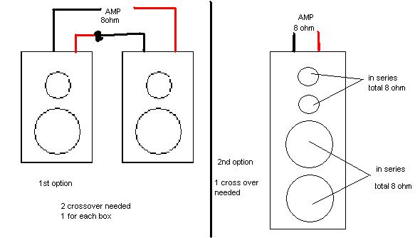

as i said before i want to use my LM3875 with the specific speakers...so from what Audioguru and Nigel Goodwin said i don't know if i can connect them in series so i can make them 8 ohm without loosing sound quality...i guess i should try it...what's your advice?

first a crossover is mostly design by ear u must play with it until it sounds better. tell u what if u plan on building the xover first build it without C5 R10 and R6 this will give u ordinary 3rd order butterworth with 2200Hz for woofer and 2700 Hz for tw (connect the tw in normal polarity this way, the + of the tw goes to where R7 and R8 join) listen how it sounds then add C5 R10 and R6 and reverse the polarity of the tw.
2nd about ur LM3875 problem my advice is this get the speakers out of their currently boxes and build a new box with 2 woofers and 2 tw ;) the xover also needs modification for 8 ohm.
3rd about the coils.. i suggest u use 1mm wire u need something to turn this wire onto preferably a cilinder that will support the coil . At the coil diameter u input the cilinders diameter and at the lenght ...its lenght. im not good with english i hope u understand if not we'll keep trying :D
let me know what u decide about the lm3875 issue

the xover must be modified for 8 ohm only if u build a new loudspeaker with 2 woofers and 2 tweeters as i sugested. this way u only need 1 xover. If u plan to use ur current speakers in series than u need 2 of those xovers (1 for each box) with no modification. Yes in that configuration all the coils are mandatory.
i think there is a misunderstanding and it's my fault.
i have a pair of 2 way speakers...every speaker has 2 drivers (a tweeter and a woofer) and they're connected the one to the left channel of the amp and the other to the right.
When i say to connect them in series...i mean the drivers and not the hole speakers! ;) (i use to call speakers what you call drivers sorry...) :D

in this case the xover i gave u can not be used
i will modify it for 8 ohms

the values in that diagram are calculated for 4 ohms dont use them.
for the next xover u can use those coils only if their value is higher than those on the xover. that way u can cut some of the wire so the value will drop. anyway u can use that plastic frame (assuming its plastic).

I have only one pair of speaker boxes and i'll connect the drivers of each speaker box in series..and each speaker box will be connected to the corresponding channel of my amp. i hope we are saying
the same thing..
