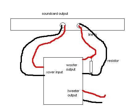

i'll try to determine the coil's value, or if u want to, there is way u could find out the value urself. take this little program put the left channel from ur soundcard's output to the xover input. at the xover output coresponding the coil u want to determine, put a 8 ohm (8.2 ohms)/1W resistor. the connect this output (with the 8ohm load) to the left channel of the line in input of ur sound card. Select from ur windows mixer line in as input source and run the program. U will see the response of the filter. note the frequency where the amplitude starts droping (in theory if its a butterworth the corner freq is at -3db). after u noted this freq use this formulae to determine the value:
L=1.8/F aprox. put the freq in Hz and u get L in H this formulae works for butterworth xovers, if its a LR xover then L=2.54/F. if u dont know the type use the butterworth.

hmm something is wrong . u should put the resistor like u put a driver and the line in from the soundcard the same ( must measure the voltage across the 7 ohm resistor). the soundcard output should be connected like the power amplifier. Also if ur using the left channel from the line in declick R and L-R from the top bar it will give u a cleaner view
hmm they still dont look right. Dont use L-R use only L, for the tw is ok as u can see it starts droping below 2000. U can use the cursor to determine the slope of the filter. thus the order. This way u can check if its ok. For the woofer the graph should fall after a frequency in the mid range. If u could make a drawing of ur setup i could see if something is wrong. Anyway here is the how it should be done.

i don't know what is wrong, the cable setup is ok..this is the best i can do
i have changed from L to R channel and also the cables. Probably this is the frequency response of the crossover :rolleyes: :eek:
P.S i've done the tests with Sound Blaster Live and i've noticed that when i loopback tested the card with a simple cable i had ripple in highs...i could use the onboard sound card...but i haven't installed any drivers :D
i'm sure this software has flaws of its own.... i mean its under 1meg what can we expect :) but its able to make a picture of whats going on. Now i see your Y scale :D.
Try adjusting the Y scale i see 1 div is like 50dB thats too much. The graph might be good. Make it show 0 - 50 db. Ur soundcards noise floor could also be blamed. Also use the cursor to determine the slope!!!
