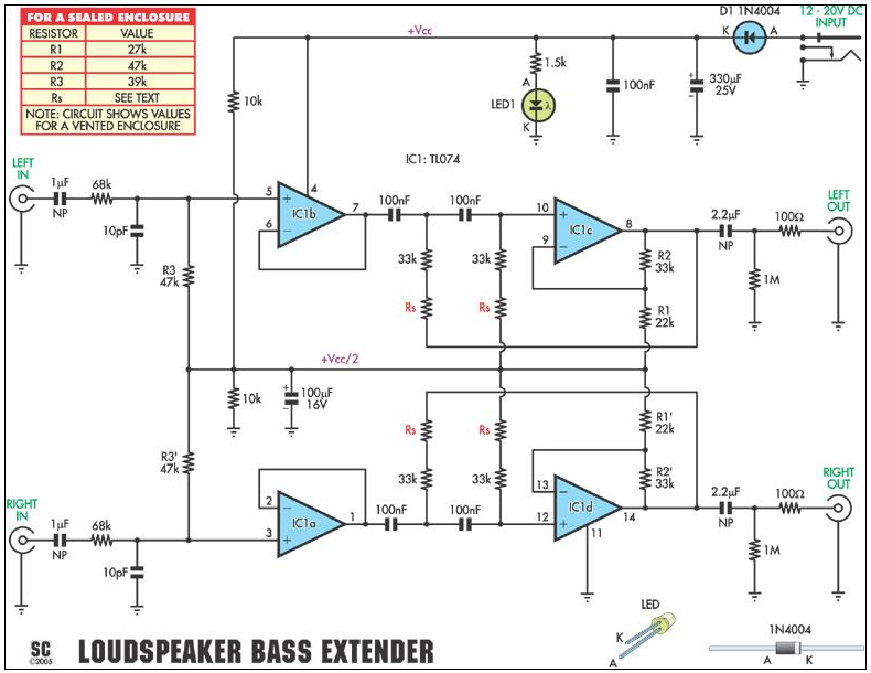

I picked up some thrown away finished speakers in nice looking enclosures that were way too small for the garbage 8" drivers they had. Then I bought pretty good woofers and tweeters for them, used Boxplot to make the vent tune to a frequency too low then used tuned bass-boost to make them sound perfect.

My tuned bass-boost circuits use a 2nd-order equal-values Sallen and Key highpass filter with too much positive feedback. The boost is 10dB at 38Hz and the small speakers sound like a much bigger speakers.
Years ago I did the same circuit for a 4" sub-woofer that I played at the beach.
Recently, Silicon chip magazine has a very similar Bass Extender project.

Neat circuit thx. In IB speakers this is a good improvement, but in bass reflex i belive u lose the tightness in bass because of the lag. I reckon that is more or less noticeable depending on the type of program u feed it with.
Because the enclosure is too small, the low frequencies are reduced in level. When the bass boost increases the level of the low frequencies to normal then the delay caused by the tuned circuit is also boosted to normal. If the bass level is increased to more than normal then the delay would be very noticeable.
The circuit also adds low frequencies to my sealed speakers that have an fc of 60Hz without the circuit and 38Hz with the circuit.
Hmm... it is my opinion that GD doesnt reduce with signal boost on the contrary. But this depends on many things as well as the woofer itself... on very small boxes the freq where GD has its peak, may be outside the speakers range so it wont be noticeable. Mb i'll give it a try in my next project and see how it sounds, but small boxes may be the important factor that makes it work.
