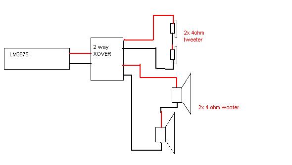

Whiz is this the setup ur thinking ( this is what i understood). Using the drivers like this there wont be any problems with the phase (electricaly)
but for a stereo setup u need 4 woofers and 4 tw.

hi whiz from ur drawing i cant see how u solved the impedance problem using only 1 woofer and 1 tw in each speaker will still lead to 4 ohm speakers. u cant put the woofer and tw in series to get 8 ohm...
the dcr of ur coils is pretty high, what diameter has the wire?
Hi!
i haven't done anything yet...it's just a thought that i could connect my woofer and my tweeter of each channel in series... :D please explain why it can't be done... (we only connect 2 tw or 2 woofers?)
what's dcr? and in which cable you refer to? things are bad? nothing can be done? if that is the case...then please advice me something simple and effective so i can make things a little better.
P.S i don't have the means to move on to an upgrade of my sound system.
thank you!
Hi i will try to explain this as simple as i can..:p
u cant put the woofer in series with the tw (without a series xover) because for the signal to get to the tweeter for example it must pass through the woofer but the woofer impedance its not 4 ohm at all frequencies its only in a region lets say between 100 and 600 (mb higher mb lower depends on driver) after that its impedance is getting higher. so u can picture how much power and at what frequencies gets to the tweeter :D The tw will be hit with high power at frequencies it wont accept.
A series xover ( a first order is a capacitor in parallel with the woofer and an inductor in parallel with the tw) offers another route for the signal. So to continue with my example the high freq part of the signal wich where "blocked" by the woofers high impedance can now go through the capacitor which has a much smaller impedance at those freq. so at the tw the high freq will arive at a much higher power than the low frec. BUT! Using this type of xover sets the total impedance at 4 ohms because at high freq u will have the tw impedance (4 ohm) in parallel with the coil imp (which is much bigger) and this will result in 4 ohms imp. same at low freq the woofer impedance will be 4 ohm in parallel with the capacitor which has high Z at those freq so still 4 ohms.

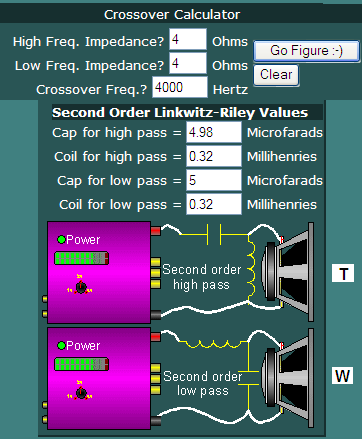

I found this crossover calculator program:
Yes the capacitor seem small
for a given freq. the capacitors are higher for 4 ohm than for 8 but inductors are smaller

1st order crossovers totally disappointed there isn't much difference so i am exactly where i started.
I believe the only cost effective solution is to modify my 8ohm, 2nd order crossovers
to work with my 4ohm speakers...
from an online calculator i got some values for a 2nd order crossover and i think i can easily make the modifications i only gave speaker nomimal impedance and crossover frequency and it gave me the values i need for the capacitors and the coils...so i only have to change to bigger capacitor and smaller coil, but i need help with the coils...i only know coil resistance not "mH" how can i convert mH to ohms so i can cut the coil to the proper size?
