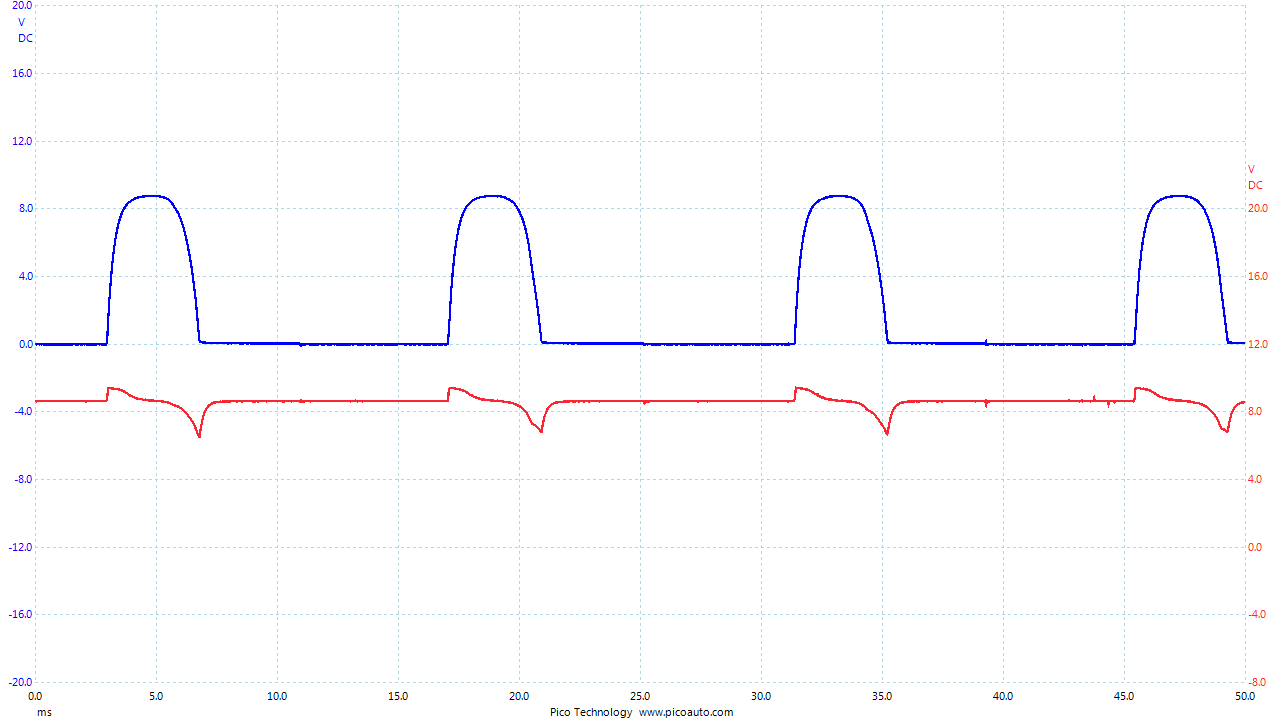

I see what you mean - and also, with diode no3 connected between input line and ground, the oscillations should not drop below -0.7v, but they go to almost -2v.
Let me check it again and come back to you.
Scope image taken again as the original ones were wrong - not sure why but I suspect something wasn't connected properly. At least this is more credible. As before blue is before diodes and red is after.

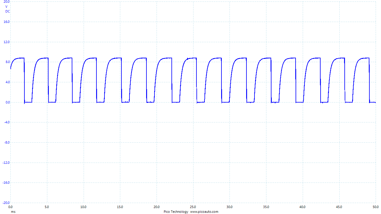

Hi
Can you get an image of both waveforms at high rpm?
It might help answer those questions.

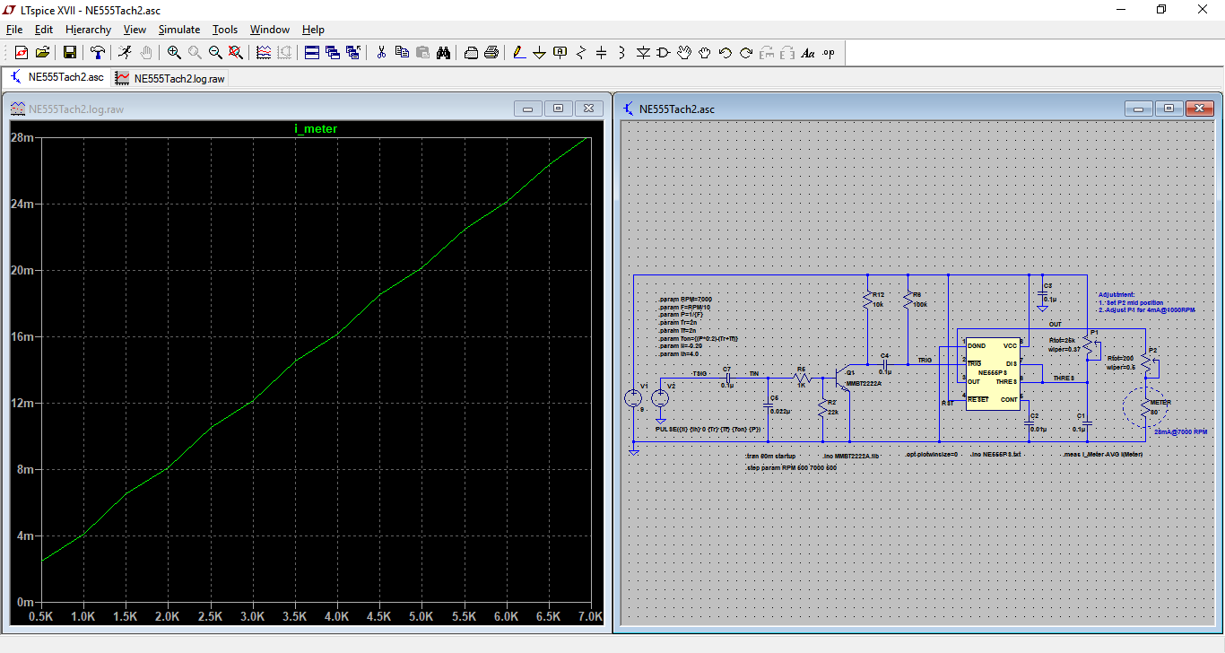

So I went back to the bench to test a 555 version.
I made a few changes...I changed the base resistor from 47k to 22k to ensure the transistor switches to a low enough voltage to trigger the 555. I also didn't have a BC547 so used a 2N2222A. I also removed the input diodes and ac coupled the input and ac coupled the output of the transistor to the 555. This actually worked pretty well. Tested the circuit by generating a square wave input signal of +0.8, -0.2 from 50-700 Hz. The tested circuit is attached.
eT

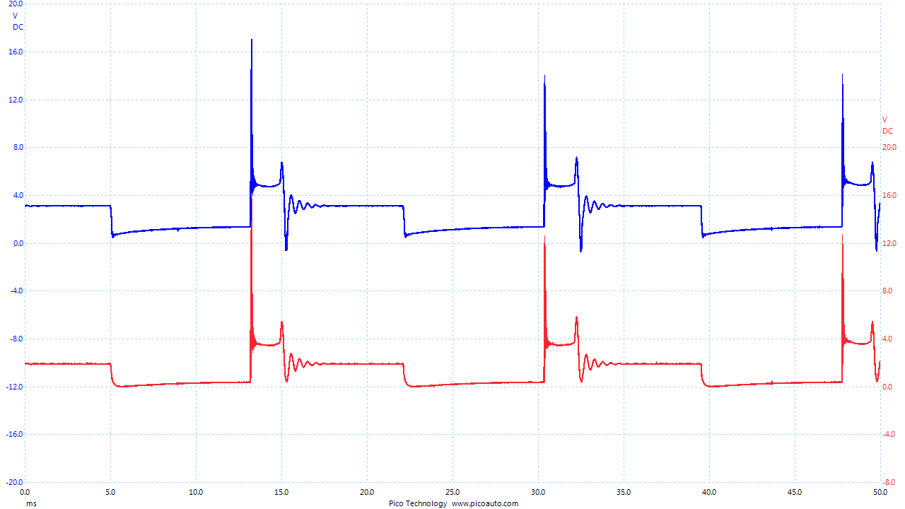

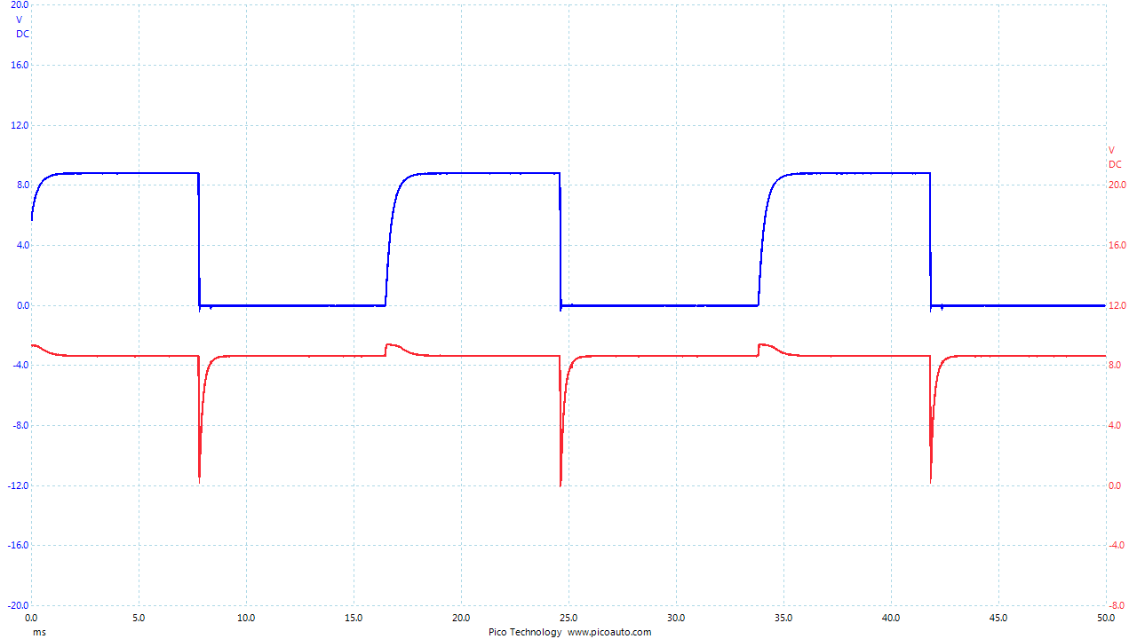

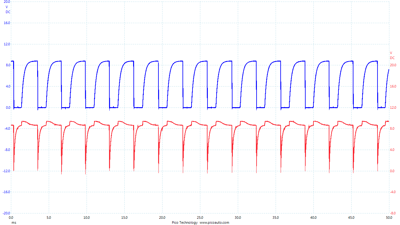

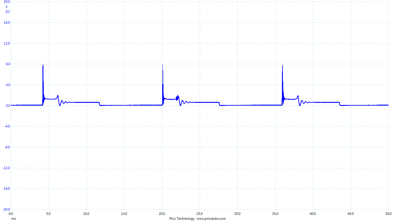

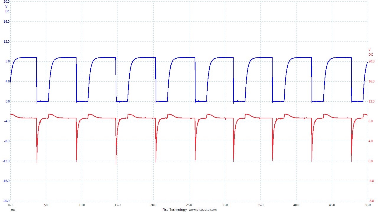

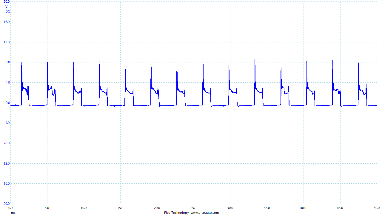

I took some scope images of what is happening yesterday. RPM is approximate, especially when the tacho was not working and I had to guess the RPM. Blue is transistor collector and red is edge trigger output/pin 2 of 555. It is clear that without diodes the transistor switches on much slower at low RPM and the edge trigger does not allow the 555 input to go low enough to trigger the monostable.

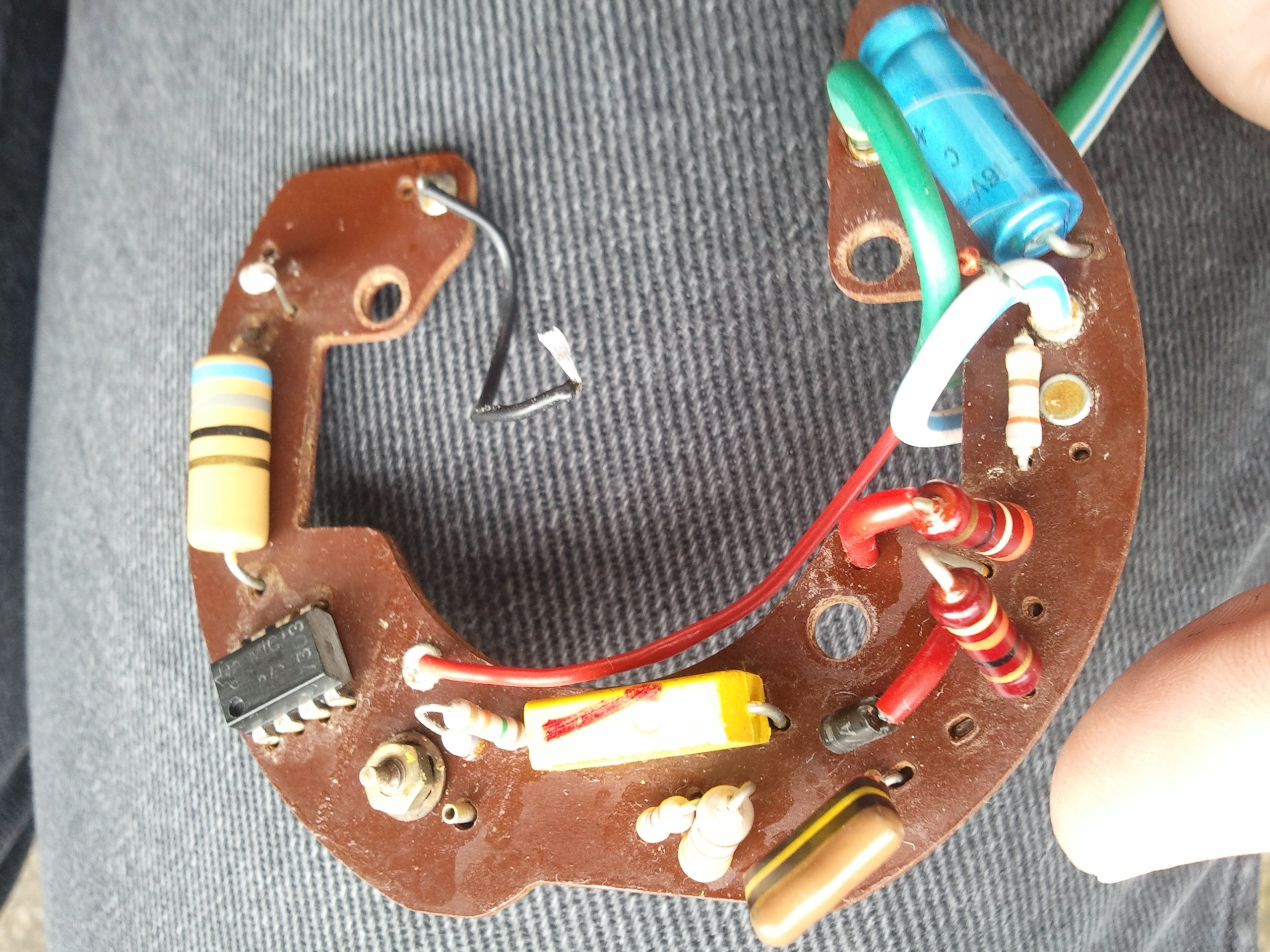

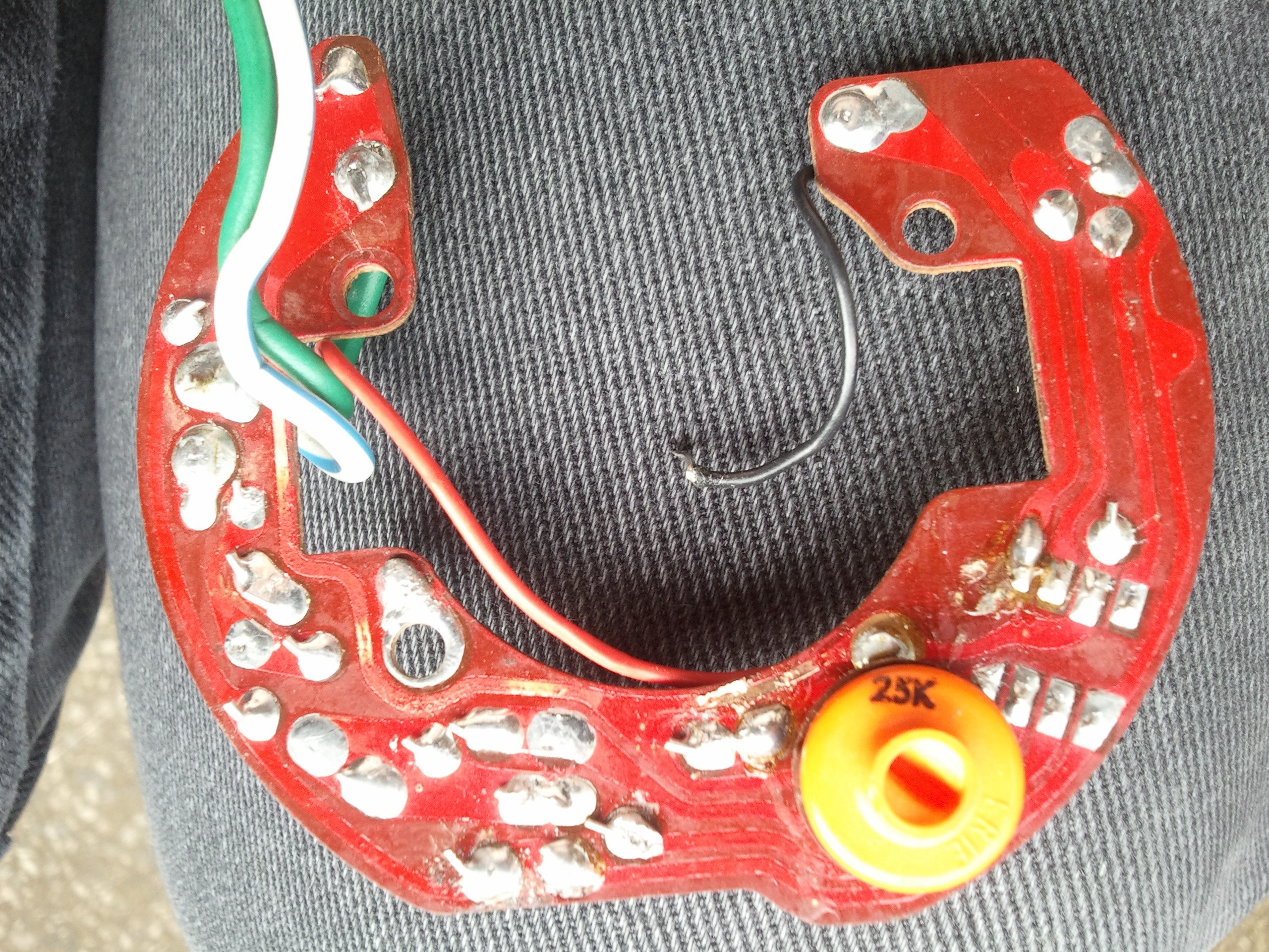

Hi
When you get a chance can you post a photo of the top and bottom of the original tach circuit board? I'd like to look at the components connecting the chip. Especially the tach input circuit.

Hi

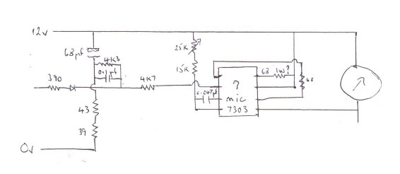

I can do better than that - I've laid down a schematic on paper. I did that first when I was trying to get a useable signal for the 555 and the LM2917 but wasn't successful. Let me see if I can find it later today and come back with it.
Photos of board and schematic.
Green = +12v
White/Blue = Tach signal
Black = Meter -
Red = Meter +
I know there is a broken track on the board but I'm sure that must have happened later as I would have spotted it. It has been lying aroung and knocked about since being removed.

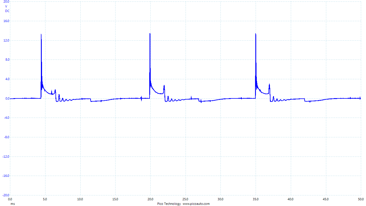

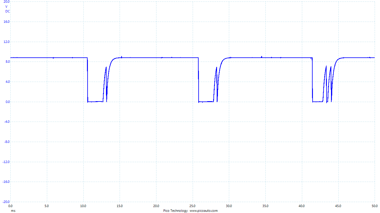

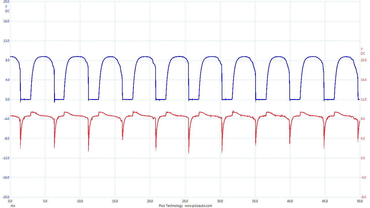

I tried what you suggested in post #47. Firstly I have to admit to another mistake - the base resistor was not 47K but 4.7K. I realised this when I went back to change it to a 22K as you said. I also removed the diodes from the input line and inserted a 0.1μf cap instead. What I found now was that under 1500 RPM the needle was very erratic, and I took some scope pics to show the problem. The first image is the tach signal that comes from the ignition system. This was taken with a 20:1 attenuator so the initial spike is around 160V. I took this to show you the kind of signal we have to deal with. When you look at the next two at idle RPM you can see that some of the coil oscillations are also causing the transistor to switch on, and we get additional triggers of the monostable when we don't want them, hence the erratic needle. At higher RPM (3000 in this case) this does not seem to happen - the transistor is switching on and off cleanly.

hi
Yes...it would have helped to have a Jaguar V12 to experiment with..;)
I'm not clear though on how your schematic is working. Looks like the tach signal peaks at 160 volts...are there any zener diodes being used?
I'm still curious about where the tach signal source is connected. In post #56:
2. The car has electronic ignition, currently running on the later Lucas AB14 amplifier, and the tach signal comes from the amplifier. At some point I plan to go back to the original Lucas OPUS system if I can find one that actually works!?! But my signal looks like it is coming from the coil (-). When I go back to the OPUS system, that does have a ballast block, one of which is for the tach.
Usually there is a resistor between the coil(-) and the coil driver.
Is the tach signal connected to the (-) coil or is it connected to the amplifier? Also, It sounds like there is no ballast block?
Anyway...hope your circuit works out ok.:)
eT
I got the 160v peak with the signal wire not connected to anything - Once connected that dropped considerably, I can't remember exactly what, but I think it varied depending on what I did with it. The wire itself on the current system comes from the ignition amplifier, so my guess is there must be some resistor in line with the signal before it leaves the amp. There is no ballast block with this system.
However, the original Lucas OPUS system that I intend to go back to does have a ballast block with several resistors. The signal does come from the amplifier but there is also an internal connection in the ballast block between the ignition positive and the tach signal. Also, the diagram shows the tach signal being a straight through connection through the ballast block, but the accompanying text says there should be a 100Ω resistance, so I don't know. There were several versions of the ballast block and ignition system and some of the later ones had an external resistor on its own and in line for the tach signal.
