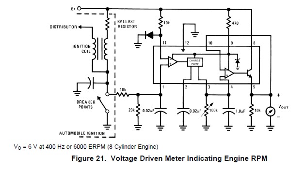

Hi folks, hope someone can help me. The rev counter on my 1973 Daimler V12 has given up the ghost and the chip (I'm assuming that is the fault) is unidentifiable - the numbers on it are MIC 7303 (Smiths instrument). Does anyone know anything about this?
I have now decided to try to make my own. First I tried using a 555 monostable but the signal from the coil is too erratic and I found it difficult getting the needle steady. Now I'm trying with a LM2917 using the circuit below (taken from Texas Instruments data sheet) but it breaks down above 540Hz - on a V12 that's 5400RPM. Although the car rarely gets driven at those speeds I would like it to work reliably up to minimum 7000RPM (fsd). Is that the frequency limit for the LM2917?
I have tried playing around with some of the resistor values but they don't have much effect. I am still testing it on a breadboard using a square wave oscillator - still have to try it on the car with the coil signal. The ignition is electronic but the tach signal behaves like a points system with 60 or 80V spikes.

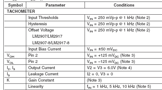

The LM2917 is spec'd well about 540 Hz.
Are you sure you have the right RC values? Can you use your pick-up on just one cylinder?

Reply to Mike: that's the version I tried but the coil signal was too wild. The monostable time had to be very short to allow frequency to increase to 700+ Hz without the output on-time overlapping. Then, at low RPM the coil oscillations caused double triggers of the monostable. Don't know if this may have affected it but I didn't have a 5v zener so I used a 1N4001 on the supply voltage to avoid over-voltage spikes. I was also running it directly from the 12v ignition instead of 9v - I used a 15v P6KE supprssor - but if it worked I would have probably used a 9v regulator such as a 78L09. I even tried setting up a Schmitt trigger on the input so it only caught the first big spike but again the needle wasn't steady so I gave up after that. Ironically, the opinion on that thread was that the LM2917 was better!
Reply to John: I hadn't seen that spec but you're right, it should work well above the frequency I need. I have to admit I'm a bit of a beginner at this so can you suggest some suitable RC values - and which ones? Is it the ones connected to pins 2 & 3? And I really want to use the original pick-up without adding extra wiring to the car. As you probably know 0.02uf does not exist so I used 0.022uf instead. Also, instead of a 470 resistor I used two 1k in parallel. Could this have affected the performance so much?
Your posted schematic doesn't show decoupling capacitors. Those are typically used between the power pin and ground to remove noise from the supply voltage. Depending on how much noise and how sensitive the chip is, you may see just one (e.g., 0.1 uF) or a decade series (e.g., 1.0 uF, 0.1 uF, 0.01 uF). They are important for the 555 too and are sometimes not included in "typical" designs because "everyone" knows to include them.

In the schematic you posted, the diode and resistor (10 k) on Pin 11 effectively set the threshold of the comparator at 0.7 V. A voltage divider there could work. You could also add 1 or 2 additional diodes to get a greater drop or just use a zener diode at whatever voltage you want. I might try three diodes in series first to see if that is the problem as you probably have some laying around. The problem with a voltage divider is that when the source voltage drops, so will the output of the divider. Of course, that may not be a problem if everything is proportional.
The datasheet makes a point that neither input should go negative with respect to ground:
It is very important that an input not go below ground without some resistance in its lead to limit the current that will then flow in the epi-substrate diode.
That can be done with a Schottky diode with its + side (anode) connected to ground. and its negative-end to the pin. Thus, if the input to the pin goes more than about 0.3 V below ground, the Schottky diode will conduct and clamp the voltage from going more negative. That safety may not be necessary and is not shown in the circuit you are following because of the high resistance (10 k) in series.

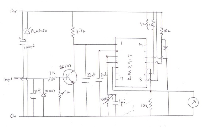

Well I finally got it working - thanks to both Mike and John. Firstly I tried picking up a signal from various points from the original board but none of them seemed to work, so I set up a switching transistor similar to the one that Mike suggested and the output signal from that on the oscilloscope was quite clean, so I fed it to the LM2917 and to my surprise it worked! I've attached my final circuit diagram below for reference. Any comments/improvements would be welcome.
Incidentally, I tried using a 78L08 regulator but, remember the problem with the output dropping off over 540 Hz? - I managed to get it up to 750 Hz by removing the 10k and 20k resistors on the input to pin 1 - but with the voltage regulated to 8v, the limit was back down to around 600 Hz. Could someone look at my circuit and maybe find the fault that would cause this?
At the moment I've set it up temporarily in the car on the bread board to see how it goes. If all goes well I will make up a board the same shape and size as the original with the VR in the right place to be accessible through the hole in the casing as it was designed.

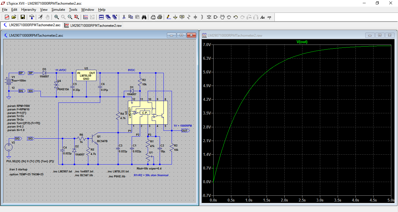

Hi
I think the internal zener regulator of the LM2917 is causing issues.
Try this version that doesn't use the internal regulator. The output is set to 1V=100Hz
but can be changed to whatever you need.
See attached.

Thanks, I'll try that when I order some more parts from my supplier - unfortunately I don't have any electronics shops close by so I have to mail order - but I have to admit I don't understand how the zener could affect the output in that manner. You must have gone into a lot of trouble duplicating my circuit exactly but I note you've omitted the 470Ω resistor on pin 9 - is there a reason for this or is it a mistake? Also, the 1μ cap on pins 3 + 4 has become 18μ.
I like the idea of a separate (47kΩ) resistor in series with the variable pot to avoid sending the meter off the scale presumably.

The 470 ohm dropping resistor is only required if you use the internal zener regulator. It helps the zener maintain regulation (regulation is about 7.5v).
The capacitor affects the amount of ripple voltage and response time. The ripple should be about 70mv using the 18uF cap.
The response time is the amount of time a new voltage reading takes to stabilize. If the response isn't satisfactory, you can lower this value but the ripple voltage will increase. The choice of value for this cap is a compromise between response time, ripple voltage, and linearity.
The pot is needed to calibrate the output voltage. Nominal is about 50k, so if the 10k pot is centered is should be close to the correct setting for 7v output.
BTW- I didn't know the required output voltage and just chose 1v per 100hz but it can be whatever you need.
Also....the datasheet has some good information on design requirements.

Thanks eT, I understand it a little better now. I have a LM78L08 - would that be suitable? And will I still need the P6KE15A supprssor or does the LM78 take care of that?
And I don't know the voltage required is either - I just adjusted the pot till I got an accutate (as close as possible across the range) reading, checked against the scope.

The LM78 doesn't have input protection, so I would keep the TVS diode, it protects against transients. I also added a 1N4007 diode at the supply input to help prevent reverse currents from entering the circuit. Regarding LM78L08, we need to know the circuits output voltage requirements before we can decide if its usable.
Do you have any info on the type of tachometer gauge your using? Voltage range, etc? The choice of frequency components is dependent on the supply voltage and full scale output voltage. We really can't proceed unless we have that info.

BTW-I've updated the circuit in post #13 to include the TVS and input diode.
