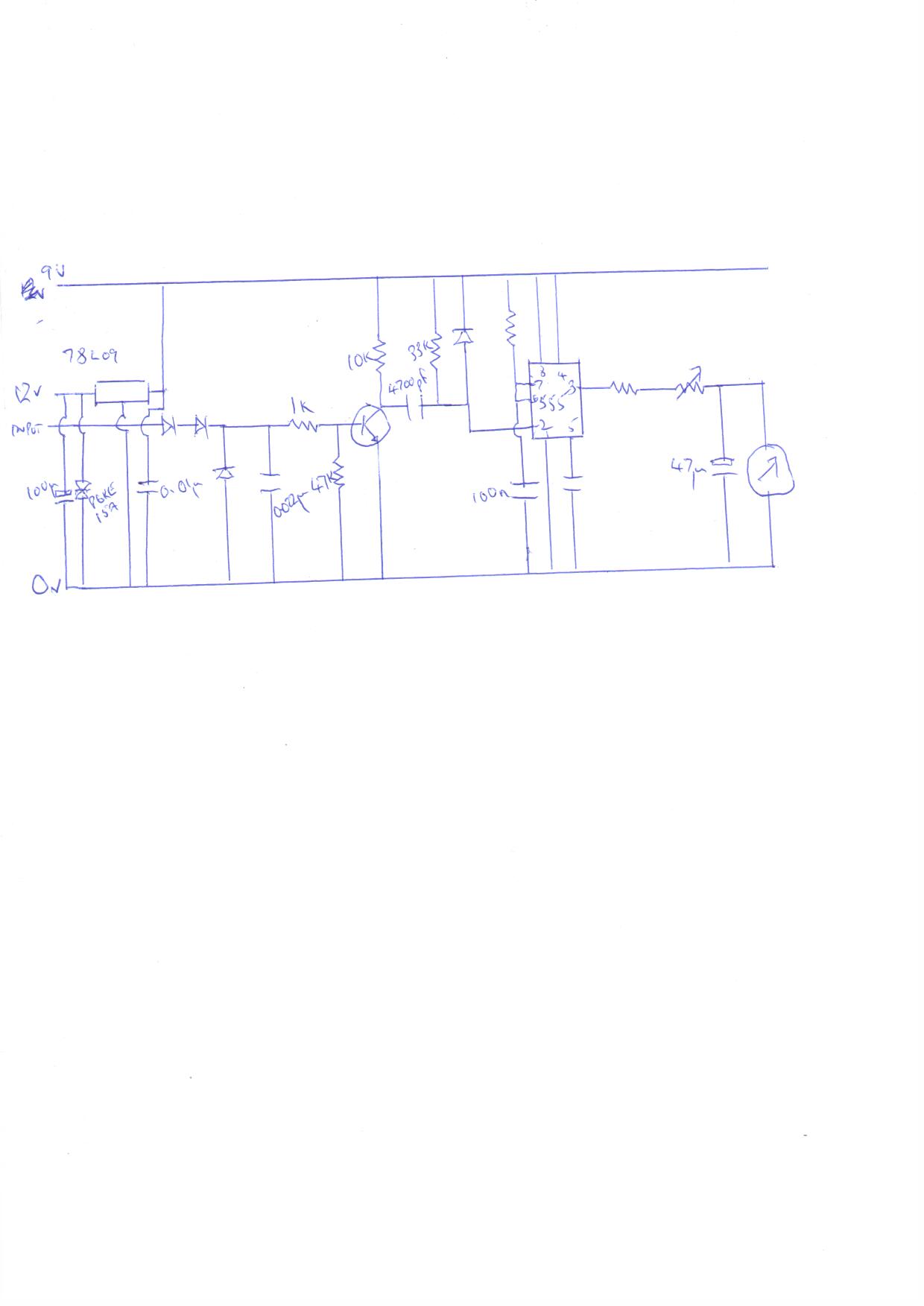

Sorry chaps, I said "the LM2917 is wired as a voltage driven device" - what I was trying to say is that I've configured my circuit as a voltage driven one - see the circuit I attached to thread #12.

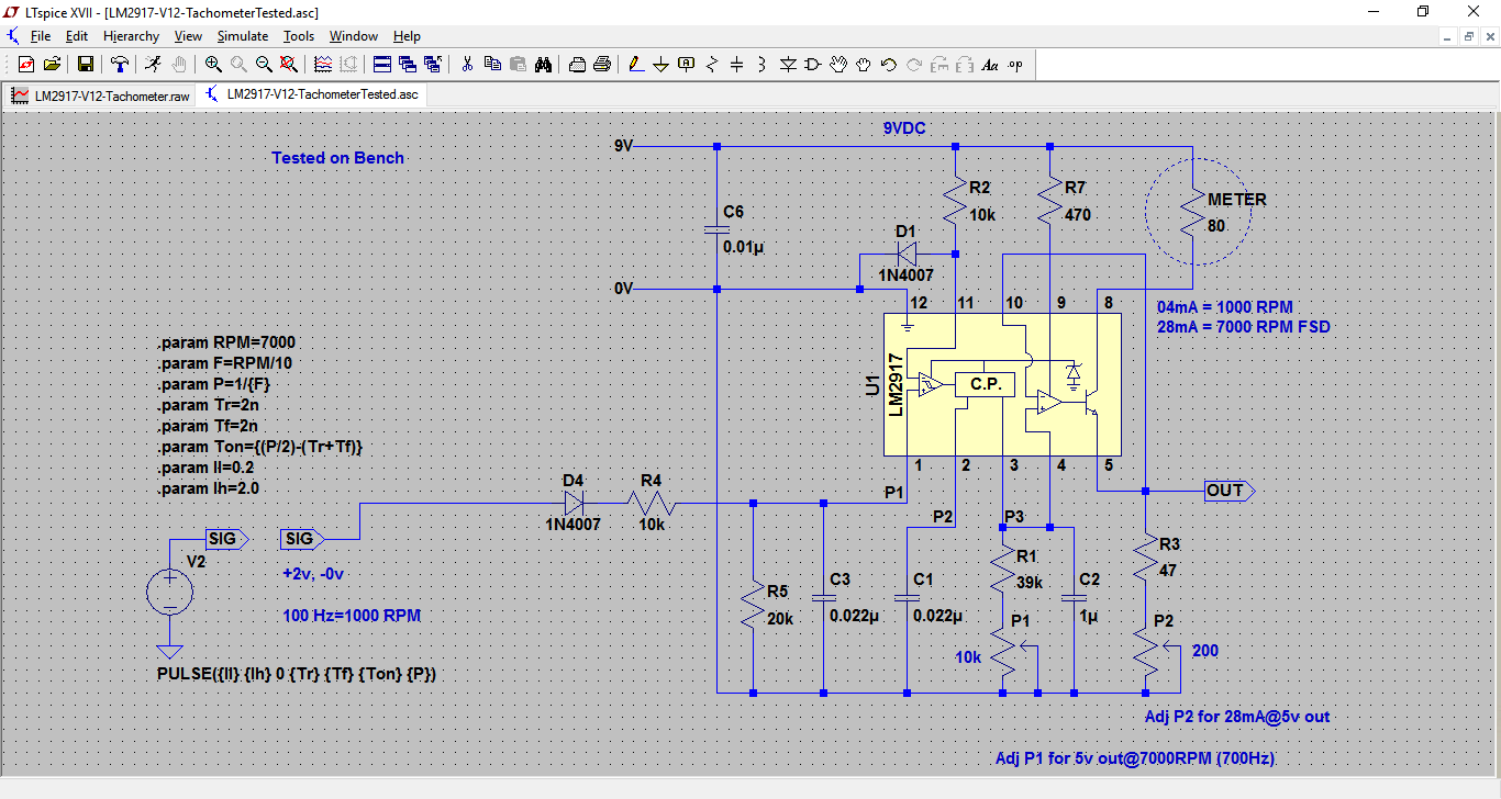

The LM2917 should work fine this application.
However, the circuit we should be using is the "Current Meter Driven" version shown in Figure 22 on the TI datasheet.
I have a similar circuit on the bench and it works like you want (I'm using an 80 ohm resistor for the meter). I will post the circuit later today.

Yes, the 555 circuit appears to be working, schematic attached. Unfortunately I didn't save the scope images showing the issues I had that I talked about on post #29. I've still got both circuits on my breadboard that is in the car running the tach - I'll try swapping from one to the other when I use it (which is not very often) before I decide which one to go for. I actually have two tachos, neither working so I may put one circuit in each.

Here's the circuit that I tested on the bench. It uses the LM2917. I swept the input from 100-700 Hz and the meter output current tracked the input frequency nicely.
4mA = 100 Hz, full scale = 28mA at 700 Hz. I also change the input signal from +2v, -0v to +2v, -0.2v to see if it affected the input but it still worked.

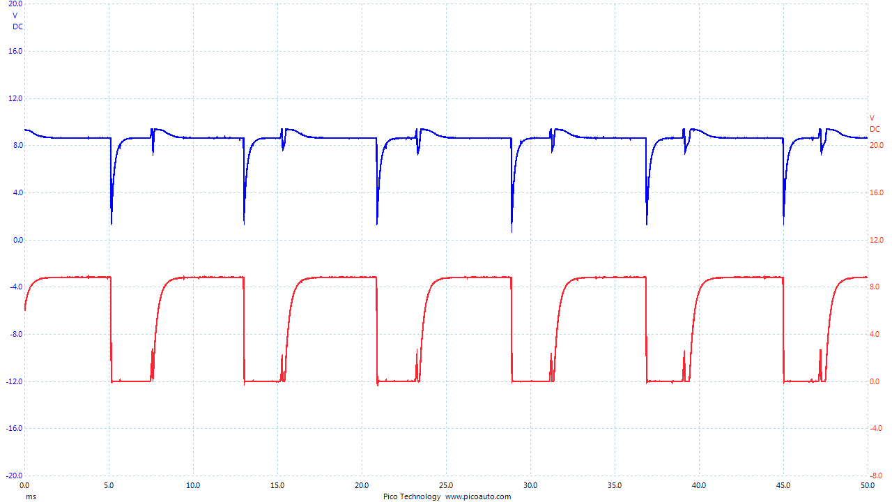

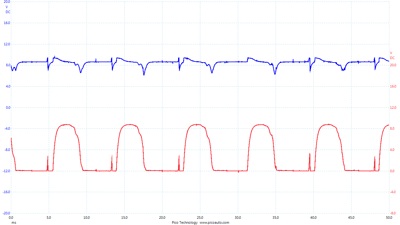

However, I've taken some scope images of the signals at the pin 2 input of the 555, and the collector output on the BC547 to show the effect of adding the two diodes in the inout line (refer to my schematic on post #32). Blue is the 555 pin 2 input and red is the BC547 collector. The image without the diodes shows how slow the transistor is switching off, and consequently that affects the edge trigger output into the 555 which does not work until the RPM increases to over 2500. The other image with the diodes (I needed two to make the switching sharp enough to work at idle RPM) shows the transistor switching off sharply and the curcuit then works fine at all RPM. I don't understand why the diodes have that effect - I discoverd this purely by accident when I was trying to do something else.
Interesting images.
The transistor is acting like a switch and functions as a level shifter. It switches the 9v supply at the same frequency as the input signal to provide a "conditioned" signal to the 555. Although its not apparent from the images, I think maybe the diodes, in addition to dropping the input signal about 1.2v, are blocking any reverse voltage from entering the input circuit. It would be nice to get an image of the input signal before and after the diodes.

Here is the image of the input signal before and after diodes you asked for. The first one shows both traces taken simultaneously but did not look right to me, so I then took them one at a time. Blue is before diodes and red after diodes.

0002 was the first I took with both before and after diodes - but I think the red may not have been connected properly - I didn't think it looked right, so then I took them both individually. 0004 is the signal after diodes (red) - blue was not connected. 0006 (blue) is the signal before diodes - red was not connected.

So the engine is idling at about 500 RPM right?
Does the input signal (before diodes) decrease significantly at higher RPM's?
I'm wondering if the images 0004 and 0006 are reversed? Blue is after diodes and Red is before diodes?
