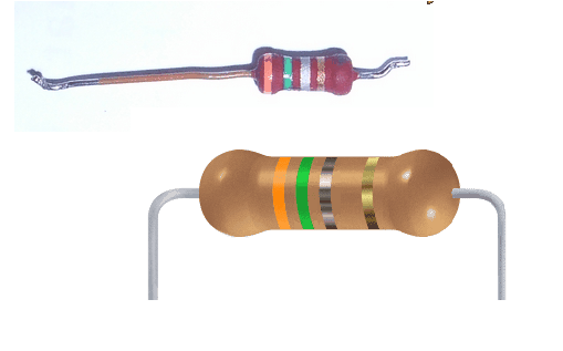

I have a resistor which I can't positively identify the colours on. They are: Orange; Green; and then possibly blue but not sure about this one. It's board number is R109 and it is tied in with the voltage regulator on the hot side of the power supply. Can anyone give me an idea of the value?

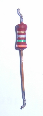

Photo of the culprit
Have (hopefully) attached a pic - hope it is clear enough.
Alf

hi Alf,
I dont think thats a Blue.!??
It looks silver to me.. = 0.35R +/- 5%
Look at the image.

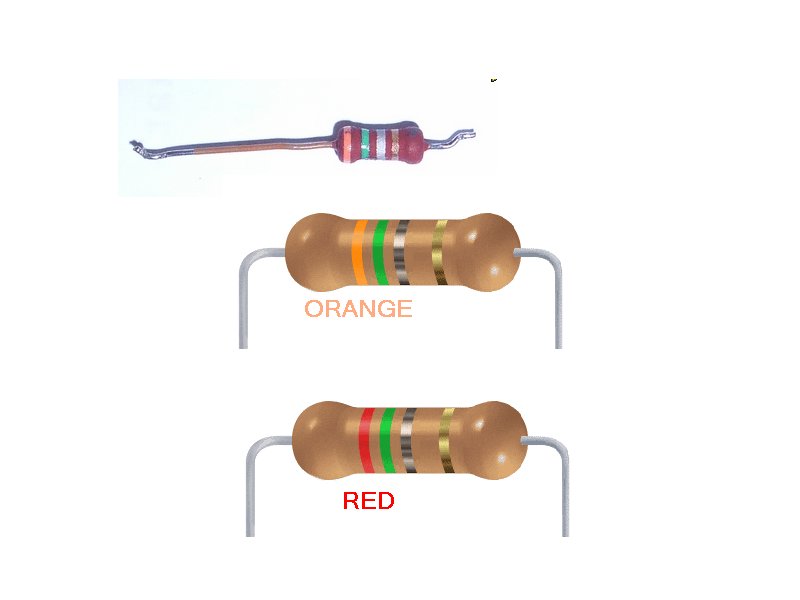

Compare the two in this clip.:)
I dunno, first stripe looks kinda red to me. :)
Another image.:p

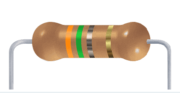

Hi Alf,
I are you getting this info.?

Ok, through my investigative research and the power of photo shop I have revealed the true color of resistor in question. Colors are in order of Eg's last pic.
It's pink... lol
Ok probably orange :)

As the resistor is on the psu section, its most likely a current sense resistor.
Alf says its open circuit, this would cause the psu to shut down.
Carefully relooking, thats a SILVER multiplier, its a 0.35R for sure.
