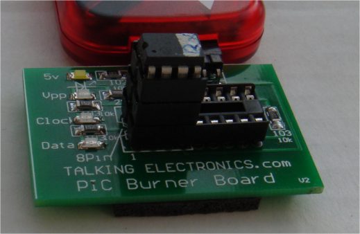

You just need this with PICkit2:
That is only an ICSP programmer. It does not provide debugging, correct?
Not even that, it's simply a board that provides a socket in order to program a PIC, you then take it out of the socket and fit it in your target board.
Useful device though, I built my own on a small bit of veroboard and fitted an 18 pin ZIF socket on it, it simply plugs in the PICKit 2 0r 3.

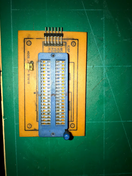

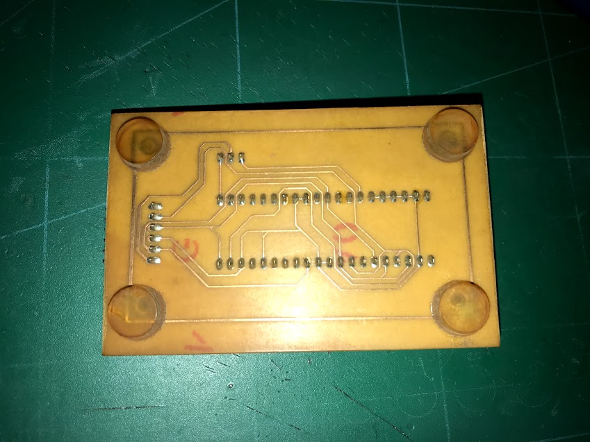

Did a similar thing with some phenolic PCB and toner transfer/FeCl etching and a 40-pin ZIF.
Yellow header jumper selects between 40/28 pin DIP's and 8/14/18 pin DIPs.
8/14/18 pin devices sit in the ZIF with pin 1 at the black Sharpie line.

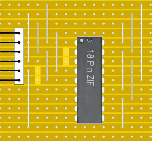

Here's my veroboard version using an 18 pin ZIF. As well as the four track cuts you can see, there are the usual nine others underneath the socket.
I built it because I was making a fair number of boards for a customer, with no ICSP on board, so popped the chips in the ZIF and programmed them before fitting.

My veroboard layout is wired for some smaller devices as well, but I can't remember whereabouts you have to insert them :D
As I only ever used it for 18 pin devices, and I happened to have an 18 pin ZIF, I never paid any attention to smaller devices - other than adding the capability when I made the board.
