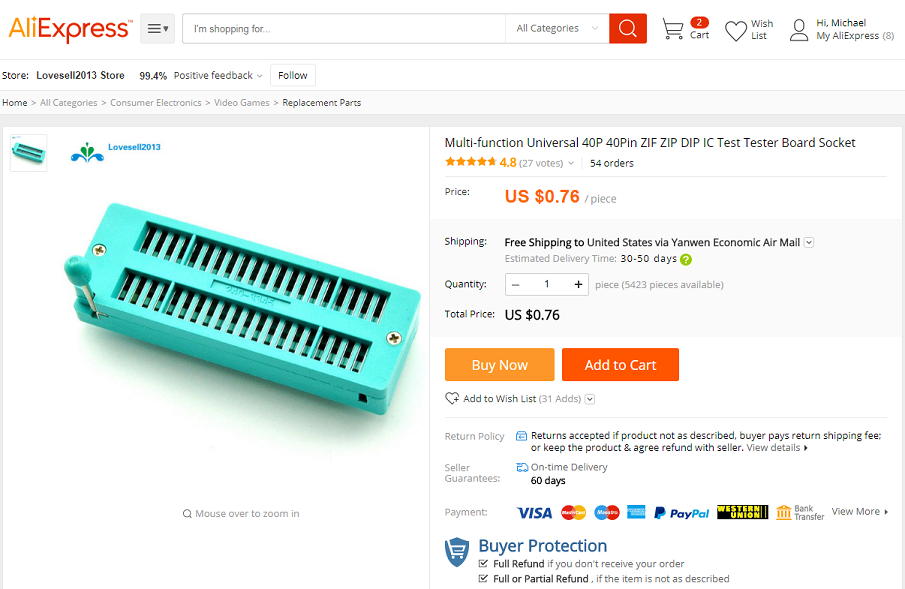

I purchased some of these 40-pin ZIF sockets awhile back. Perhaps it's time to build a new adapter that will plug directly into my PICKIT3.

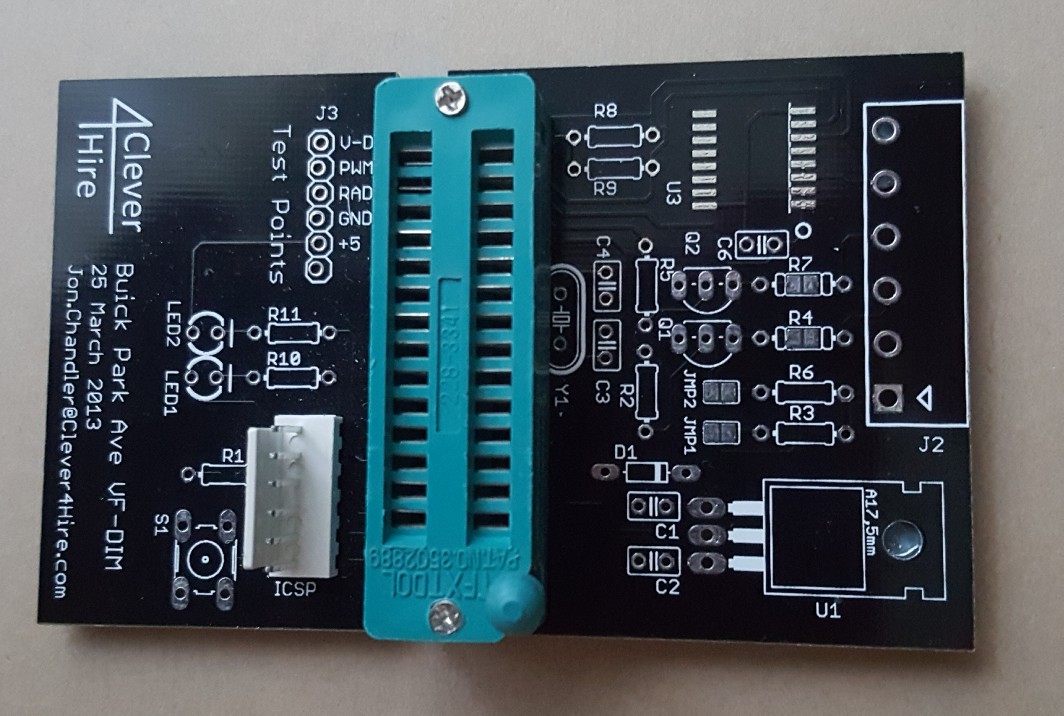

I'm kind of lazy myself ;) I needed to reprogram a bunch of 28 pin parts. I used a board laid out for a 28 pin part, added a 28 pin ZIF and a 6 oin header and I was business.
The only difficulty was the ZIF socket had oversize wide flat pins. It took a little effort to get the socket into the board. Look for ZIF sockets with small round pins to make this easier.
This happened to be a board that turned out to be a bust for the intended application, so it was a double win.
Yeah, being able to use an existing high-quality board is definitely a win, Jon.
The Aries series ZIF sockets have very nice small round pins that actually will fit quite nicely in a machined pin socket, if needed... they're just a bit expensive. If you have an inexpensive alternative with smaller pins, please let us know? Thanks...
