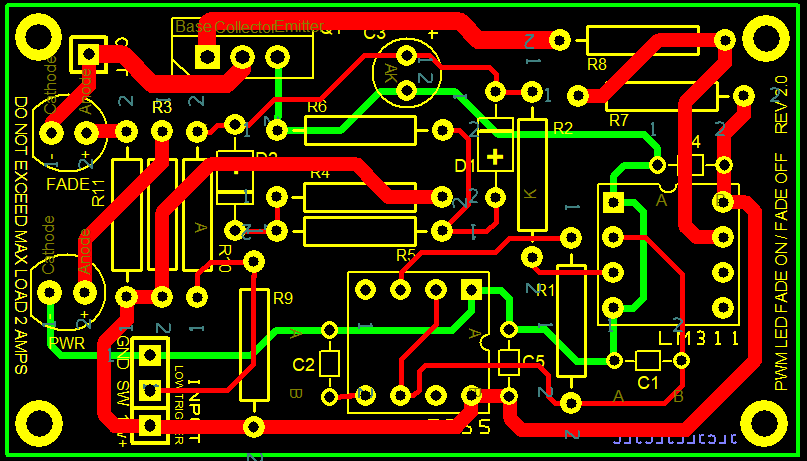

LED Strip lights (2 Amps) Short Fade on / Fade Off effect
The basic PWM action works by comparing the control voltage on C3 to the charge / discharge [approximate] sawtooth on the 555 timing cap, using an LM311 (same pinout, different part number) to control the output transistor.

Plus the PCB tracks need to be wide enough to handle the current; I can't remember how they ended up.
the positive rail is 40. Ground pour on top and bottom layers

ps. Your 40 thou tracks are OK for roughly 2.5A in 1 Oz copper.
For 5A, it needs to be 2 Oz; that would give a track temperature around 18'C above ambient.

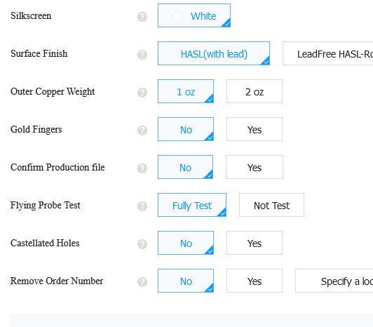

This is great news! I was wondering how to figure track thickness. Ya know i noticed at JCLPCB they offer a 2oz copper option. would selecting that option satisfy the track thickness?

So the darlington can handle no more than 2 amps. Which is fine. Like i said all but two lights draw more than that. So it would be safe to select the 2oz copper option for all the boards and just get 2-3 STP80NF55 Mosfets and make the resistor and cap changes for those boards (C1,R1,R7&R8)
