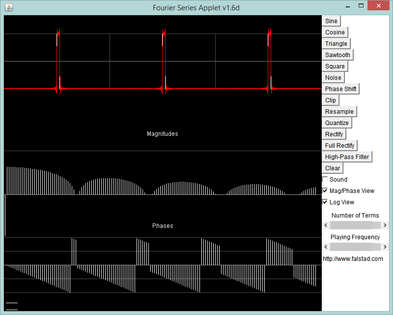

The ideal pulse is spread spectrum with harmonics of the repetition rate with a null spectrum = 1/PW50 of pulse width then harmonics of all previous spread spectrum spikes. THen hoping that this covers the resonance of the lead-sulphate crystals. A network analyzer scaled from 50 Ohms to 50 mOHms might display the spectrum of the crystal resonance frequencies among all the lower physical plate resonances and cable resonance up to 50MHz.
Below , the f "Magnitude" humps show the spread spectral harmonics of the pulse rep rate and the nulls correspond to PW50 and then harmonics beyond that. The number of spikes between Frep rate and f null is the ratio of PW50 and Tr rise time.

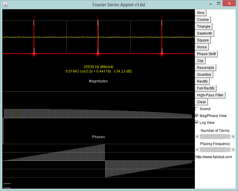

e.g. until you determine the desired resonant frequency, you are hammering all of them, then they attenuated in power -3dB power octave ( per harmonic) for 1st order, and twice for 2nd order etc.

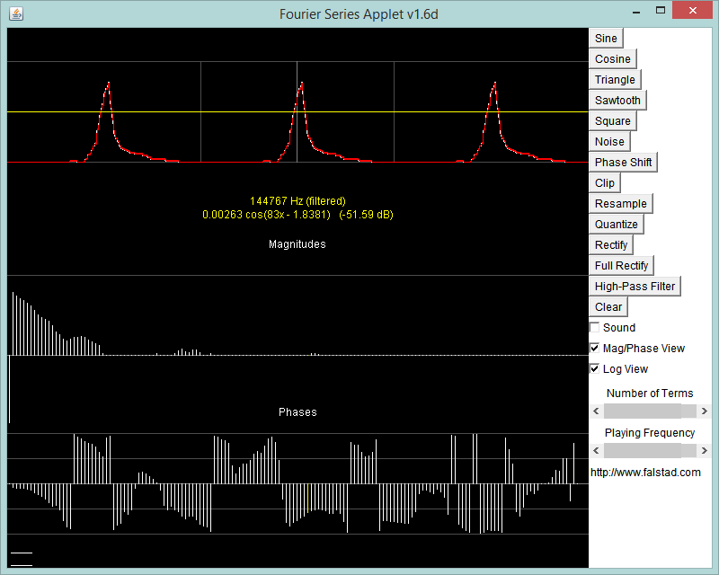

I forgot what your pulse looks like but with sharply integrated pulses ( LPF effect and skin effect) So the harmonics now say at 150Mhz are down ~51dB or 20 dB lower in this arbitrary pulse , so you need 20dB more power. (100x)

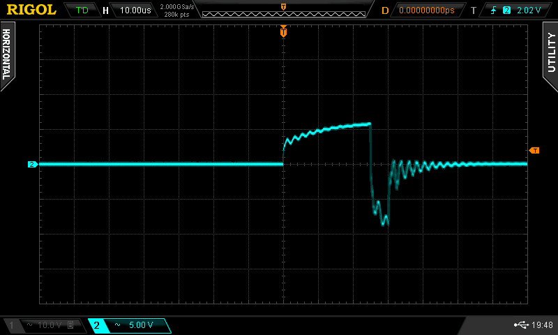

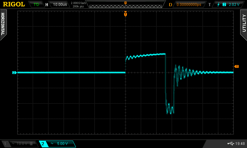

I just installed a new DS2032, 300Mhz scope and checked the rise time on the pulse amplitude....it's about 80 to 90 nS with a 5V amplitude.

A Snubber cap (500uF NP) across battery reduces input pulsewidth by abt 5% for the same avg current into the battery. I wonder why?
no cap:cap-out.png
If you take the Norton equivalent of your source, the output voltage is always a product of the load impedance and the source.
The pulse ESR ratio affects initial pulse height, RC slope to 100% and thus energy transferred before next transition. Pulse shape is also affected by SRF affects on Fourier and time domain effects.
