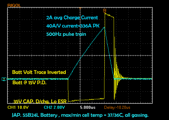

Well, it's been two years and I have done the science.
I have processed scores of batteries and developed a desulfation engine.
Approx. 30% of batteries left for dead can be recovered and placed back into original service. Not necessarily at full capacity...but with reasonable capacity.
I attach a 'scope trace of the process in action.
This battery a 55B24L japanese unit was flat at 3.75V and >2000 milli ohms resistance. Its cathode busbars were visibly coated with white crystalline sulfate deposits as well as chocolate crystalline on the anodes.
The process involves a relatively low pulse charge followed by ramping the current as the battery resistance decreased and temperature remained within tolerance across the cells.
This scope pic shows 8.4Amps average translated into a 500Hz pulse charge event of 640A measured by an ion physics current transformer custom built to spec. I have high hopes for this battery recovery as it will be ongoing for another day or so.

There have been many hurdles along the way. The current transformer alone cost $600USD, then many hours in simulations, coding, testing, detonating TVS diodes :eek:, destroyed MOSFETS & Mosfet drivers, melted current sense resistors, acid damaged clothes, back strain from toting batteries. :(
Here is another scope pic., the AH delivered is now 150% of rated and the battery is equalizing happily. Temperatures across all cells are 36/37C which is a good sign, also all cells gassing. Battery V is now 15v with the 2A avg (C/20) current charge.
Over the last 2 hours the avg Spec. grav. has moved up to 1200 ( about 17 points). Note that originally (yesterday) some cells were just water, no acid at all => 100% sulfation in those cells.

For the purposes of degrading hard sulfation, high voltages are required to overcome the insulating properties of the sulfate.
High voltages (up to 100V I have seen used) can cause severe overheating, thus the duty cycle of the hi voltage must be small. Enter pulse charging and thermal monitoring.
The constraints on the minimum pulsewidth have to do with battery and wiring inductances. You need enough width to overcome the time needed for the current ramp as seen in the scope traces. Then the frequency is decided by the average currents you want to achieve. A higher freq= higher avg currents and probably lower peak currents as the DC% gets smaller in absolute time as frequency increases.
Some commercial desulfators claim to operate directly on batteries attached to a vehicle. I have purchased and tested several common units. Invariably they use very small amplitude pulses and take weeks to months to make a difference in optimum conditions. I have found their claims to be of the flavoured snake oil variety with merely a hint of reality.
Automotive circuitry cannot permit too many transient pulses to live for long, in fact auto circuity includes transient protection to ISO standards. You can only pulse a battery effectively & safely out of circuit.
