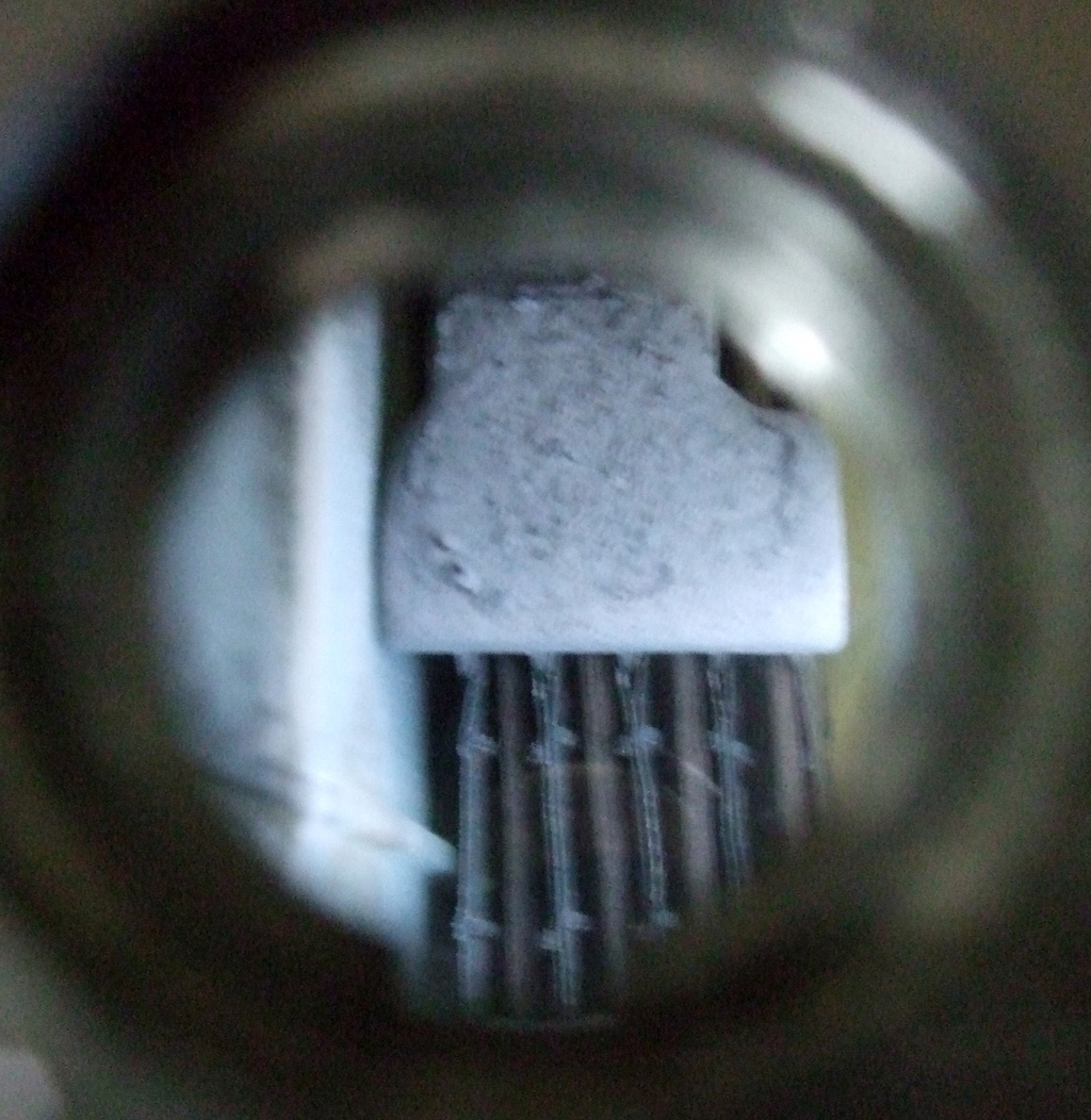

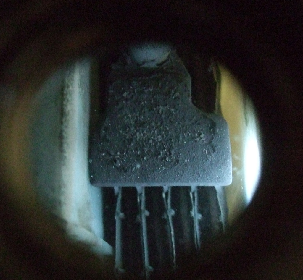

A little update...b4 & after pics of a -ve buss bar in the same battery cell.
1125 Spec. Gravity:
1265 Spec. Gravity:

You after photo is more in focus, and has more tangential lighting, biasing the effects.
Try to be more consistent with both deep top lighting ( endoscopic) and side lighting (lateral-scopic), use both methods .

So what are you showing here? Is this a picture where before treatment the plates have an oxide coating, then after treatment it is gone? That's what it looks like anyway, which seems good. How did you get that to happen though?
Also, do you know where the oxide went...ie back into the solution or drop to the bottom of the battery case?
Also, does specific gravity tell us anything relevant here, other than state of charge?
SG often reaches a terminal reading until corrected by pulse charging then it rises to normal levels.
Yes, I had too much focusing probs (thru the electrolyte meniscus) with non tangential lighting. It is a factor that weakens the science quality.
The difference in coloration is still apparent though. Using Photoshop to quantize the RGB elemental differences in the buss bar surface with the current lighting issues would be difficult, if not entirely invalidated.
I have ordered a passable USB microscope small enough (with macro lighting) to better control this photography.
Focus was good, just better :LED for lighting.
Those pics are pre/post the rejuvenation process. Pulse charging is the process.
It's not oxide (although it is a bidirectional reduction/oxidation (redux) reaction driven by electricity). Chemically it is a sulfate of lead which acts a surface insulator that inhibits access to the active lead material within the battery plates.
Lead sulphate formation is part of natural discharge cycle of a lead acid batt...thus the concentration of the H2SO4 electrolyte drops as sulphate (SO4) bonds to the lead plate surface while the battery 'discharges'.
Battery charging normally reverses that process and restores electrolyte concentration and plate morphology. However, delayed or incomplete recharging permits the recently formed, finely divided lead sulphate to aggregate into a crystalline sulphate which continues to 'grow' (like sugar crystals in chilled honey) forming islands at first with continued growth eventually shrinking the 'good' plate surface area thus shrinking the apparent battery capacity.
Reversing this crystalline sulphation is key to rejuvenation as is reversing other incipient problems such as Calcium oxide passivization and inter-plate dendrite growth.
The sulphate went back into the electrolyte as evidenced by the spec. gravity increase. Any sequestration/sedimentation of the sulphate will damage the battery capacity.
