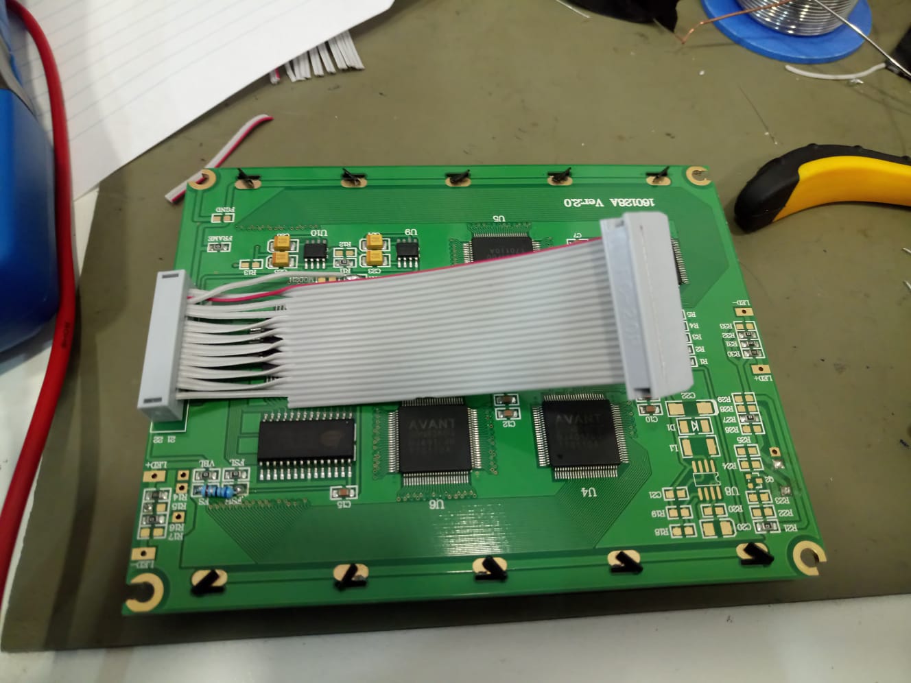

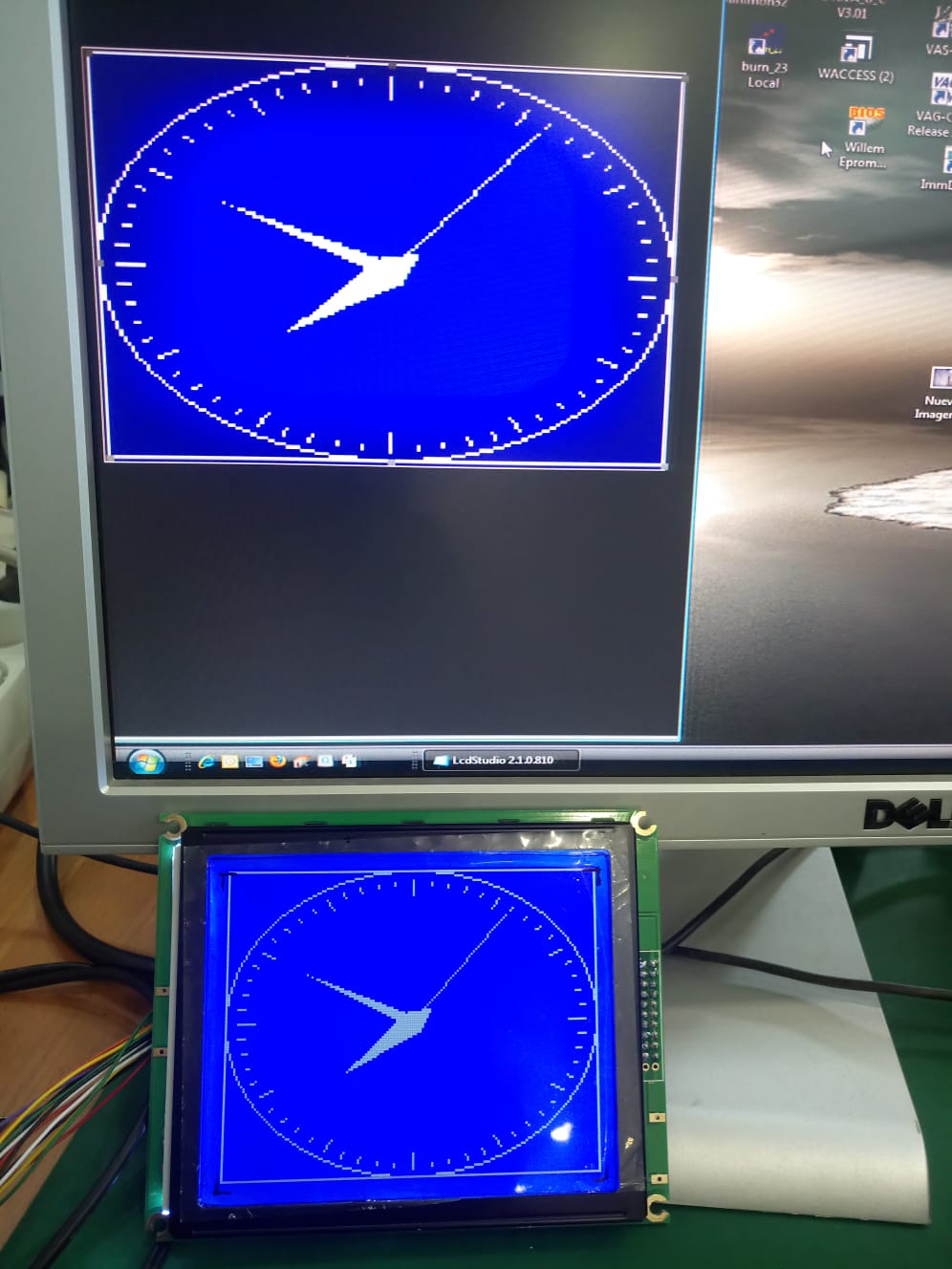

Hi guys,
we have been working with a LCD adaptation to an electronic unit which has obsolete original component. We bought 2 units and made them working properly. When we wanted to make more of them we received a different type of unit of LCD and now the new ones are not working. In theory they are fully compatible. Do you have any idea?
The LCD´s are 160x128 8080 parallel port based on chip T6963.

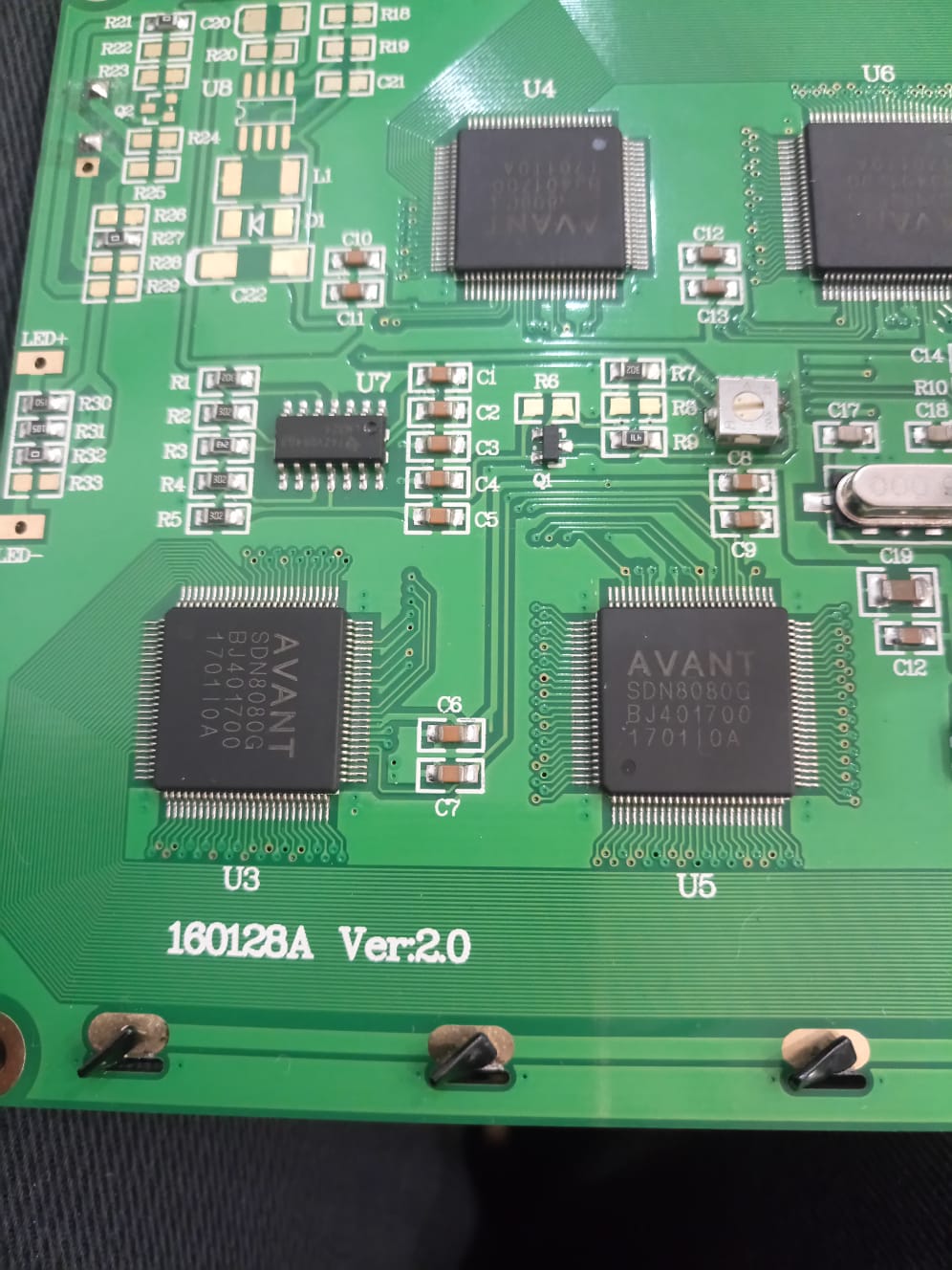

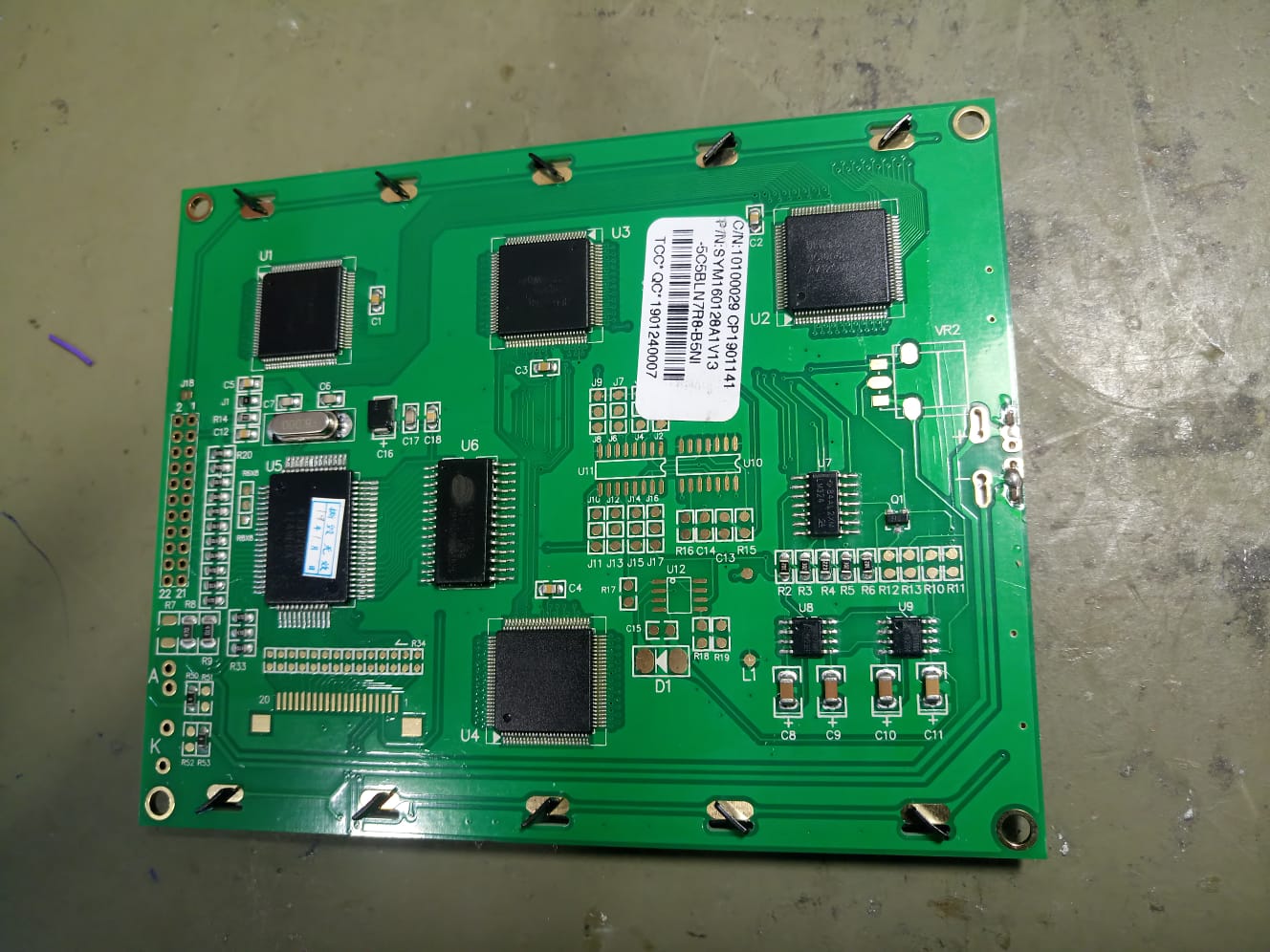

On the good ones the chip is RA6963 and on the not working ones we have the SAP1024B

From what I see the -15v isn't strong enough I used a separate -15 v convertor ( Now almost extinct!!) the MAX xxx ( can't remember the exact model ) Give a good strong negative voltage.... Some of these units make their own... What size resistor do you have on the -ve to Vo?
Actually... The "Good one" Has the -Ve on board.... The non working doesn't seem to have one..

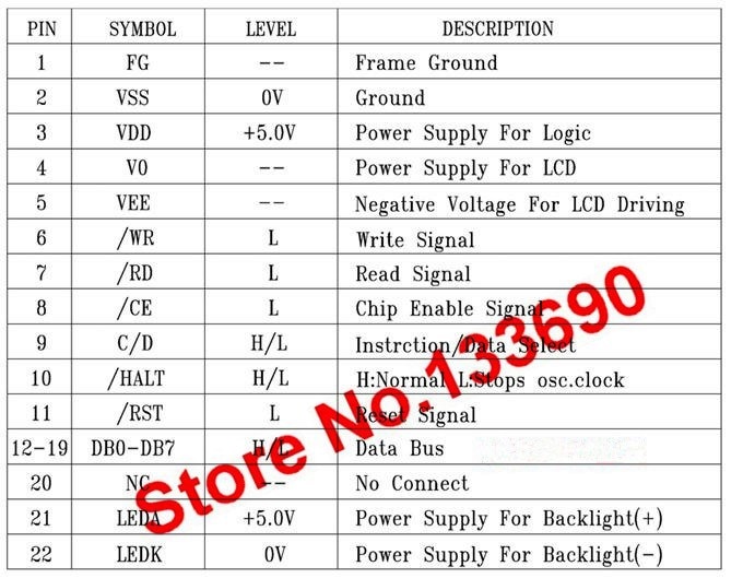

Thank you guys. Finally we received a datasheet from China and we saw the non working displays needed negative voltage on Vcc (pin 4). It is needed to install a potentiometer between pin 4, 5 and GND.
On the good one, first on, on pin Vcc (pin 4) uses +5V. We have tested it and that was the difference!!!
