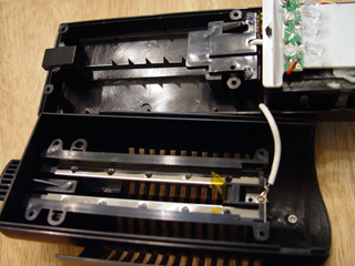

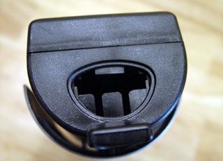

Small version

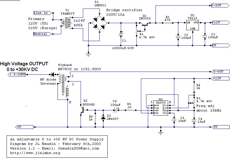

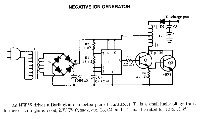

This one with variable output from 0 to 30KV should be more then enough to build large model but I think we don’t need such monster so schematic can be taken as sample to design something less powerful with lower voltage output.

Nice one ymmy.

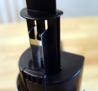

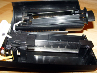

So they are using 'Points' of sorts, to achieve some sort of air-flow. What isn't apparent is how the plates are removed, or whatever, for cleaning? as it all looks a bit tight in there. I assume these must 'slide-out'? for user cleaning? It looks like there's more than on 'Pos' collector plate?
When I'm free of work here, I'll post some (theoretical) drawings of how we maybe able to achieve it.
We appear to be getting closer ;)
Steve

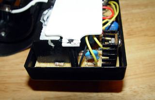

Yes, plates slide in and out for cleaning purpose. Microswitch used to remove power once plates lifted up.

One more taken from internet...

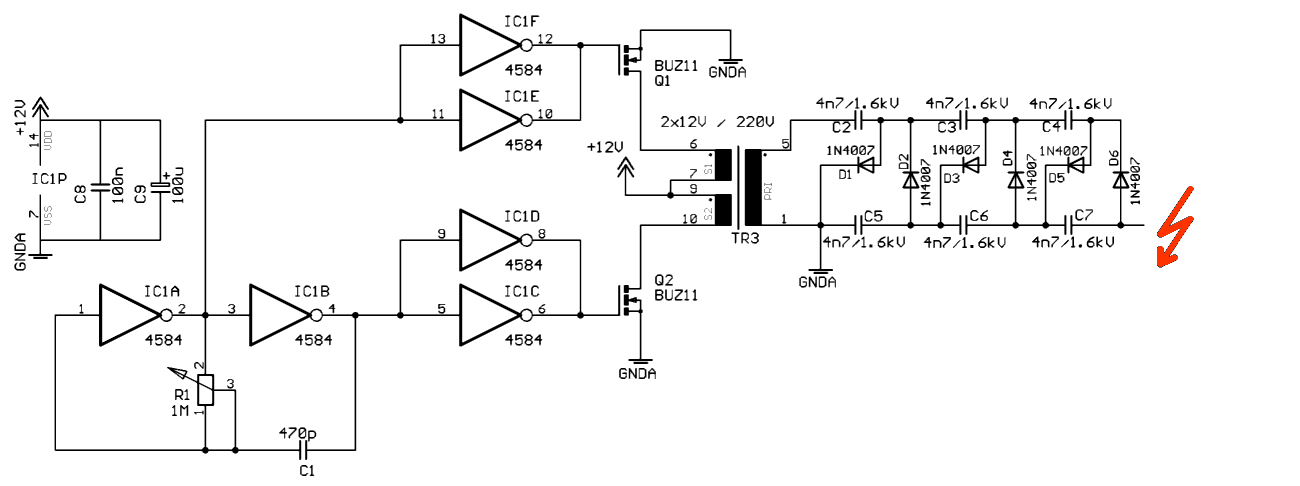

1. Function
The basic part of this project is a resonant low-voltage DC powered voltage converter. A standard mains transformer is used backwards, i.e. supplying an alternating current into the low-voltage secondary coils and transforming this voltage level up to a high-frequency AC voltage which is then rectified in a three stage cascade multiplier.
The transformer used in my prototype is a 240V/2x12V, 1.5VA type printed circuit board transformer. The middlepoint of the two secondary windings is connected to the low-side supply voltage of 12V, while the other ends of the secondary coils are alternating connected to ground by two power MOSFETs. The gate voltage for the MOSFETs is directly derived from each two parallely coupled CMOS inverters by thus using only one chip for the oscillator and driver circuitry. The frequency is derived from an RC oscillator build by two CMOS Schmitt trigger inverters, a timing capacitor and a trimmable resistor for frequency adjustment.
2. Construction
The circuit of the high-voltage air ionizer consists of 3 parts
1. RC oscillator and power driver
2. high-voltage cascade multiplier
3. ion generator
I'm going to describe each of the parts in more detail now.
The RC oscillator used here is quite simple and a very usable circuit. It uses two CMOS inverters with Schmitt trigger input characteristics (using "normal" inverters results in asymmetric square wave output with a duty cycle different from 50%). The oscillation frequency is determined by the RC time constant of the timing capacitor and resistor, using a variable resistor of up to 1MOhm and capacitors from 100pF up to several 10µF a wide range of freqeuncies can be covered. The output of the first and second inverter show a 180 degree phase shift and are fed into each two further inverters which are used as decoupling buffers driving the large gate capacity of the power MOSFETs (typically 1000pF). As the gate signals of the two power MOSFETs are in antiphase, always exactly one of them is in the conducting state driving current through one winding of the transformer.
The whole circuit shows a resonancy where the voltage on the high voltage side reaches a maximum. Using the given type of transformer and dimensions of the cascade, this frequency is approximately around 15kHz. As the MOSFETs are operated far below their critical values, no additional cooling is needed.
On the high-voltage side of the transfomer, a high voltage is induced. Looking at the oscillogram of the drain voltages of the power MOSFETs you'll see, that even there a voltage significantly higher than the 12V supply voltage occurs due to self induction and cross induction from the other driven winding. Providing a large transient dI/dt on the low voltage side, the AC high voltage is higher than the perhaps expected 220V from the windings of the transformer...
The six capacitors and diodes in the three stage cascade work as a charge pump. By turning all diodes around in their direction the output of the cascade would be a positive DC voltage instead of negative as in the presented design. By exchanging the switching diodes with faster ones, the efficiency could increase. This part of the circuit should be build up with good isolation otherwise creeping currents will consume most of the generated power. Avoid sharp points on the circuit board and soldering points as these would give rise to an increased electrical field and possible leakage. The open circuit voltage in my setup is somewhere around 4kV, but even when probing with a 50MOhm impedance high voltage probe, the measured voltage decreases to about 2kV. From this the impedance of the cascade can be estimated to 50MOhm and the maximum output current to below 80µA
3. ion generator
What to do with the high voltage generated by the cascade? By generating a high field e.g. at a sharp point or wire end, a sensable wind of ions can be generated emerging from this pin point. The high-voltage potential can be adjusted by driving the circuit at a frequency slightly below or above the resonancy. Driving it under resonancy might actually give a too high voltage for the use as negative ion generator which will result in the production of some amounts of ozone (it smells a bit like chlorine and should be avoided). You can find the actual resonant frequency by monitoring the DC current going into the circuit from the 12V power supply. It peaks at the resonancy with a value of about 40mA depending on the transformer used.
An effective ion generator can be build by spreading the single leads in a multilead wire into the air and connecting the other end to the top point of the cascade. In a distance of about 1cm a guard ring connected to the ground level can be installed. Powering on the circuit you should be able to feel a faint wind coming from this assembly and in the dark you might see small blue lights at the ends of the wires.

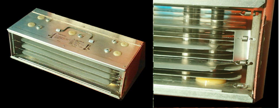

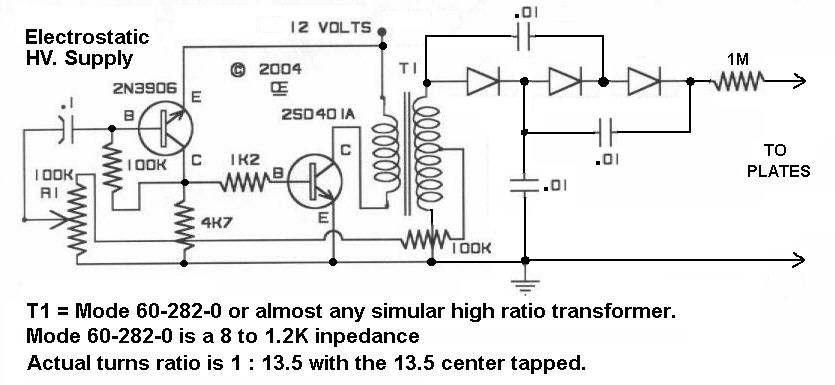

Below is a GOOD Electrostatic Filter and a supply circuit. For an effective filter, the plates must be at least 4 inches deep or the amount of dust it collects will not be very efficient. A supply of over 5000 volts WILL PRODUCE HARMFUL OZONE.

chemelec Wow, this is interesting one but I heard in order to achieve good ionic breeze the voltage should be around 10-15KV and now you talking about ozone problem...Where did you get schematic from?
Nice one chemelec :) The thin wires is a tidy way of arranging the negative electrodes, no machined spikes.
ymmy, 10-15KV may produce more 'breeze' but would punch out much Ozone, not healthy. All the info I've seen seems to suggest around 3KV to 4KV.
Steve
I Designed that circuit myself. It works very well.
That Pictured Filter I posted is out of a GOOD Commerical unit. And I have also built quite a few simular units.
There is some more info on this subject in the "Projects area" on my site at: **broken link removed**
Or I can answer questions if you e-mail me. You MUST put an Appropriate Subject line.
Take care..........Gary
Ymmy, If you want More Info on part values, E-mail me Direct.
1N4007 or 1N4008 or better yet, a High Voltage/High Frequency type.
Caps, .001 or .01 @ 1KV Minimum
1 meg, or even as low at 47 k rated at 1/2 watt, but MUST BE a "High Voltage Type Resistor. Most Standard Resistors are only rated at around 300 volts and will short out.

chemelec thanks!
Now i can't find any reference for 2S0401a transistor. Wonder if part # correct or no?
