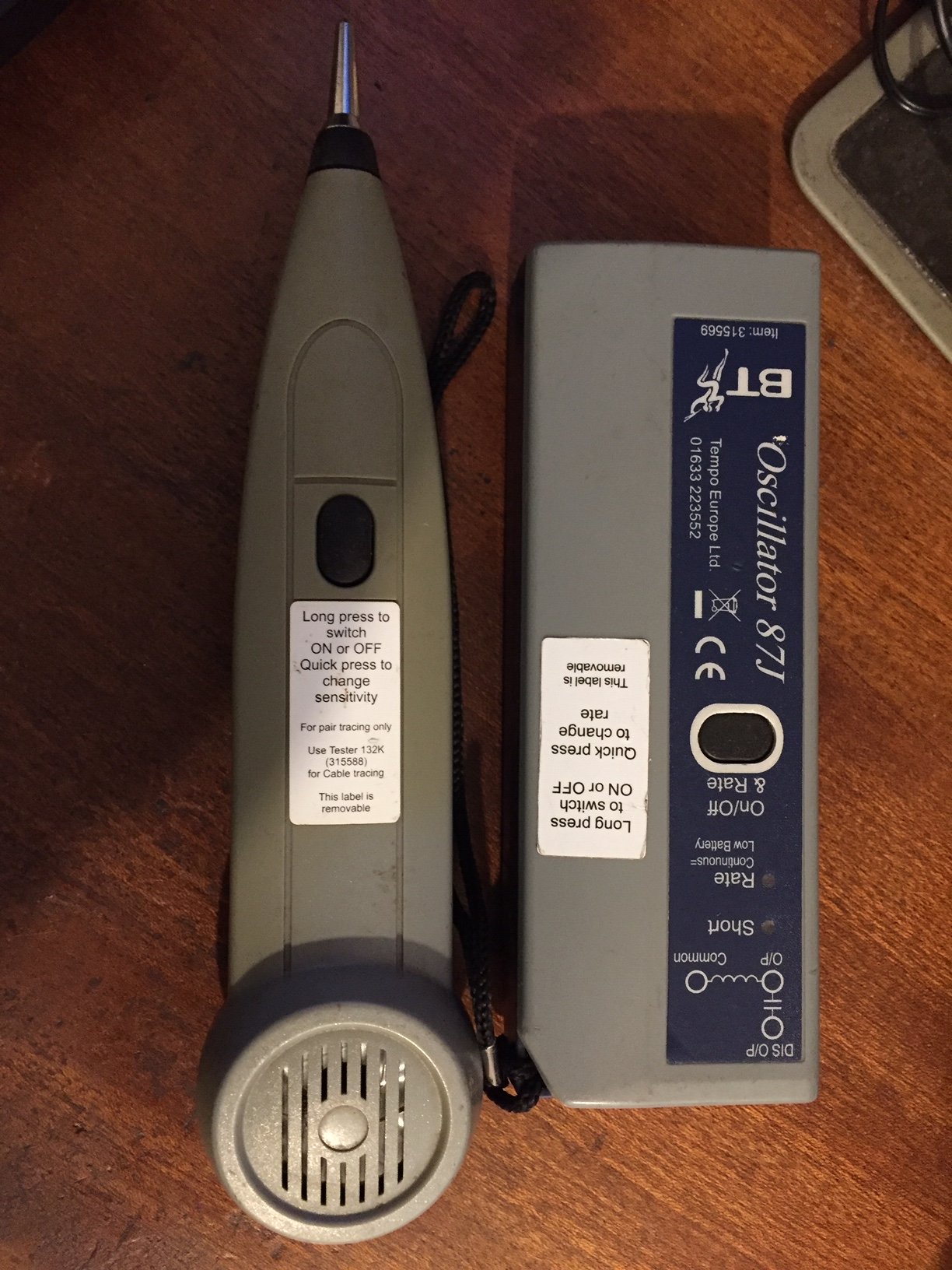

Based on the cable tracer idea, a British Telecom type unit would be fine, aka a "Knocker" - I use one of those and a pair tracer for locating wires in machine tools.
A Tempo 87 osc and 109 amp would work, or complete kit, Tempo 132.
The all in one amp probe is OK for moderate distances, the type that takes an external coil can be used to detect deep underground cables miles from the oscillator..
Full set, external probe type, new: **broken link removed**
But they do often appear very cheaply on ebay used. I picked up a spare set from a local secondhand shop a few weeks back, for a tenner as no one knew what they were...
