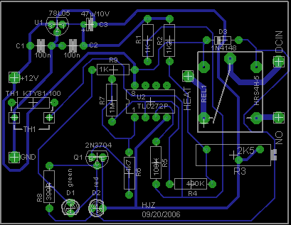

The file format boncuk used is Eagle software. I tried to convert the files to an image format for you. Let's see if this works.

did you not find the PCB layout in the file?
BTW this circuit was done for a forum member in Africa. Unfortunately he fell victim to rebels before he could finish the circuit.

I did see the PCB file in the zip, was not sure how to open that one as I have only used Eagle twice now.
Ok, I think I figured this out sorta kinda. I think this is the layout file courtesy of Boncuk. Hey Boncuk, if I did not post it correctly please explain to me what I should correct, or better yet please post the correct drawing as I am still a Eagle Noob :)

Hi kyrie2,
I have modified the PCB layout of the circuit and overall the size has shrunk a bit and the traces are wider.
If you unzip the attached file you should get three different files as a result. The schematic, the PCB and and a suggestion how to build the incubator box.
Use only as many heating elements (high current resistors) as necessary. Although the temperature will be controlled the air stream might be too hot and hitting the eggs directly they will fry instead being bred.

If you just use an image that doesn't help much to make a PCB. You will have to use Eagle for 1:1 scaled printed output of the copper side, which can be done using Eagle. (The complete PCB layout contains the silk screen (parts layer) If you print both of them on the PCB it will be full of short circuits.
You can download the free version of Eagle 5.0 at http://www.cadsoft.de.
The board size limitation is 80X80mm which is OK in that particular case. The board is much smaller than that.
I will import the files to version 4.16 and zip again. Files created using 4.16 can be imported by version 5.0.
