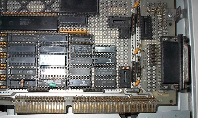

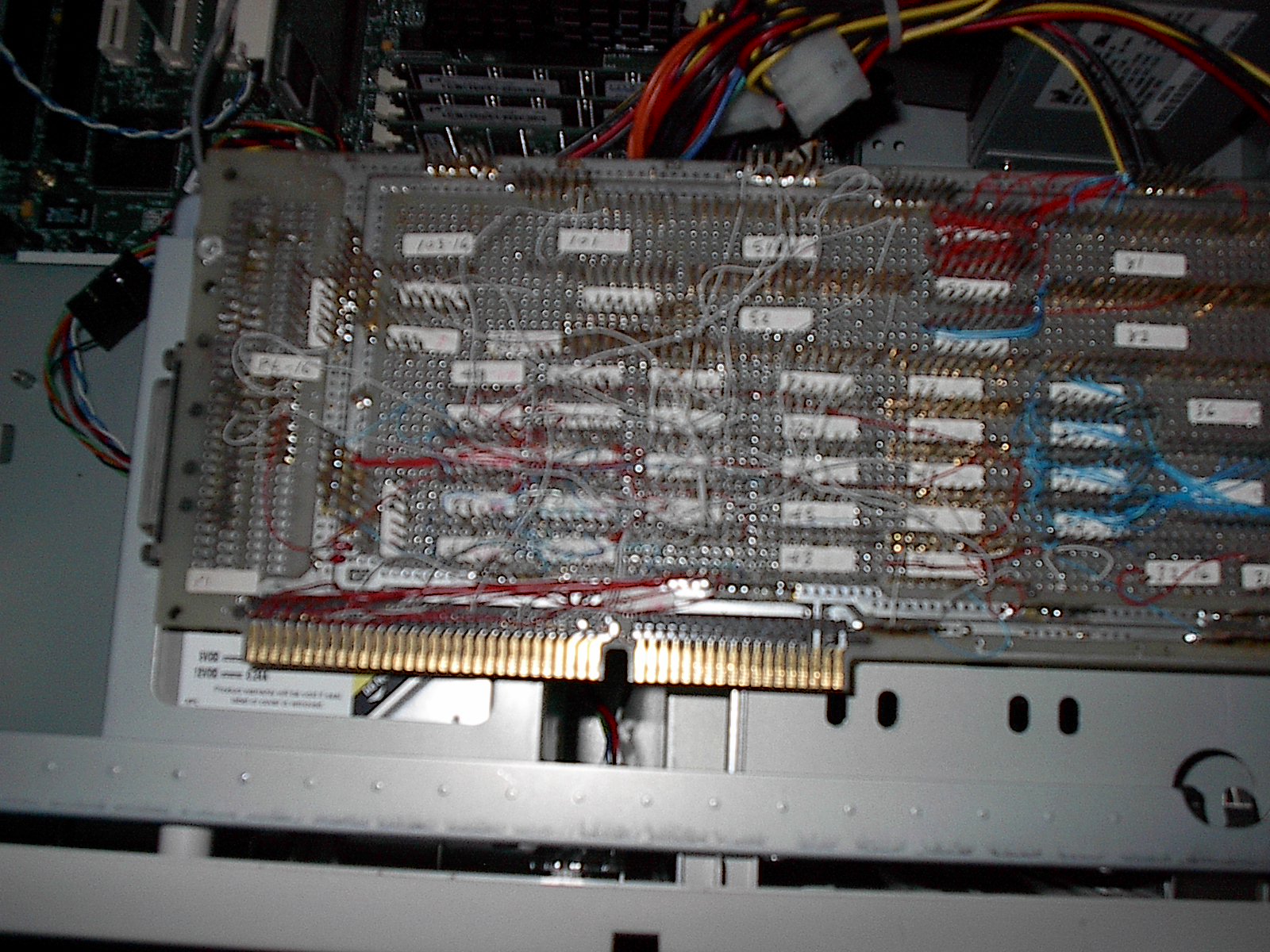

it ocurred to me that i never showed yall a pic of My PIC programmer

That has to be the most complicated PIC programmer ever built. You could probably replace all that logic with 1 pic chip. :D :D
Either you are pulling our collective legs or you have somthing other then a pic programmer on that board. There are over 20 chips on it. The schematic is much simpler. Maybe parts left over from a prior use of the board.

You're too recent a member to have seen the original thread, it's a PIC programmer built as a plug-in card for a PC - the masses of chips are the PC bus interfacing, presumably only a small section is the actual programmer?.
You see why we all considered it a silly idea!.
You are both right , if you look closely i am only using nine ICs , the rest are sockets , and i'm not using the Z80 PIO , in the upper left of the component side , it was left over from a previous project.
the programmer has a long cable 8 to 10 feet a nice feature ,the MCLR signal is driving the gate of a FET , located on my breadboard , i used to send the 12V signal down the cable , untill i realized that i just needed the FET at the other end. Much faster switching this way..

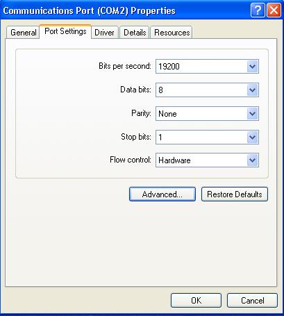

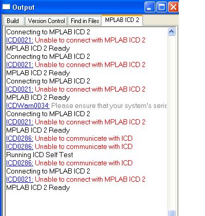

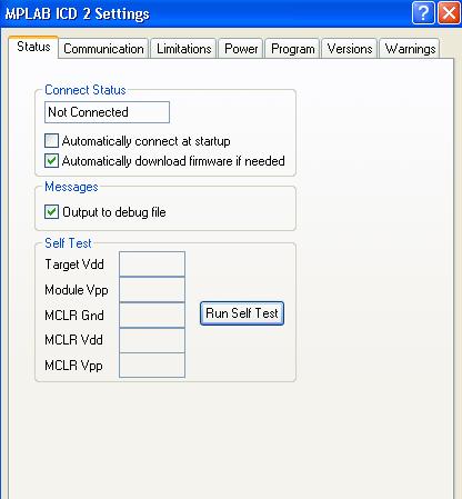

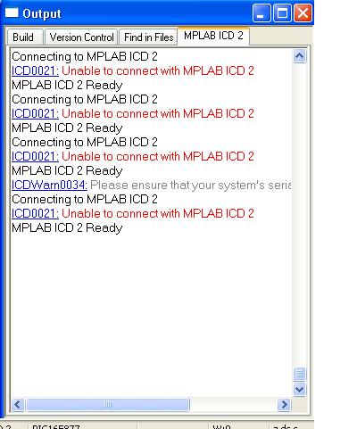

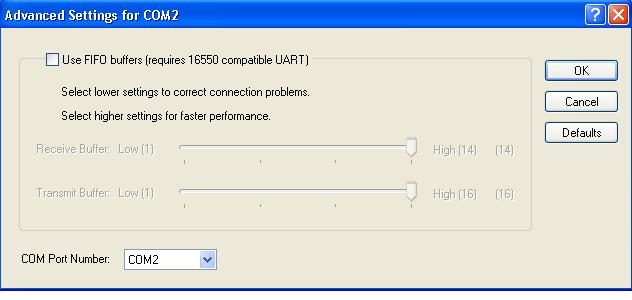

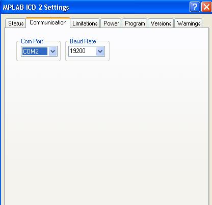

I am hoping Someone can spot something in these settings that is wrong..
i have not connected the target , SHOULD I ?
this has been the most frustrating project that i have ever tried to work on.

Baud rate can be either 19200 or 57600 either will work.
For this thing to connect it needs serial com through to the outputs of MAX232 and a working OSC and not a lot more.
Need to know what you did since your last post.
Have you verify that the crystal is working ? If you can not use the scope try a logic probe, test it on a working pic first if you got one.
Have you verified that the RS232 is working through to the TTL side of the MAX232?
Are you using the supplied 877 or did you program a replacement ?
This kit is not a hard build. It would be better if the instructions built and tested the RS232 prior to adding the processor and the rest.

Have you ever noticed the busy LED flashing?
You may have a com port problem, try com1 instead. Even better do you have another pc to test it with, a friends perhaps.
I've now built and tested oodles of inchworms. They were designed to be as simple as possible to get running. The tricky part is a decent serial port and a 1:1 straight through male-female rs232 cable.
It also needs power, some people don't hook up a wall wart to it and wonder why it doesn't work...
