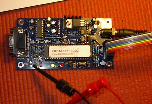

pins 13 & 14 show no oscillator action with the scope
i've attached a photo of the board
between pin 12 and pin 11 shows 5.08V

I am thinking you know and did all this but check again.
All the PIC16F877(A) needs to work is
  • the 4 power/gnd, (bypass caps on each pair)
  • a 20MHZ clock source (and caps if crystal)
  • a 10K resistor on pin 1 to pull the (active low) reset high.
pins 12 and 31 are ground
pins 11 and 32 are +5
IIRC the green led works so you can not have them backwards.
If that is all right and if you have the right caps for the osc then you should see the osc osc on the scope. (pins 13,14)
You checked for solder bridges? Esp near the crystal and its caps.
Now check both pins 13 & 14 with the scope.
At this point I would pull the processor and see if I could make it work on a solderless breadboard. But that is me and I do not know if you have a ceramic resonator or crystal with caps.
If it is still flatline you either have a bad chip or it is not programmed.

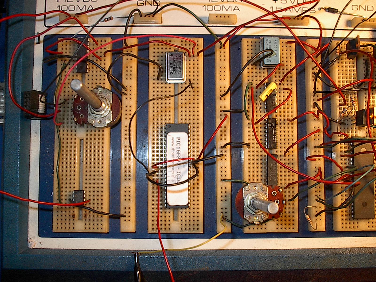

i'll take the 877 out and breadboard it , i have a ceramic resonator.
i had some space on the breadboard.
should it work with a resonator on pin 13 ? if it was programmed to use the crystal?
i dont remember
what i usually do is measure pin 14 on the scope ,with a resonator connected to pin 13, to see if it is running..

In that case not detecting oscillation isn't very conclusive, you could make a crude x10 probe (as you're not requiring accurate compensation) by simply adding a 9Meg resistor to the end of the probe.
Crystal failure (or the uP not oscillating for some other reason) is a common fault in lots of electronic equipment, one of the first tests is to scope the oscillator pins - but it is essential to use a x10 high impedance probe.
Assuming that breadboard layout is what you're measuring?, I find it difficult to even spot a resonator? - and certainly the long wires everywhere, and complete lack of supply decouplers, isn't going to help.
Yes you should add the caps.
You also need the 10K pullup on pin 1.
Do not get discouraged, this is good experiance for what you will be doing when you get the programmer working.
The only probe I have is a 10x. I missed that one.
Not sure about how you have the resonator hooked up.
