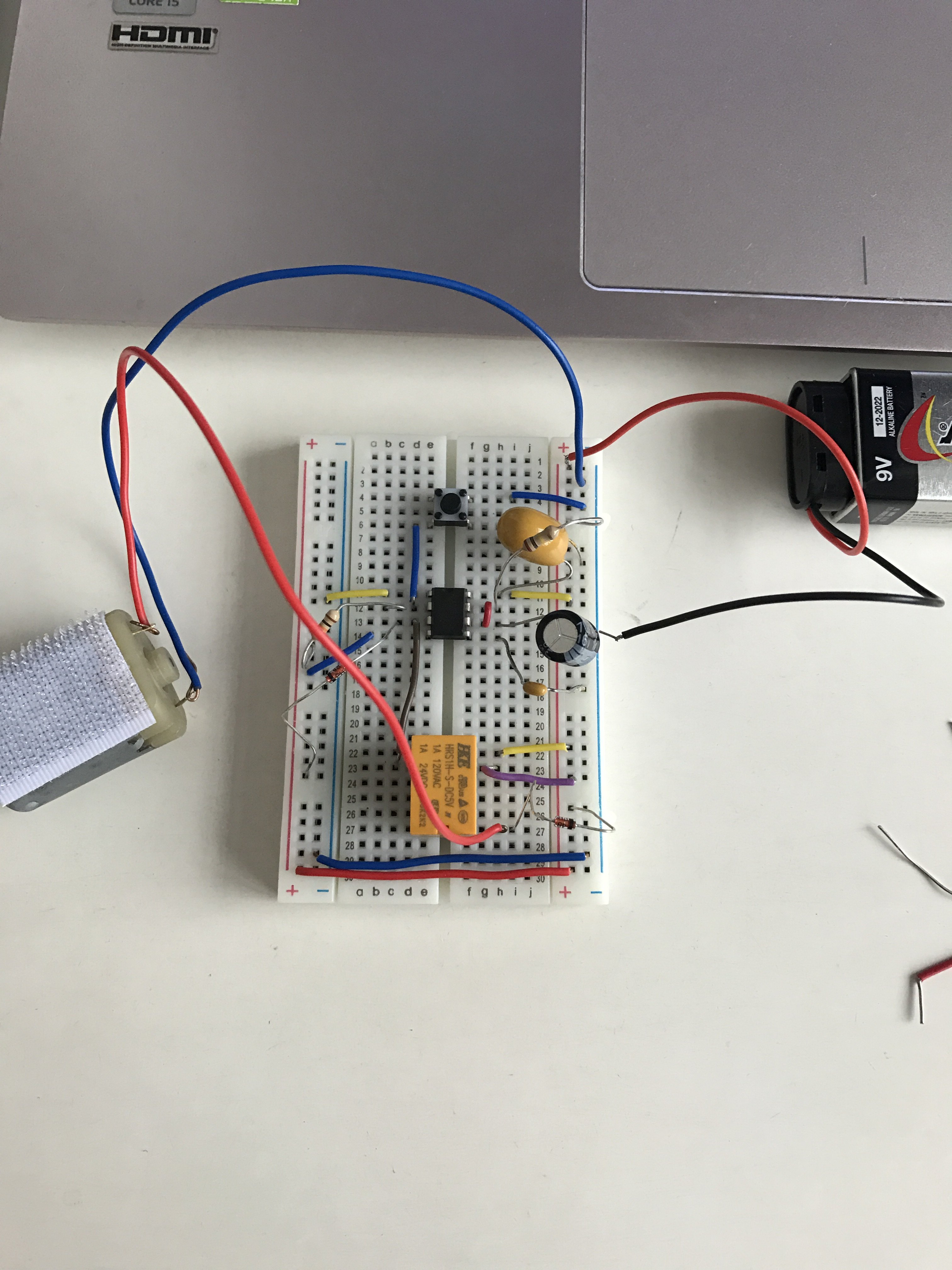

i need help with my monostable circuit!!
that attempt when the IC worked for you, then no longer did not, the Transistor may have been taken out by the relay that very same time possibly because of the flyback diode not being able to properly send the inductive spike to the supply rail.

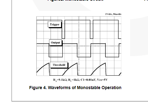

For post #80, It would be best to use an Transistor for this. It's just that with the 555Ic connected in place of the NPN Transistors Collector, the IC was sinking the relay when off, I will provide a chart that shows this.
When the IC trigger gets falling edge operation, The Trigger is sunk via the switch connected to Common GND, then the output pin 3 goes High supplying power out from the IC. then the resistor capacitor time elapses at the bottom of the chart, the output pin 3 goes low again, Sinking.

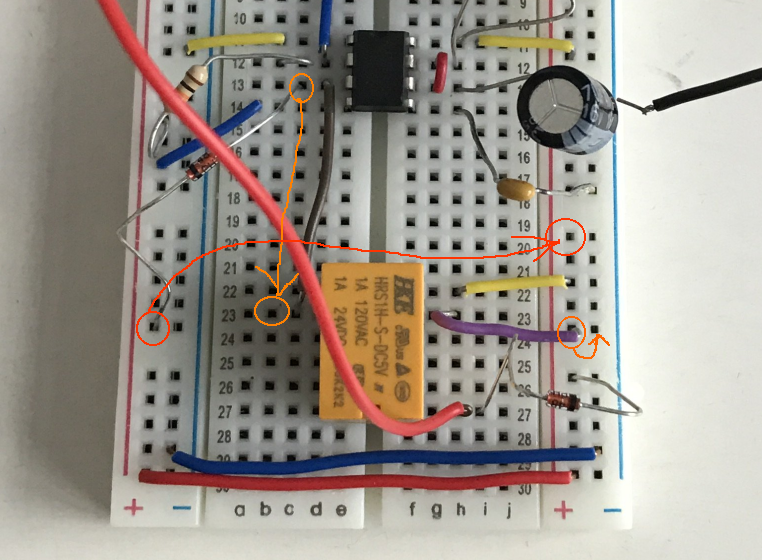

The diode anode would be placed at the relays coil connection, cathode to the rails positive supply.
And the Violet wire from the relay coil on the right side needs to be paced to the Common GND rail.
lengths of wire and circuit traces can act as small inductors themselves, as current flows along the wire it can be pressured to an end connection point, the Diode placement puts its anode right at the coils common.

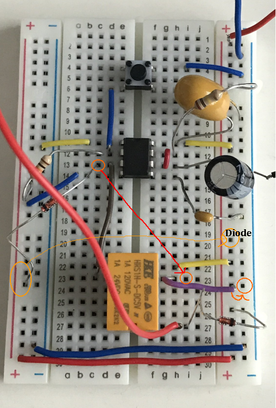

The Anode needs to be located at the relays left side at the Brown wire point, apologies. I will remake the image correct, please disregard image post # 90!
This has the Diode correctly placed for the relays fly back, giving direct line travel to the power supply!
Rechecked,
once the relay flyback diode is connected as in post #92, then the other connections show to check out.
Motor flyback diode is good, the ic is grounded, powered,
stabilized with the capacitor, the timing bank with pins 6 threshold and pin 7 discharge tied together.
Resistor R1 from power supply positive to pins 7, 6, then to capacitor.
pin 5 control cap, right.
trigger button, right.
pull up resistor for trigger pin, right.
checks out.
At the most the inductive issues would be the most to be cautious of, in the most event when the IC is directly driving the relay.
