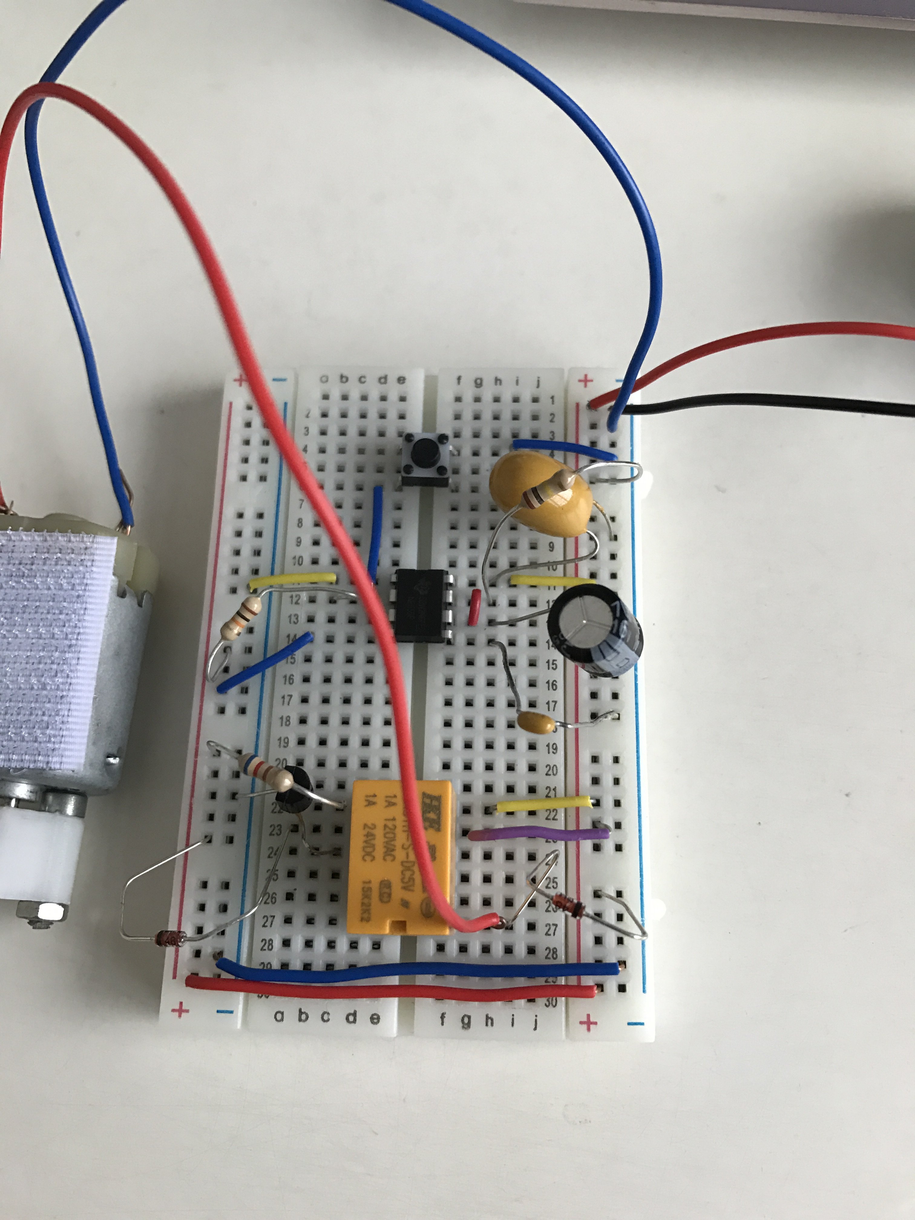

i need help with my monostable circuit!!

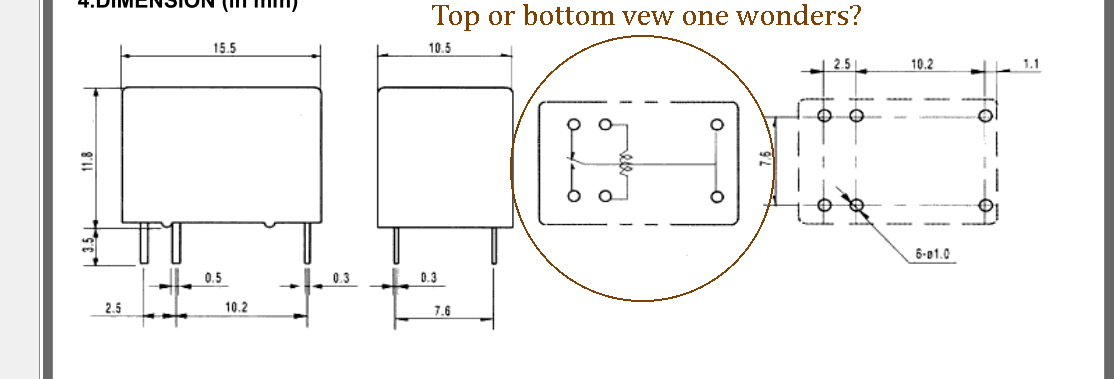

The relay, there is something about that part that has me in two directions about it.
Please return the wire back to the original port on the Board for the relay the way it was in the first image you posted, and with the transistor still removed apply power.
Does the motor run now?

Please re apply the Transistor, without the Base resistor, and apply power.
Does the motor operate now?
As for the BJT NPN transistor, my thoughts on that are (if it turns out to be a problem) that even tho it has remained at the relays coil as sinking configuration, the flyback diode even tho adequate IN4148? or equivalent may not be properly clamped into the Solderless bread boards contacts, I have lost DMOS Fets that way (2N7000), the field and shear voltage levels are tremendous from even an 5v relay, the connection is not solid enough in the board, it can arc at the boards contact points resulting in quite a EMI field in the proximity of the connection point.
The FET damage here was of the Drain to Source being shorted in most cases resulting in an on at all times device, the Gate no longer had any control, an BJT would behave similar with excessive current being allowed to pass from the Base to the Emitter thus causing the 555IC to source more current than needed and generate heat.
Ok then, with the Transistor installed and the relay connected with the motor connected and no Base resistor connected.
Lets test the Transistor a bit more, using the 620R resistor, place the resistor from the Transistors base to the power positive rail, then apply power, the results should be the relay switches on, and the motor runs in that configuration as soon as powered on.
Does this happen?

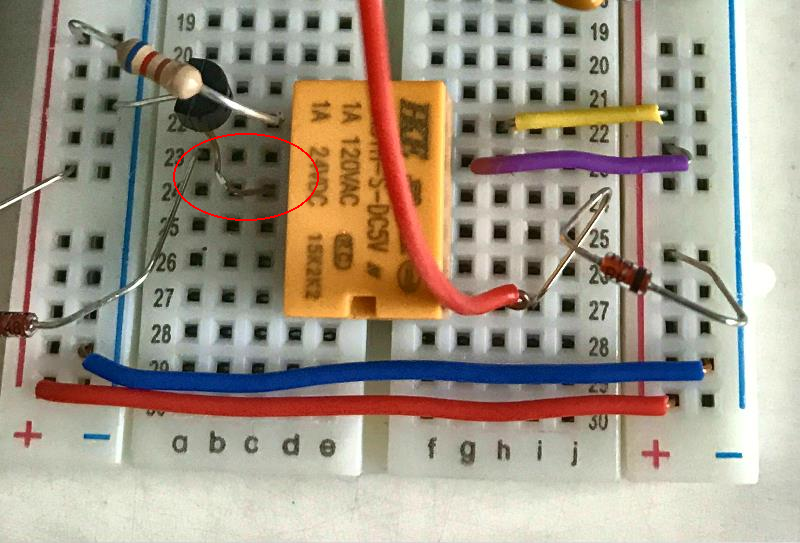

In that last image, I've manage to clear up that shadow to the right, the Transistor Collector pin is NOT in the relays coil pin row..
Please apply the Transistors collector in the row with the Diode.
when the Collector pin is in the relays coil row, and the 620R resistor placed the same, to the power rail positive, apply power,
Does the relay click and the motor run?
