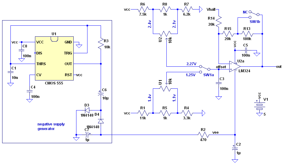

I was going to propose splitting the supply and creating an artificial or "virtual" ground (hence my question in post #28), but gave up when DamoRC said he was using a 5V wall wart, and also because he might have a 30mA LED.
Attached is a scheme that uses a simple DC-DC converter to create ≈-2.8V. I added a DPDT switch for simplified gain switching. This scheme still needs a voltage regulator, or a separate reference voltage, to keep the output stable. If the LM331 can be made ratiometric, then it might work without a regulator, but that would seem to me like a poor design.
The .asc file is not identical to the posted schematic. I was mainly testing the interaction between the converter and the amplifier.
  • Hall effect level shifter.asc

I don't know what you are reading, but the LM358/324 can handle any split of 32V: 0 and 32, -2 and 30, -8 and 24, ±16, -32 and 0, etc., or any rail-to-rail differential of 32V or less, down to around 3V. You just have to maintain the input common mode range to be between the negative rail and 1.5V below the positive rail.

hi damo,
Built on a bread board the circuit I posted using a LM358.
The output of the LM358 cannot be set closer to zero than +0.6V, for the reasons explained in my post, the LM358 in that configuration is not up to the job.
I then tried a MCP6002 [rail2rail] OPA in the same circuit, as explained the non invert gain is 2.
So used a divide by 2, resistive divider on the non invert input.
With HE input set at 2.5V, the NI is 1.25V , so the OPA output is 2.5V [without any Voffset input on INV]
Adjusted the Voffset to null out the OPA 2.5Vout, the output zero close to 0V, actual 8mV, with no external load on the OPA.
But as Al points out the HE device could be subject to fields that would drive above and below the nominal output +2.5V of the HE.
Could you tell us what the expected range of output of the HE you expect when in service.??
BTW: my patience isn't wearing thin, its Teflon coated...;)

hi damo,
Read your results.
With a LM358 and a single 5V supply the circuit will never work as you want it too.

It will never work right if zero volts out with zero gauss in is a requirement. It needs a negative supply if he wants to get to zero.

MrAl, did you read my post about the output having to sink the current that flows through the feedback resistors?
Compare that number to the specs, and you will see why 50mV is probably not possible without a negative supply.
You can get closer by reducing the feedback current by a factor of 10. You will need to make the Thevenin resistances on the +in and -in inputs equal, so that input bias current does not cause problems.
I wasn't "tacking on parts". I was giving our OP a solution to his problem as stated. The circuit I posted should work if it is built correctly. As I mentioned, a 5V regulator is needed, which means that the 5V wall wart won't work.
The regulator will be needed no matter how the rest of the circuit is implemented.
The output of the LM358 is NPN and PNP complimentary emitter-followers. They have a voltage of about 0.62V each. The output has an extra 50uA current source to ground to pull its output down to typically 0.005V when it has a 10k resistor to ground and when it does not have a feedback resistor like in this circuit pulling the output up with a current that is much higher than 50uA.
Hi again guys,
My apologies, i thought someone already made it clear to the OP that there would be the need for some kind of output resistor to ground and so this would be an automatic assumption. I think i would opt for a 1k resistor myself.
As far as the 5v power supply is concerned, i would tend to want to use a 5v *regulated* supply. However, because of the ratiometric operation of the HED and of course the two 20k divider resistors are automatically ratiometric this circuit could very well work with an unregulated supply too, as long as it doesnt dip too much lower that say 4.5 volts. I want to take another look at that HED data sheet first through. Yeah ok, it works only down to 4.5v so using a 5v unregulated supply is cutting it close. If the line dips down to low line the DC could very well dip as low as 4.25v which would not really be good enough. I would suggest a regulated wall wart or a wall wart with more DC output like 9v and a good 5v regulator at least as good as the LM317L or better.
As i said *several* times in this thread however, we dont need a negative supply so dont worry about that anymore.
