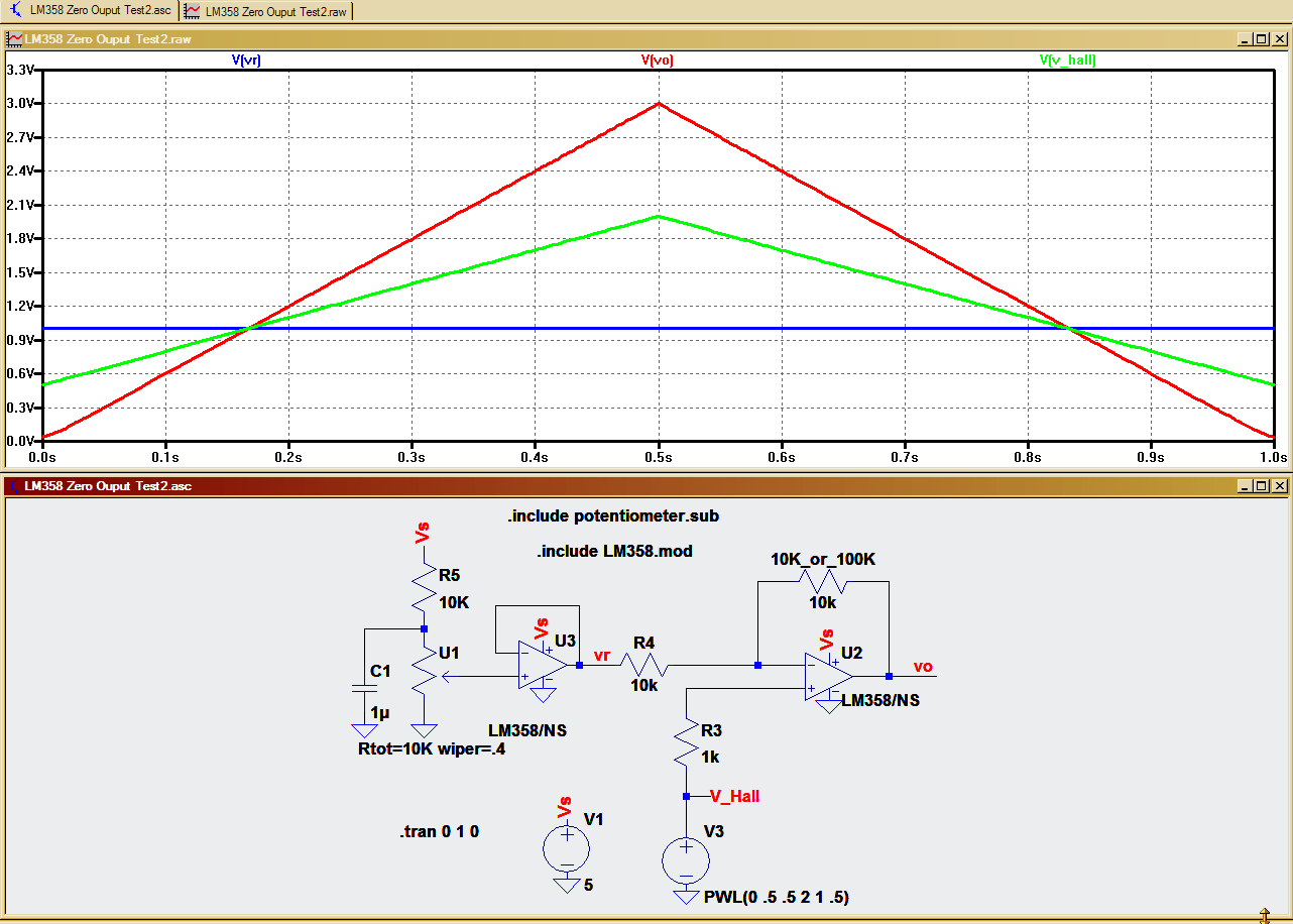

hi damo,
When I posted that earlier circuit I had not moved the Hall input to the non inverting input of the OPA, a careless oversight.!
This circuit assumes that the Hall Effect device has a range of 0.5V thru 2V, adjust the offset and gain to suit the HE device.

Eric - thanks - that circuit makes a lot more sense to me. Is there a specific reason / advantage to using the voltage follower for setting the reference voltage. I have seen that approach in a number of circuits using the LM358 dual package.
The Vref OPA provides a low impedance path for the second stage OPA input resistor.
If you took the Vref from a resistive divider, every time you adjusted the OPA gain you would have to adjust the Vref pot

Edit. Just put a 10K from the op amp output to ground and the op amp output voltage dropped to 0 (this using Mr Al's positive injection version of the circuit). However, the circuit is now non-responsive to the hall sensor. Also, in case it may help, I connected a pot from the Op Amp output to ground and adjusted it until the output voltage became 0.02 V (basically just above zero). The op amp was still non-responsive to the hall sensor. When i removed the pot and checked for the resistance that was being applied, it was 47 ohms. Not sure that this tells us anything.
What voltage do you measure on the actual HE output, ie on the non invert pin of the OPA.?
Try to connect a 10K from the output of the OPA to 0V.
Have downloaded the pdf, will look thru it.
EDIT:
Looking at the HE d/s, I see that the output swing is about the Vs/2 level, so for no field the output is +2.5V.
The Gain at the non invert is 1+ [Rf/Ri] ie: 2 with 10K's
So the Vout would want to drive to 5V, to offset this would require +5V from the Vref OPA, which it cannot do as at 5Vs , the max is +3.5V.!
One way would be use a resistive divider on the HE input, say div by 2, so that Vout would be +2.5V with no field.
Apply an offset voltage Vref of +2.5V to bring the Vout to ~0V.
The LM358, IMO , at 5Vs is not suitable for the project, either a rail2rail or a higher Vs or a -Vs dual supply.
