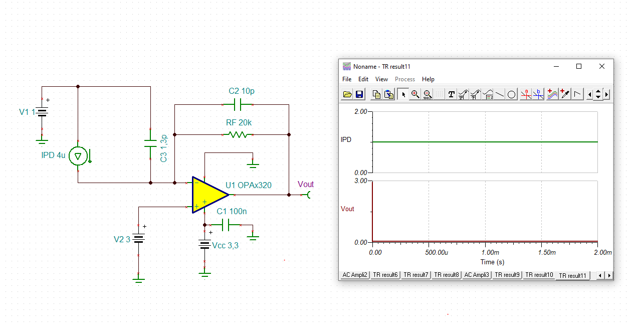

Dear Team,
Below is a TIA using OPA320.
I am expecting an output voltage of 3-(4u*20K) = 2.9V ,but obtained a value of Zero.
The current source value is 4uA but it is measured as 1A.
May I know what is the issue.

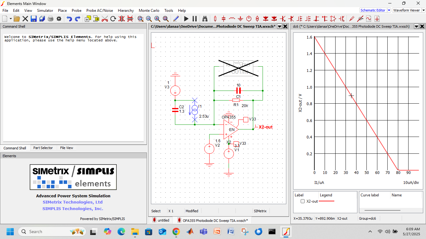

I get the following with a lower bias than you had :
Seems like this part claim RRIO does not want input Vref close to its + rail, if one plays around
with diode Voffset and the +Vref....but then I would do the DC analysis by hand to get what
T(DC) should be..
