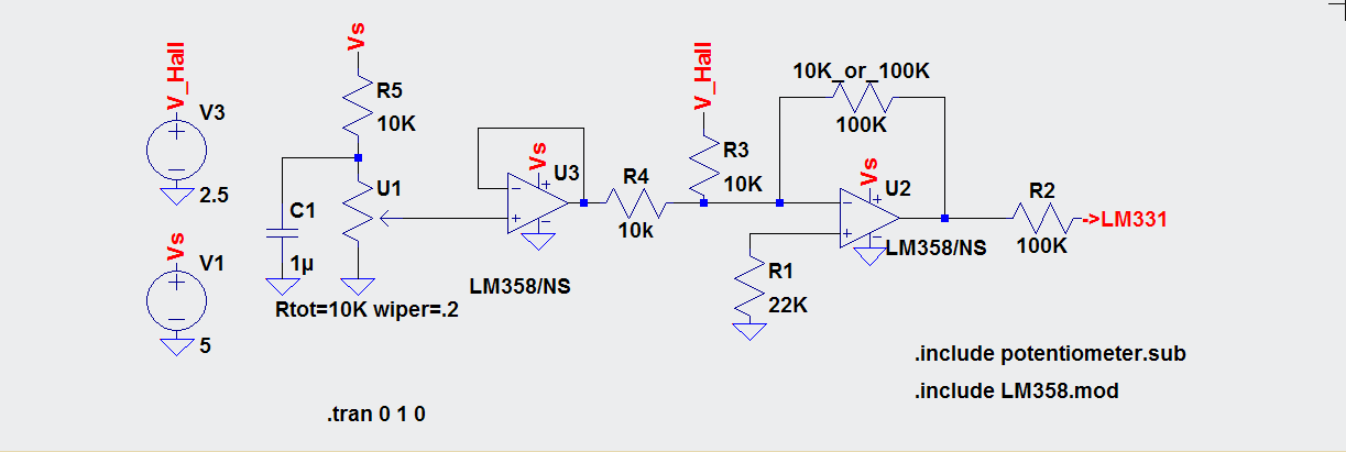

I am using a circuit represented by the attached to (1) amplify signals from a hall sensor and (b) send the output to an LM331 to convert the voltage to frequency.
This is working fine for my needs but I am curious as to why I can not get the LM358 to adjust to 0 volts when there is no magnetic field on the hall sensor. The sensor's "quiescent" voltage is Vs/2 (in this case 5V/2) when there is no magnetic field detected. I thought that by adjusting the pot so that the voltage into the non-inverting side matched the inverting side , I would get 0 volts output from the LM358.
The feedback resistor(s) are on a switch so that I can choose 10K (no amplification) or 100K (10X amplification).
The original configuration of this circuit used the first Op Amp circuit in the LM358 dual package to perform the zeroing function (pot connected to non-inverting side, configured as a voltage follower). However, this produced the same results as the circuit presented here, so I stopped using this approach.
I have experimented with the circuit to see what I can learn.
When the feedback resistor is 10K (no amplification), the lowest output I can achieve from the LM358 is 0.63 volts. I have to adjust the pot so that the output climbs slightly higher than this to ensure that the circuit responds to the smallest of changes in the hall sensor output. By adjusting the pot to about 10K, I get an output of 0.7 volts and I can use the circuit.
When the feedback resistor is 100K (10X amplification), the lowest output I can achieve from the LM358 is 0.09 volts. Again, I have to adjust the pot so that the output climbs slightly higher than this to use the circuit. By adjusting the pot to about 18K, I get an output of approx 0.2 volts and I can use the circuit.
As I said, this is not a major problem and I can use the circuit as is to meet my needs. However, given that the effective working range of the LM331 is 0 to Vs-2 (in this case 5V-2), losing 0.6V of "range" is a little annoying. Also, given that this is the first time I have used an Op Amp (but hopefully not the last) I would like to understand this a little better.

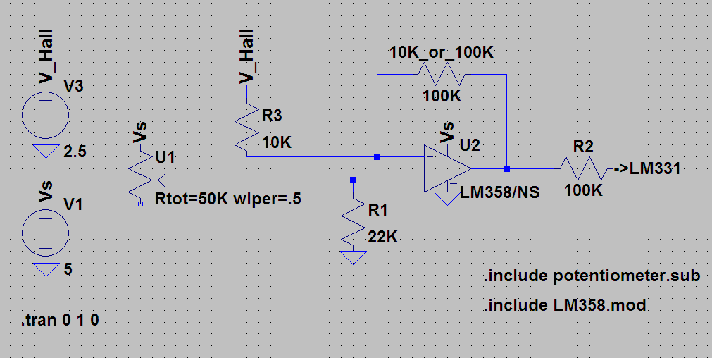

Its not possible use a positive voltage on the non inverting of an OPA to null to zero when using a single supply.
You need to inject a positive voltage into the inverting input.
I use LTspice, so if you post your asc file I could suggest a modification.

I wonder if that 0.63V limit is with the 10k feedback resistor, or the 100k. Keep in mind that, for the output to get to 0V, the output must sink (2.5V/(Rs+Rf). This is either 125uA with the 10k Rf, or 22.7uA with the 100k. In either case, the LM358 is not really equipped to sink much current when the output voltage is low enough to cut off the PNP emitter follower.
Based on your circuit, this is one option to enable setting the LM358 output close to ~0v.

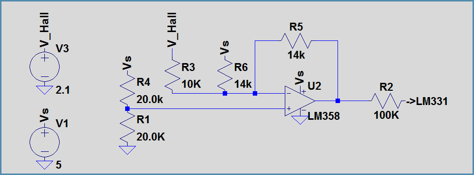

Hello again,
Your original circuit was close, you just needed to adjust the gain and add some offset. The attached circuit has those features.

Hello again,
Note that for the basic design R4 is the same as R1 so that we get 2.5v at the non inverting terminal. With R3 at 10k that makes R5 equal to 14k because the LM358 can only output up to about 3.5v max with a 5 volt supply. With R5 set at 14k we set R6 at 14k also so that we can zero the output with 2.5v input from the HED.
You can make R1 and R4 just about anything as long as they are the same. If you make R6 a little smaller than 14k you can use a pot in series with it to get fine offset adjustment. For gain adjustment, you can adjust R3 or put a 1k pot in series with that after reducing it a little to like 9.5k or so.
Eric, that doesn't work. The op amp will saturate near 0V, but the summing node is not at ground, so there is no feedback. His original scheme is the correct approach (except for the pot value), IF he had a rail-to-rail op amp with good sinking capability when the output is near 0V.
The +input and summing node need to be at 2.5V*Rf/(Rs+Rf). For Rf=100k, this works out to be 2.273V. For Rf=10k, it is 1.250V. These are values for an ideal op amp.

Mosaic - Pot model (found it on the Yahoo LTSpice group) attached:
