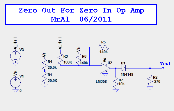

Zero Output for Zero Input:
When you think about it, there is nothing difficult about getting zero volts. A resistor sitting in a parts bin has zero volts across it right? (Well almost) Zero volts is cheaper than plus some voltage or minus some voltage too, because it doesnt require any energy to 'produce' (note we dont even really produce anything to get zero).
So with that in mind, here is one such solution for a zero-output-for-zero-input op amp circuit. Does it get any simpler than that?
Note that i changed the 14k resistors to 140k, but 14k will also work with a slightly higher output zero.
Also note that i used a regular silicon diode, but a Schottky would mean less loss of upper range (upper range loss is equal to the diode voltage drop, thus we would loose 0.5v roughly bringing the upper output range limit to around 3v for a 5v power supply).
In some cases a resistor of the right value can replace the diode which helps to maintain the upper output range limit.

Hi Eric and Roff,
Moral of the story: Creating a voltage supply is not so easy to do, but creating a voltage drop is always simple :)
Eric:
Oh ok i missed your original post, but i guess it looks ok now? The OP's original input was intended to run from 0 to 2.5v, so you may want to try that input range next. I've seen the output go as low as 5mv so far.
Roff:
I seriously considered an NPN emitter follower and it does provide more current output. The only drawback is that there seems to be no away around the 0.7v BE drop whereas with the Schottkey we can get down pretty low like 0.4v which leaves another 0.3v on the top range limit. Maybe a germanium transistor? The advantage is we can use a lower output resistor like 100 ohms and get the output as close to zero as 0.002v or something like that.

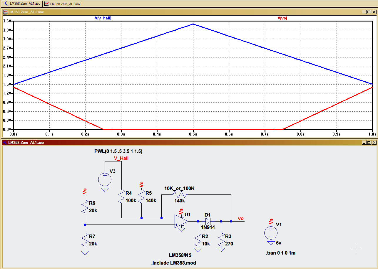

Sorry folks, was away for the weekend and I am only catching up tonight.
I can report some progress. Although previously I had tried Mr Al's idea of voltage injection at the in- and reported that it did not help.
This was using all 10K resistors (HE to in-, Rf to in- and Voltage injection to in-).
Based on the latest circuit proposed by Mr Al (the one including the diode), I replaced the 10Ks with 100Ks and now, I can get down to 0.1v, with the circuit still responsive to the HE signal.
10K to ground does not work. It just drives the output to 3.5 and the circuit becomes unresponsive to the HE signal.
I have not tried adding the diode because the 100K voltage injection version has just gained me 0.5V of range with a reasonable lowest value. I don't need to lose 0.5v of range at the top end.
I will continue to play with this a bit as I would like to understand further the relationship between the resistor values and the circuit behavior.
But for now, I am in a better place.
Thanks Mr Al and everyone else for your thoughts and comments.

Hi again,
10k to ground where?
I am starting to think that maybe you should try to simulate your circuit first in a circuit simulator so you can get an idea how it is supposed to work. Then you can compare that to your real world circuit and see if there are any differences. Usually a circuit this simple takes about an hour to build and test so i think that would help you understand this thing a lot better.
The 10K to ground I refer to is R7 in your posted circuit (post output, pre diode).

Hi again,
Oh ok great. I am sure you will find it very informative.
10k on the output to ground? There's almost no way that can cause the output to go to 3.5 volts, by that change alone. That's why i was suggesting that something else more basic must be wrong somewhere...a bad connection to ground, wrong value resistor, something like that because the spice sim looks very good and for DC it's not bad so you should see results very close to the spice sim, which right now you are not seeing.
Let us know how you make out with the spice and spice circuit and what you think about this next.
Mr Al et al.,
I need to post a correction. I was tinkering with the circuit yesterday and realized that the 10K to ground was actually connected to the in- of the op amp instead of the out. In the correct position, the 10K to ground had no impact on the circuit. I also determined that the ability to get a "zero" or lowest possible signal out of the op amp for a "quiescent" voltage in from the HE (Vs/2) is primarily driven by the resistances Rf (feedback) and Rs (between HE and in-) and is actually not impacted greatly by the positive voltage injection. In fact, the circuit is now achieving the 0.1v minimum output (with 1X amplification,no connection from output to ground and Rs and Rf = 100K) without the voltage injection on the in-. I think this is consistent with something Roff said earlier in the thread:
I wonder if that 0.63V limit is with the 10k feedback resistor, or the 100k. Keep in mind that, for the output to get to 0V, the output must sink (2.5V/(Rs+Rf). This is either 125uA with the 10k Rf, or 22.7uA with the 100k. In either case, the LM358 is not really equipped to sink much current when the output voltage is low enough to cut off the PNP emitter follower.
So at this point, my circuit looks identical to what I started with at the top of the thread except the 10K Rs and Rf have been replaced with 100Ks.
Going to tinker some more before locking it down.
DamoRC
Hi again,
You can do it that way but that means adjusting the R4/R1 pot every time you change the gain. With the bias resistor (from Vs to inverting input) you can get away without readjusting when you change the gain in many cases.
If you dont mind changing the pot setting after a gain change then you might make out ok, but if not then you'll have to use that extra resistor (which would be 100k now).
Okay - I will put it back in (Vs to in- through 100K) and see how it helps when the I change the gain.
