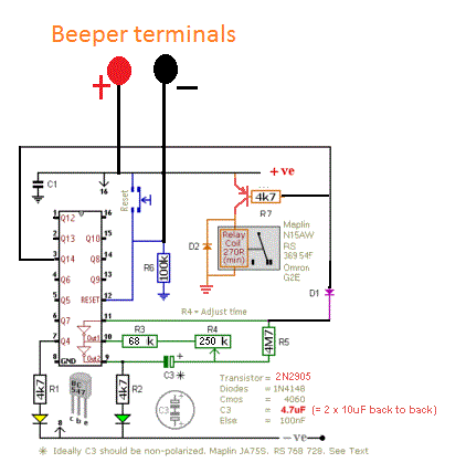

Friend I have made this 3 hr timer .... Now the next work is to attach this timer to alarm clock.... well you have send me the complete circuit... by the way friend just for learning I have dont some test... please innsure whether it is right or wrong....
Friend I had connected my beeper terminals to reset pin of IC as you can see the circuit in my attachments..
I have done like this just for learning ... I dont know what will be the result by doing like this ..so for learning purpose I have done...
And the results was , first I had started my 3hr timer then I touched the two terminals of my beeper into the reset pins as you can see in my images.... the timer green ,yellow led went off.. the timer became off... It remained off untill I take off my beeper wires from reset pins..... as I removed my beeper wires then the timer begans to run and continued.... so this was ok !!! I thought that If my beeper rangs then It continuely supply voltage to the reset pins untill the beeper becomes off.... so I have done second testing again,,,
but now my beeper was off it was not ringing........ I have start the timer then I again connect my beeper wires to reset terminals but the result was same as above.... I didn't understand why it was working like that....
The beeper was on ... the timer circuit was turn off untill the beeper becomes off but the beeper finish sounding but now also the timer circuit was off.. untill I physically removed the wires from reset pins..... as I removed the wires the timer starts to run...
So friend I doesn't understand why I got this result.......
I again removed my alarm clock cell and touched the beeper terminals wires to reset pins ... the timer turned off again and it remained off untill I removed the wire physically.....
so kindly help......
That will continuously reset the timer. So the timed period won't start until either the beeper stops or it's disconnected from the reset pin. That is why the logic gates were used to make a set-reset latch in my suggested circuit; so that beeper pulses after the first one would be ignored and not cause multiple resets.
BTW, if you're handling wires while you connect/disconnect the beeper remember that the circuit is static-sensitive and could be damaged. Also, your body acts like an aerial and picks up all sorts of interference which may be getting through to the circuit and causing weird results.
when my beeper stops or I remove my alarm clock cells then also my timer doesn't start to run.... untill I disconnect my wires from reset pins.
That's probably because the internal impedance of the beeper circuit bridging the reset switch is keeping the timer in the reset state. That shouldn't happen if you build the complete circuit I suggested and connect the beeper to the input of the transistor amplifying stage as per the circuit. If you don't follow the designed circuit then (a) you shouldn't be surprised if you don't get the expected results and (b) it makes it difficult to diagnose any problem.

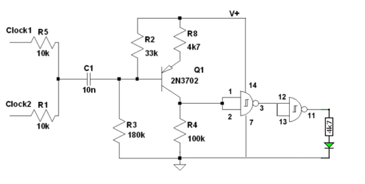

Show me that your clocks will produce a high at pin 11 (light the green LED) reliably - every time
And I will show you how to connect your latch to the 4060 timer.
Again....
There's no point in doing anything until you know that you can produce a high - using your clocks.
And I've added the green LED.
You need to produce a high to reset the 4060 -
So you need to figure out if (and how) it can be produced.........

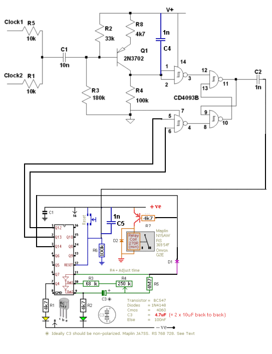

Alec... this was the message I got from him.....and he has given me a circuit diagram ... I have put in my attachment so please have a look and suggest how should we light the green led reliably...
As my friend said "" Show me that your clocks will produce a high at pin 11 (light the green LED) reliably - every time ,And I will show you how to connect your latch to the 4060 timer. ""
So alec how should we accomplish this .... task by glowing green led reliably...
Thanks in advance.....

I have noted your friend's circuit, but having reconsidered the problems posed by an unreliable mains supply I have made a number of changes to my circuit.
The amplifier part of the new circuit is now more sensitive to typical beeper frequencies but less sensitive to lower (mains hum) and higher (rf interference) frequencies.
Pot R3 enables the Q1 base bias to be set so that U1 pin 1 sits at about 2/3 of +V, and R7/C4 keep pin 6 low during power-up. This ensures pin 4 starts high, hence the 4060 is held in the reset state until a beeper pulse flips the latch formed by U1a, U1b. That releases the reset state and enables the timer clocking. When Q14 of the 4060 goes high the latch flips again and the reset state is re-entered. The reset state is also entered if the timer is interrupted by failure of the +V supply.
The relay is now driven by an NPN transistor, which simplifies allowing the relay's +V to be different from the +V of the rest of the circuit if desired.

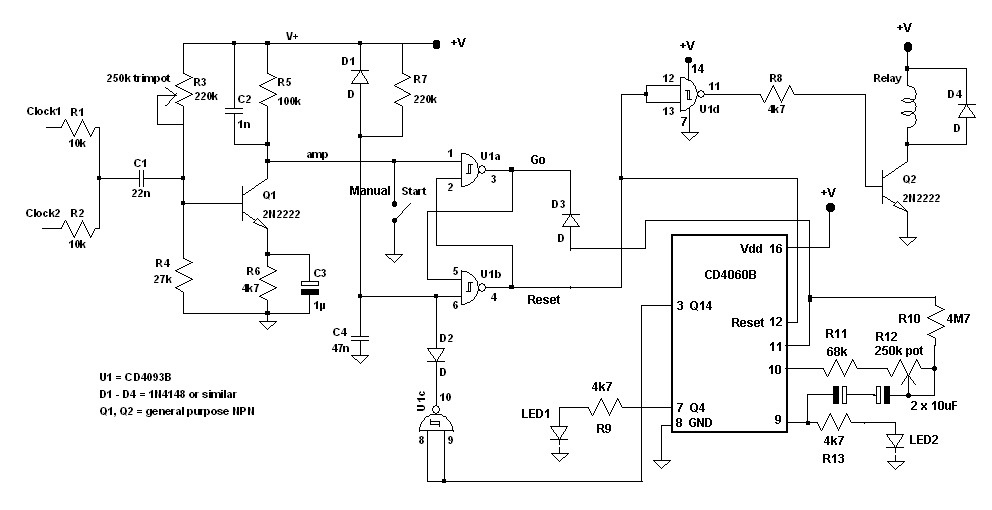

Hello, alec again I showed your post.. To my friend..And he was happy and replied :
I was thinking along very similar lines.
That is - to power-up the 4093 with pin 4 high -
And to use pin 4 to hold pin 12 of the 4060 high -
Until the alarms sound.
I am confident that this sort of approach will work.

I welcome your friend's input. It's always good to have a second opinion.
According to the simulation, if the Q1 bias is set as I said then a beeper signal in the range of 500Hz-1kHz, sinusoidal or square wave, and of amplitude ~0.1V or greater will change the 4093 state reliably. But you will have to build the circuit and test it with your particular beeper signal to know for certain. Make sure that wires from the beeper to the amplifier stage input are as short as possible and properly screened to minimise noise pick-up.
