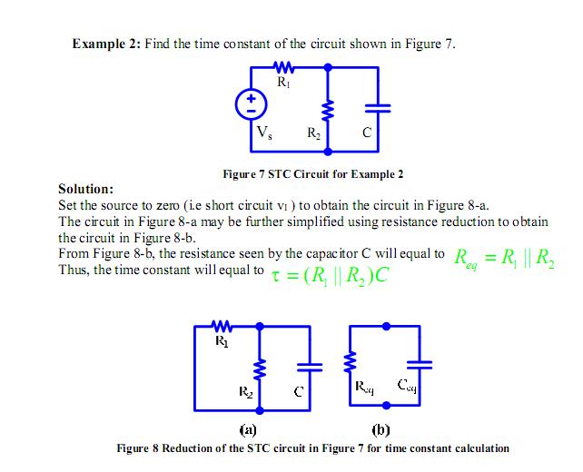

Hello, MikeMl, MrAl, Ratch, steveB, and The Electrician, I appreciate all your help, but I haven't finished my elementary circuits course, I can not understand most of the discussion you've posted here. I was thinking that I would go back to this problem later when I finish stduying Laplace transform, but 'never put until tomorrow what you can do today', I think I should say clearly what I really don't understand and hopefully get the answers, otherwise, I'd feel guilty at wasting your time.
First, please allow me to start with a new, simpler problem which is in the same ducument at https://faculty.kfupm.edu.sa/EE/husseina/081/STC_Bode_Plot.pdf
My first question is about Thevenin's theory and the voltage source. If Vs in Figure 7 is a step voltage function, and I want to find the equivalent circuit seen from the capacitor into the circuit, does Thevenin's theory still apply? The reason why I ask so is that I only have experience of finding Thevenin equivalent circuits when the sources in circuits are DC or sinusoidal functions.
Secondly, I have to ask, why do we need to know about the Thevenin's equivalent circuit of original circuit? Is the purpose to try to find the capacitor voltage function of time?

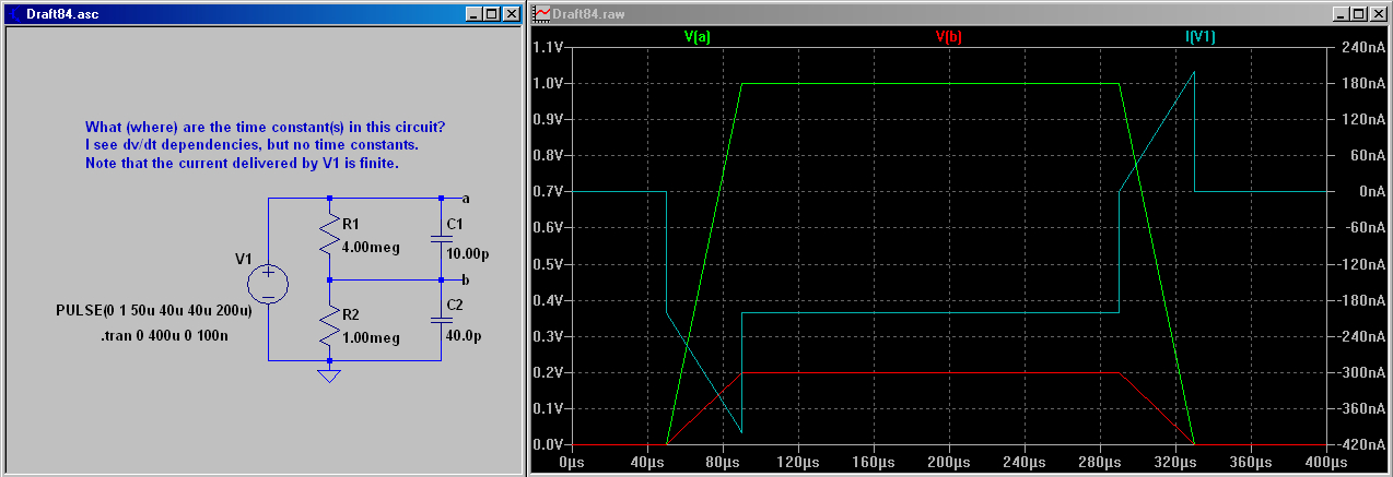

I was trying to interpret your simulation results, but I was not sure I understood it fully, which is why I could not comment on it.
Perhaps you can explain some things that are confusing me.
1. You show V1 starting at a value of 0.5 V, but the Va and Vb start at zero, and stay that way while the V1 is steady at 0.5V. Hence, it seems that KVL is not obeyed here. Shouldn't Va=V1?
2. You mention that the current from V1 is finite, but it's not clear why. Did you somehow limit it? It seems that the mismatch in V1 with the sum of the cap voltages would cause an infinite current. And, when the voltages are matched, a perfect pulse change should induce infinite current.
I expect I'm just misunderstanding either the setup of the simulation, or not interpreting the signals correctly, and I hope you can clarify for me.
EDIT: Sorry. So I went back to recheck the simulation you showed, and I see one cause of my confusion. I was reading your I(V1) as the V1 voltage input. My eyes are getting so bad and it looked like (V1) to me.
So, I think I understand the simulation now. A little later I'll post a comment on that.

MikeMl,
In Post #4, V(a) is an example of the response of the OP's original circuit with purposely mismatched time-constants. The response shows a "combined" time-constant per the OP's attachment.
In Post#4, V(b) shows that circuit B (from the OP's attachment) has a very different behaviour than circuit A; therefore cannot be a "Thevinin Equivalent" of circuit A. By implication, it is not possible to come up with one that contains a single voltage source, one resistor, and one capacitor.
In Post#5, Circuit A and V(a) is repeated.
In Post#5, I present an "Equivalent" circuit (C), which consists of a stepped voltage source with a partial "Thevinin-like" equivalent sitting on top of it. The response V(c) is identical to V(a). The combined time-constant is per the OP's attachment.
Note that in all the simulations of Posts #4, 5, 36 and 39, I am limiting the rise-time of the input voltage source. Because of the capacitive load, limiting the rise-time means that the source is only delivering a finite current to initially charge the capacitor(s). It is not necessary to limit current by adding source impedance. Only if the the rise-time of the voltage source is zero would an infinite current be required...
This is the reason a 10X scope probe is used when displaying high-speed logic signals. The effective input capacitance of a 10X scope probe is one-tenth of the scope input amplifier capacitance shunted by the cable capacitance...

If there is a short in place of the voltage source, how can there be different initial voltages across the capacitors? In that case the two capacitors are connected in parallel.
My first question is about Thevenin's theory and the voltage source. If Vs in Figure 7 is a step voltage function, and I want to find the equivalent circuit seen from the capacitor into the circuit, does Thevenin's theory still apply?...

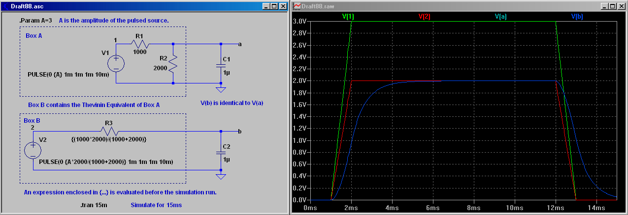

Here is simulation which illustrates your question about a stepped voltage source. I show that the response of the original V(a) and Thevenin Equivalent circuit V(b) are identical. Note that only the amplitude of the stepped source needs to be modified from 3V to 2V to create the Thevenin equivalent source; all of the timing parameters remain the same...
btw: LTSpice's pulsed voltage source has the following parameters:
PULSE(V1 V2 Tdelay Trise Tfall Ton ...)
You have asked the most interesting question thus far. The answer is that the caps will even out their voltages to one single voltage when the source voltage ceases. Let's look at an example circuit below. The time constant of each cap is 40 usec. You can easily see that the voltages across C1 will be 0.8 volts and C2 will be 0.2 volts while the source voltage is steady at 1 volt.. When the source voltage goes to zero, the voltage across both caps in parallel will be -0.8 + 0.2 = -0.6 volts at t=0, the instant the source voltage is turned off. Then it declines to zero exponentially. I know that is not intuitive, but Laplace does not lie. I hope I did not goof in setting up the node equation.
