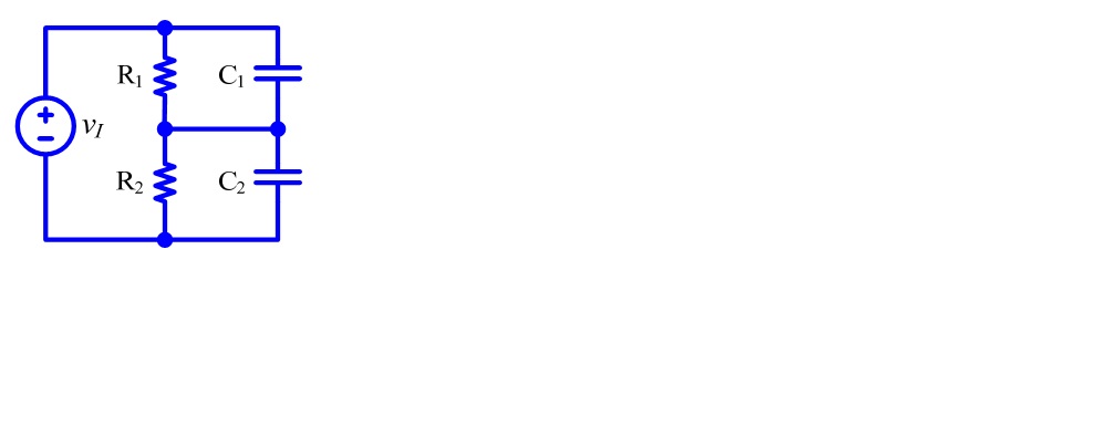

Dear friends,
In the circuit below, I would like to find its time constant by trying to convert that circuit into an equivalent one that contains a voltage source, one resistor and one capacitor. Could you please give me some clues as to how to proceed? thank you!
You cant.
Here is a solution which I downloaded from the Internet.
What I can't understand is why that method works (if the method is correct).
Is it possible to use Thevenin's theorem here? And how?

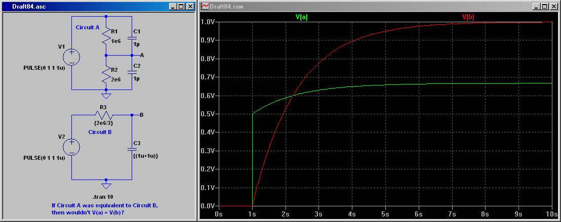

It doesn't even work if we reduce the amplitude of V2 to 0.6666V (which the author of the attachment overlooked).

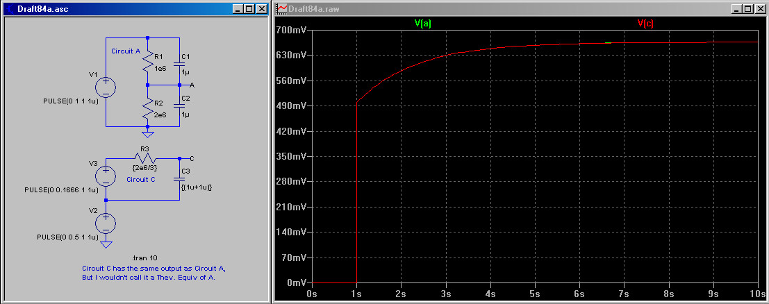

Here is an equivalent circuit, but it is not the Thevinin Equiv. of Circuit A
I think it might be possible in a sense. I'm in a restaurant so I can't be sure, but I sketched in on a napkin and it seemed to work out. However, I had to cheat with scaling and make an equivalent voltage source that didn't really scale in the right way. Also, I had to assume a perfect DC source for Vi. I'll check it later when I get home. Basically, I wrote on the differential equation for one capacitor and then considered that i2=-i1*C1/C2 if Vi does not change in time, where i1 and i2 are the capacitor currents. Following this through reveals a differential equation that looks a lot like a series RC circuit, but the voltage source is not quite right. But, if you cheat with units and change the value of the voltage source, you can make it work.
Basically, I'll agree with MikeML and say this is not really the right way to do it, but it might be the intention of the problem. However, if the goal is just to find the equivalent time constant, then this is simple and it is just R1 in parallel with R2 and C1 in parallel with C2.
Heidi,
The time constant of the circuit only has meaning with respect to the energy storage elements in the circuit. In the circuit you submitted, there are two storage elements (capacitors), and therefore TWO possible time constants. I will calculate the time constant of C1. C2 will have a similar calculation. Using the potientiometer method, I will find the voltage across the C1 capacitor when a 1 volt step is applied.
As you can see, the exponential term of "e" is a time constant of the resistors in parallel and the sum of the capacitors. In this symetrical circuit, each cap will have the same time constant. But, I believe the solution posted on the web is correct for the wrong reason.

Finding the time constant is straightforward and the given soliution is correct for the right reason. Basically two storage components does not guarantee the system is second order with two time constants. One can write this system with one state equation, hence only one time constant.
The only uncertainty is whether the first order system can be written as an equivalent simple series RC circuit driven by a simple voltage source. I think you can get close, but strictly I don't think it is rigorously correct. Hence, I agree with MikeMl.
I'm reasonably certain of this but to be absolutely certain I need to derive the state space system formally. But I can pretty much see how it will go. You can write the state equation for one capacitor, but the the rate of change of voltage on the other cap is constrained by the rate of the voltage on the other cap and the rate on the input voltage. Hence, the second state equation is redundant and it's a first order system. Putting this in standard state space form is then tricky because the state equation depends on the derivative of the input, hence the state variable must be redefined to get the standard form without derivatives of the input signal. Presumably the new state will be a linear combination of the two capacitor voltages.

I want to thank you all for helping solve the problem and thank you for your precious time.
I have read all the posts carefully. I'm not familiar with Laplace transformation yet, don't know what state equation for a capacitor means, but I see something interesting appear on the exponential in Ratchit's derivation for the capacitor voltage.
So I think I need to focus on some simpler circuits first, think carefully about what a time constant means for an equivalent RC circuit.
