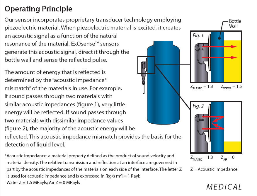

are you sure it detects water and not any obstacle? one common sensor is ultrasound transducer and can be used to measure fluid level in a tank for example using echo location. it sends pulse, than waits and measures delay until reflection comes back. modern ultrasound transducers are compact, able to distinguish even soft surfaces (like sponge/foam in a car seat) and also can be highly directional (for sound wave) with cone of about 30deg only.

ultrasound sensors are compact, and they are smaller as the frequency goes up. you produce pulse and wait for reflection. reflection occurs any time
produced pulse encounters change in media density (regardless if the density after some boundary is higher or lower).
this is the same principle as used in time domain reflectometers.

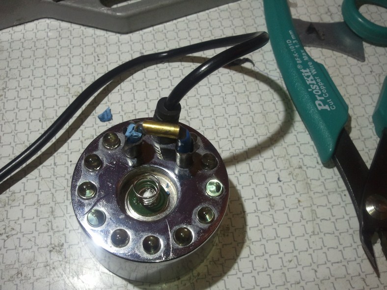

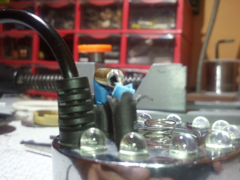

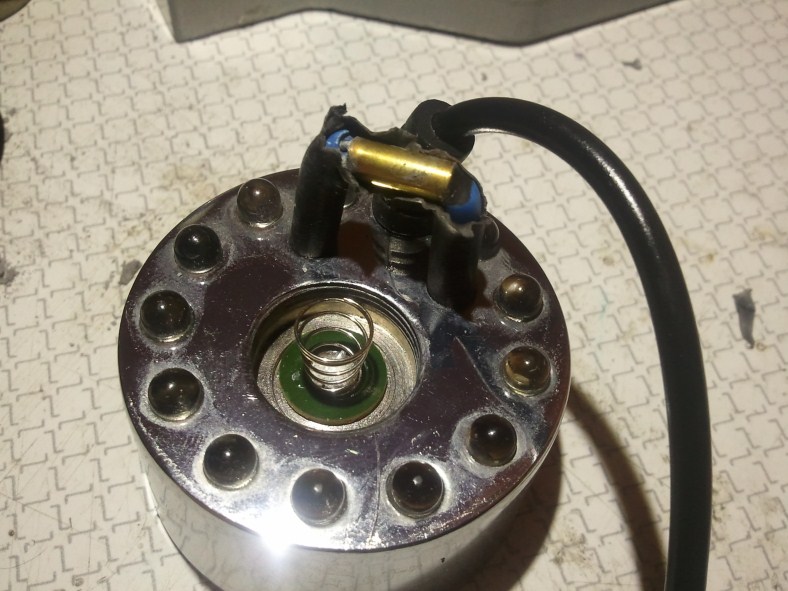

Hey gays I have some picture about inside of this water sensor see:
13567241642-jpg.69427
What is your GUESS ?
