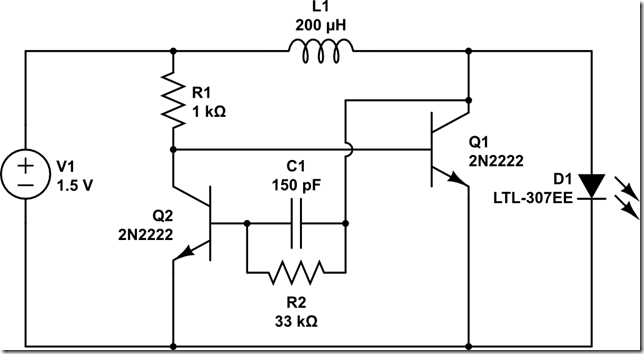

How does this weird V-Booster work?
Google "monostable multivibrator" and find a page that describes how it works and compare to your circuit.
My confusion is how Q2 Turns off. How in the world does Q2 Turn off?
I don't even know if the circuit works.
How does it work?
It's an odd arrangement of astable multivibrator.
As Q2 turns on, Q1 turns off. That causes a "flyback" effect in the inductor and passes current through the LED (at a higher voltage than the battery).
Q1 turning off also add positive feedback to Q2 turning on, via C1.
Once the inductor demagnetises, the voltage at the junction of that and the LED drops again - and that reduction is passed via C1 to the base of Q2, turning it off and turning Q1 on, which continues to force the inductor output towards 0V, again providing positive feedback via C1.
R2 sets the delay before Q2 starts to turn on again.
And so on, repeating.
At power up R1 current (about 1mA) turns on Q1.
Q1=on causes current to flow (ramp up) in L1. The current gets larger and larger until Q1 can not hold it any more. Q1 tears open a little. Q1 collector starts up in voltage. This voltage drives current through C1 into Q2 and turns it on.
Q2=on, this turns off Q1.
Q1=off, L1 flys up into D1. (maybe 3V)
Now current goes from V1 through L1 into D1. The current ramps down to zero.
L1=0 current. The LED voltage drops down to 1.5V. (rings back) (L1 & C1 causes a LC resonant)
The LED voltage dropping will push down on Q2-base (through C1) causing it to turn off and allow Q1 to turn on.
R2 is sized to when Q1 is on there is no turn on current in Q2-Base. When Q1 is off and Q1-Collector is at 3V there is good current in Q2-Base.

This circuit is very dependent on (voltage B-E of transistors) and (current gain of Q1).

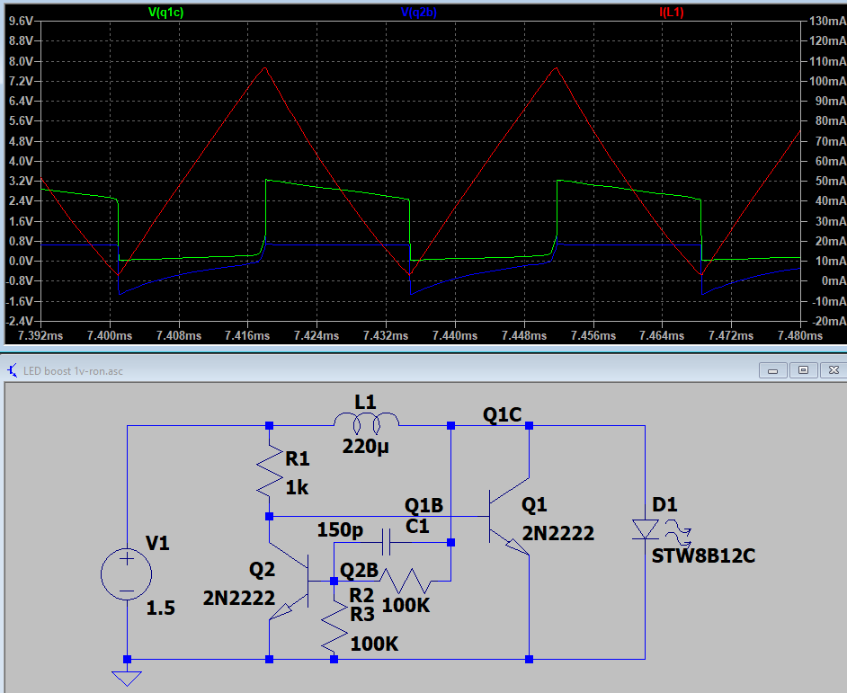

I made changes to Q2 base resistor(s) to get it to run.
Green is Q1 collector voltage. Red is inductor current. (LED current will be 100mA ramping down to 0 about 50% duty cycle) Blue is Q2 base voltage.
Thanks for the simulations sir. I'm grateful.
