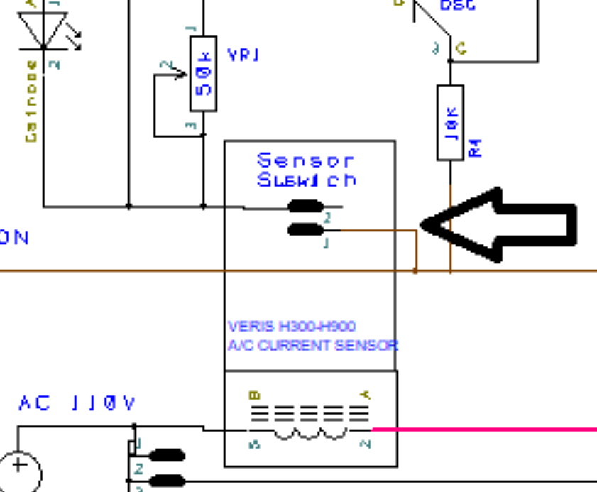

How Does This Current Sensor Close its switch?
appears to be simple and straight forward. a diode and a cap. So this would act as a switch?

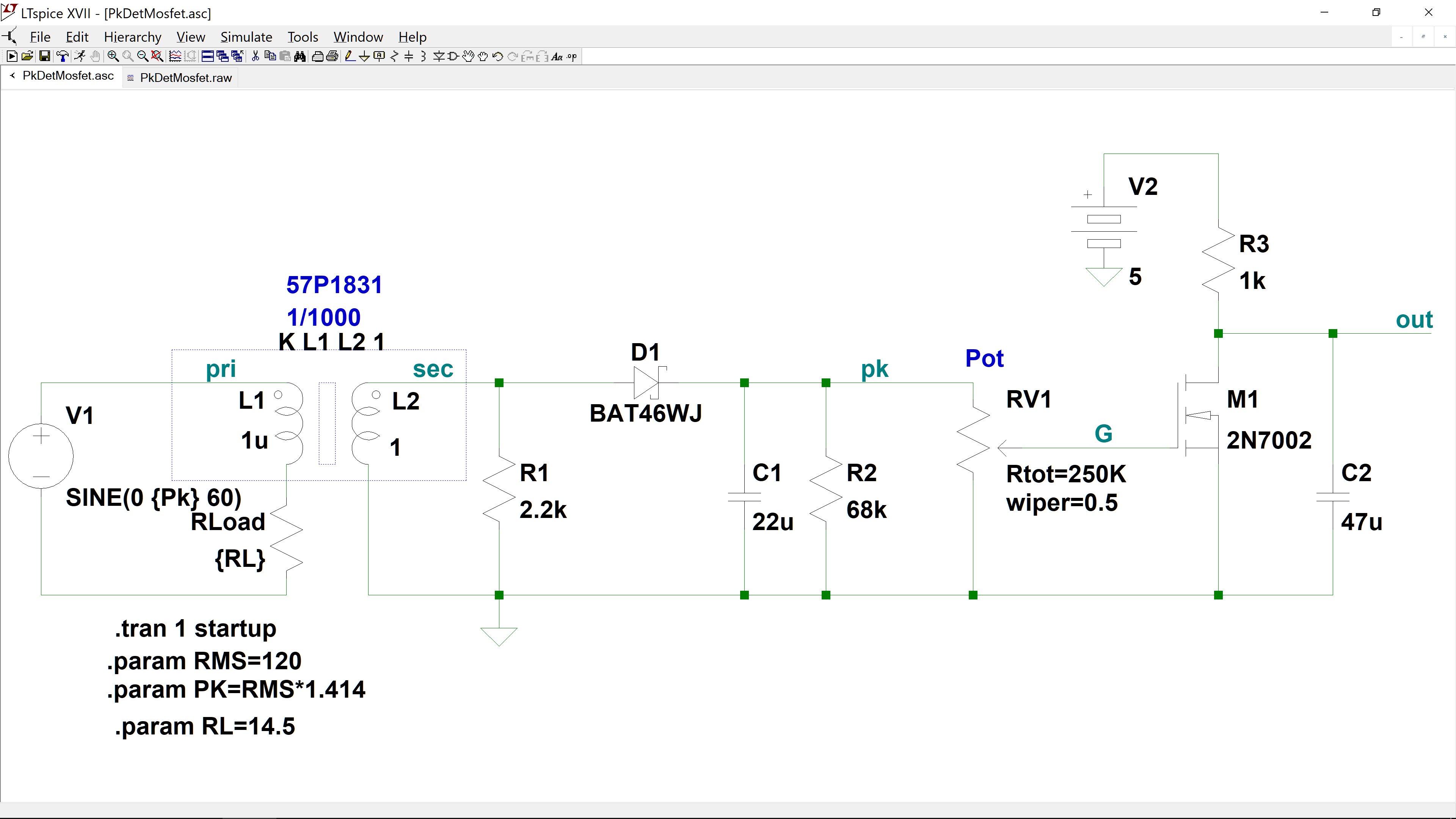

That is the peak detector - diode, cap,resistor. It basically stores the value of the peak voltage from the CT load terminals and is constantly refreshed as the voltage varies. The peak value varies based on the current flowing thru the CT---lower current--lower voltage, visa versa. I haven't tried this circuit arrangement but seems you could connect the gate of a mosfet to the detector output and set the voltage to the gate "as a threshold value" to turn the mosfet on/off. The mosfet drain could then drive a relay.

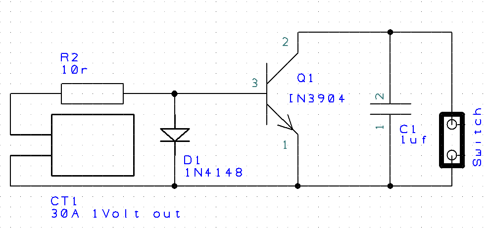

The circuit from #72 is easy to turn on. A transistor will do that.
Here the CT is directly driving a transistor.

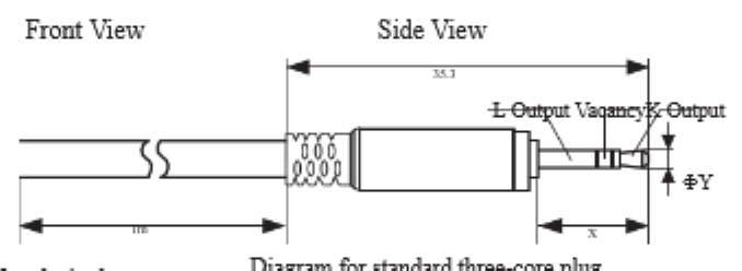

So which CT is in this schematic. The SCT-013 has 3 pins and the CTVitec Current Sense Transformers ...1832 have 2pins

so the CT on your sketch #78 is SCT-013-030. can you explain which pins are used? there are 3

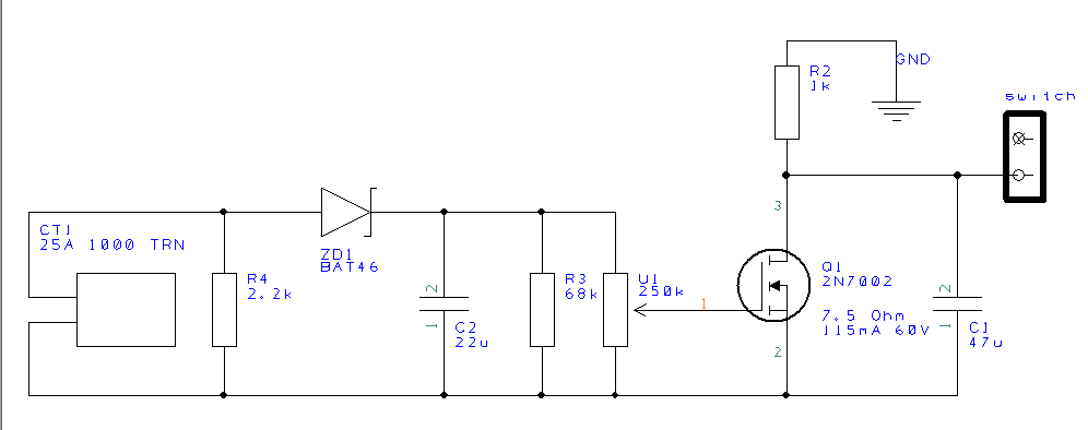

Here's what I had in mind.
Its not very accurate but could be set within about 1/2 AMP of trigger point. The output is normally high and would go low when the desired CT threshhold is met. Of course, the mosfet load could be replaced with a relay. Haven't tested this because I don't have a CT, but I think it will work.

We are having a problem getting CTs that output more than one volt. (low cost small transformers) So we removed the full wave bridge and even removed the opto isolator that needs 1.5V. I see what you wan to do but the drop in D1 + Vgs_on of M1 is too high. A transistor will turn on at 0.6V and that should solve the low voltage problem.
If R1 is what the manufacture wants, then we get 1V at 30A but only 0.3V at 3A. By not using a resistor or a very high value we are allowing all the secondary current into the B-E of the transistor. Even at a very light load the voltage on the CT will pop up to 0.6V and turn on the transistor.
At 25A the CT outputs a little more than 5V. I used the pot to be able to adjust the gate voltage above or below VGS(th).
At 8A the gate voltage is around 3.6v, so the mosfet should turn on.
I used a mosfet because I didn't want to draw current from the peak detector, but I also didn't want to go the Opamp route either.

I see that your design has a hi/low output where my circuit needs to close to function. how would i integrate your design to work with mine?
What exactly is the "sensor switch"? Is it two wire holes?
