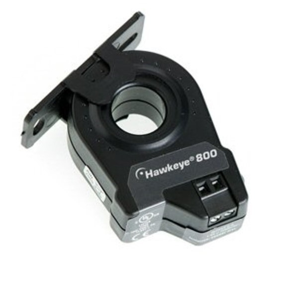

How Does This Current Sensor Close its switch?
ThomsCircuit
Current Measurement Range : 0.25 - 200 A
Current Sensor type : Current Switch, AC
Electrical Wiring Size : 24 - 14 AWG (0.2 - 2.1 mm²)
Measurement Type : AC Current
This switch (file hawkeye 800)runs about 15$.
Id like to see if I can build it.
Besides the cost this one is big. Id like to make it smaller. For my purpose 20amps is all that i would require.

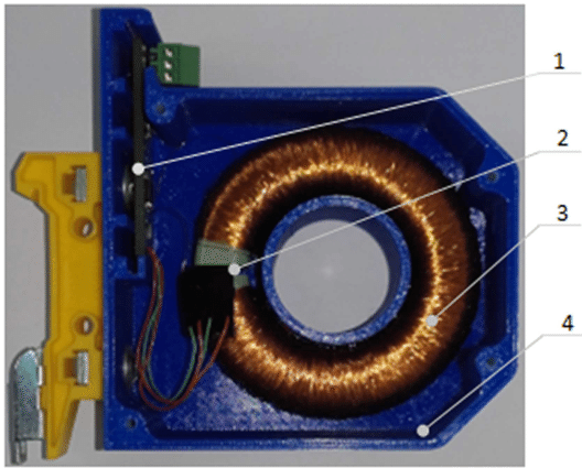

Ive looked at IC types but they require DC voltage to function. I like how this uses the current from the device passed through the cores winding. I mean im unsure how it uses that current and closes a switch. I found this device opened (file current amplifier...) but i cannot tell how it functions.

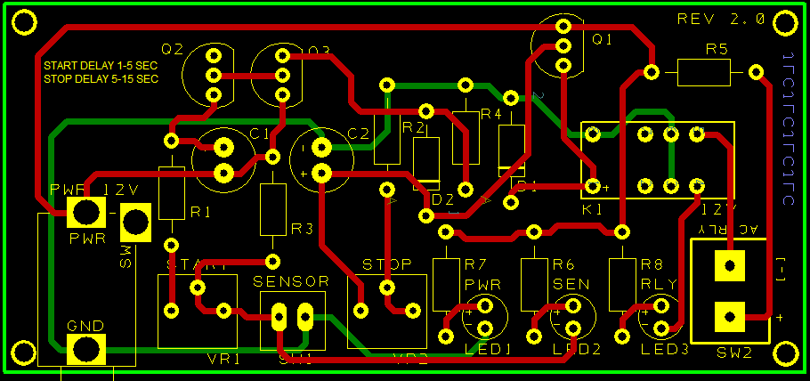

I will be connecting it to SW1 on pcb (file workshop)
This circuit (when SW1 is closed) will close relay K1 after a 0-6 second delay. when SW1 opens relay K1 will open after a 5-15 second delay.

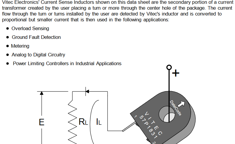

I located what i think i need to start. An Inductor. Its used for a range of conditions.
Would i be on the right track?
The above part by VITEC produces or transforms volts depending on how much amperage is passing through the center. I thought that process was called a hall effect. Now part 57P1831 creates .072 volts per amp. So a question would be what transistor or mosfet would i need to bring the voltage up high enough to trip a switch.? What switch would i use?

There are two different things here:
Traditional current transformers are a wound transformer, or a wound secondary and a hole for the primary wire to pass through.
They are AC only. They are most often used for current measurement, either feeding a lower current AC ammeter or a rectifier and load resistor to give a (rough) DC voltage proportional to AC current.
They are extremely dangerous if incorrectly used - they are normally supplied with the secondary shorted and must never be in a live power circuit without a secondary load, as the open circuit voltage can be ludicrously high, many thousands of volts.
The other style is an electronic current transformer.
They typically have a toroidal core with a gap in it, containing a hall effect sensor IC. Those need power and give a voltage or current proportional to the primary current.
Cheap ones just have a sensor, high accuracy ones also have a winding and an internal amplifier used to hold the hall output at zero, then the winding current is precisely proportional to the primary current.
(There is also a so-called "DC current transformer" system used in the 50s - 70s which is wound device that actually works as a magnetic amplifier, with the DC current affecting core saturation. It's nothing at all like the ones above).

The Current Transformer is 2 inches across. It looks like it I tried to make some thing similar using smaller CTs but the power level was too small. So stay with a 2 inch CT! If you can find one. CT Coilcraft I think this CT has a turn ration of 1000:1. I don't think you can get/make the CT for $7.50 with out the circuit board.
I pulled all the data I can find on " Hawkeye 800 " and it appears they use a solid state relay. SS relay

You assisted me with this workshop project a year ago. I made a few of these. You suggested that i look into hall effect sensors to trigger the switch. that led me the hawkeye800. i purchased it and applied it to the project and it worked well. I simply want to build something similar to the hawkeye800.
I currently use this in my shop now. A line from my chopsaw (9amp) is passed through the hawkeye and when i start the saw the hawkeye energises its solid state relay and closes its switch. two screw terminals atop the hawkeye are connected to SW1 of my workshop circuit which in turn close that circuit. Thats it.
