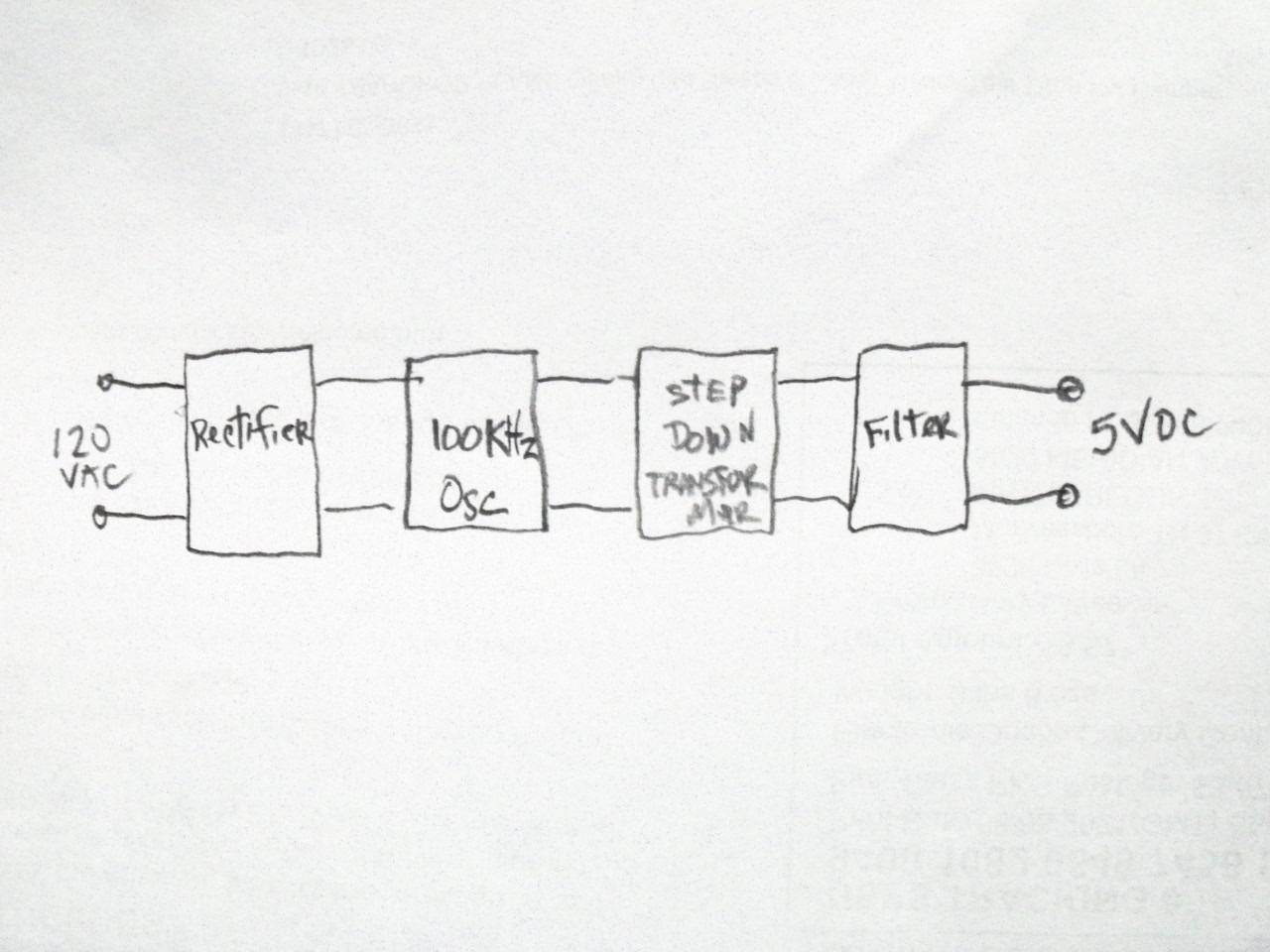

How does switch mode power supply work?
In switching power supply designs, the input voltage is no longer reduced; instead, it's rectified and filtered at the input. Then the voltage goes through a chopper, which converts it into a high-frequency pulse train. Before the voltage reaches the output, it's filtered and rectified once again.
Google says, 120vac is rectified to 170vdc converted to 100KHz then pulsed so ON time is very short then regulated to produce lower voltage. OK I understand that, it sounds easy, I don't understand the park where 100KHz 170vdc is regulated down to lower voltage?

How does switch mode power supply work? I did google search I found circuit drawing but no info how they work? My books are all 50 years old nothing there either.
Ancient TV's were live chassis and worked on either AC (various frequencies) or DC mains (historically both were used in the UK, as well as various different voltages) - so no transformers, and no chance of one as they had to be able to work from DC.
Switch-mode essentially converts the mains to DC, then converts it back to AC again at a MUCH higher frequency, this allows much smaller transformers, and allows easy regulation as you can use feedback to control the mark/space ratio of the high frequency AC. A later Thorn set, the 9000, was specified to work from 90V mains to about 270V mains, and many modern PC PSU's cover 110V or 240V with no change required.
In switching power supply designs, the input voltage is no longer reduced; instead, it's rectified and filtered at the input. Then the voltage goes through a chopper, which converts it into a high-frequency pulse train, which passes through a small high frequency transformer.
There fixed that for you.
I understand SMPS now. This will make a good project for me to build. Now I know what all these odd little ferrite transformers on circuit boards do.
120vac rectified to 170vdc then 100KHz then step down 17:1 and filtered = 12vdc

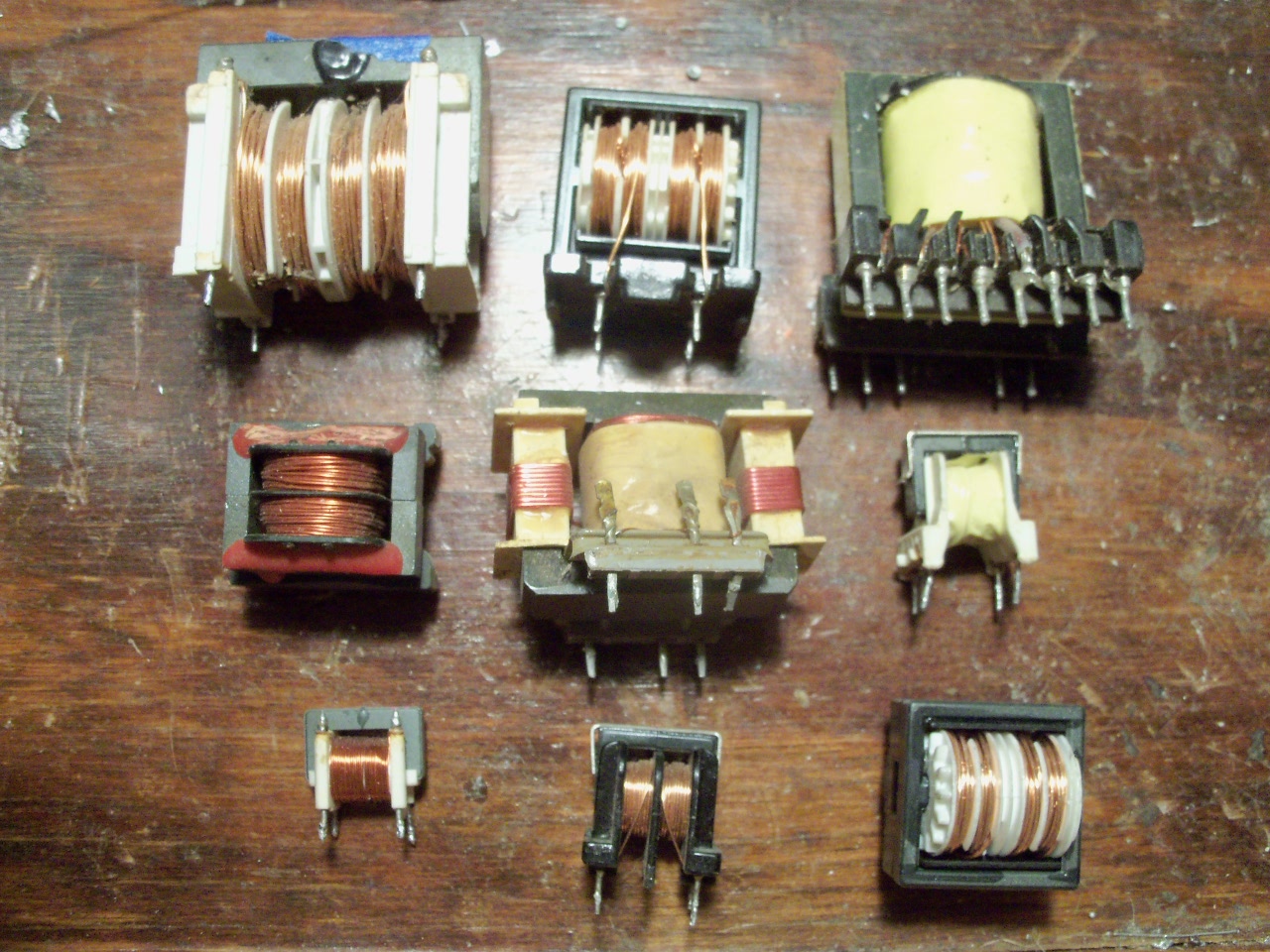

I have about 100 circuit board transformers I will look for something that will make a good project. I don't know how to determine power ratings for ferrite transformers but for a good lab educational learning project this will be fun.. I can rewind these transformers if i need to.

Only a small number of those are transformers, most are filters - the only one that looks like a transformer is the top right one.
I would VERY much suggest you don't play with them, it's fairly hazardous and pretty complicated - as you can't seem to cope with simple basic battery powered multi-vibrators I would suggest SMPSU's are well beyond your abilities.
If you really, really, want to - then take the rest of the parts out of the circuit you got the transformer from, and re-build it. SMPSU transformers are custom made for every application, as far as I'm aware you can't just go out and buy them ready made.
