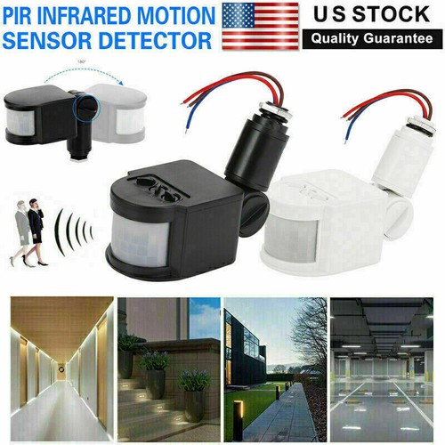

Just search "PIR Switch" on ebay, there are masses of them.
eg.
Just replace the PIR module on your existing light, or use one with whatever light you prefer.
(A lot show them controlling LED lights, but they are just AC in, AC out).

I bought a PIR from TX it will probably be here in 3 days.

PIR with 3 controls came today. The 3rd control is day or night. I set in a dark room for 20 minutes trying to get settings close. About 3 pm it was mounted on the wall. 8:35 pm its almost dark. Dials 1 and 3 are good. Dial 2 is set for about 1 min I changed it to 2 then 2.5. This PIR is more sensitive than the other PIR light attracts bugs very quick and bugs keep the PIR on all the time. PIR had to be moved 2 feet from light so bugs are not making PIR stay on.
