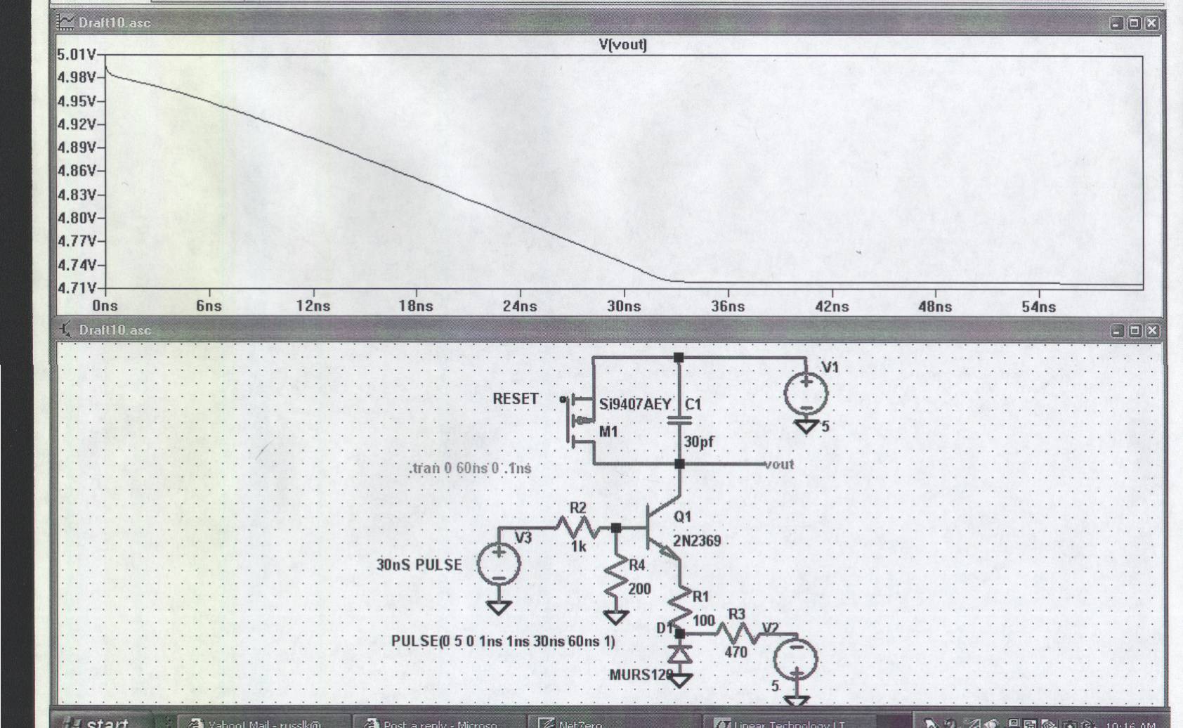

Use the pulse that you are trying to measure to generate a linear ramp. The voltage at the end of the pulse can be held long enuf to feed an A/D. The voltage is a measure of the pulse width. This is the idea:
I don't know why the picture doesn't show, it previews OK.

Russlk, I've been thinking a bit more about your suggestion, and presumebly I would want to control the discharge time from a microcontroller? Won't the resolution then be limited by the microcontroller frequency?
No, the micro is measuring the voltage to determine the time delay. You will have a sample and hold circuit to hold the voltage as long as the measurement takes. Of course, when dealing with nanosecond times you have to know all the delays in the system that are not part of the measured time.

I've been considering this very method, but hit a snag. The timing will be controlled by a microprocessor (running at 20Mhz for example) to start and stop the counter. If I use an external ECL counter running at a much higher speed, the net effect would be the same as using the mcu counter, multiplied difference in clock speeds eg x50 for a 1Ghz counter. The only effect that the external high-speed counter would have is effectively incrementing the counter by 20 instead of 1. The resolution will still be limited by the mcu in other words :? The same would be true of the linear ramp suggestion from Russlk, would it not?

You don't use a micro to control the counter, you use the actual PULSE to do so, you can use a micro to provide overall control though - enable the counter circuit to let it do a single count sequence, then read the data from the counters. Then enable it again for the next reading.
So the speed of the micro has no bearing on the speed reading.
