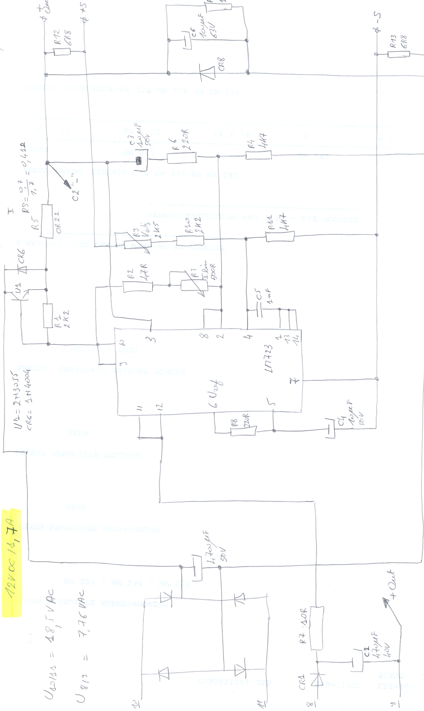

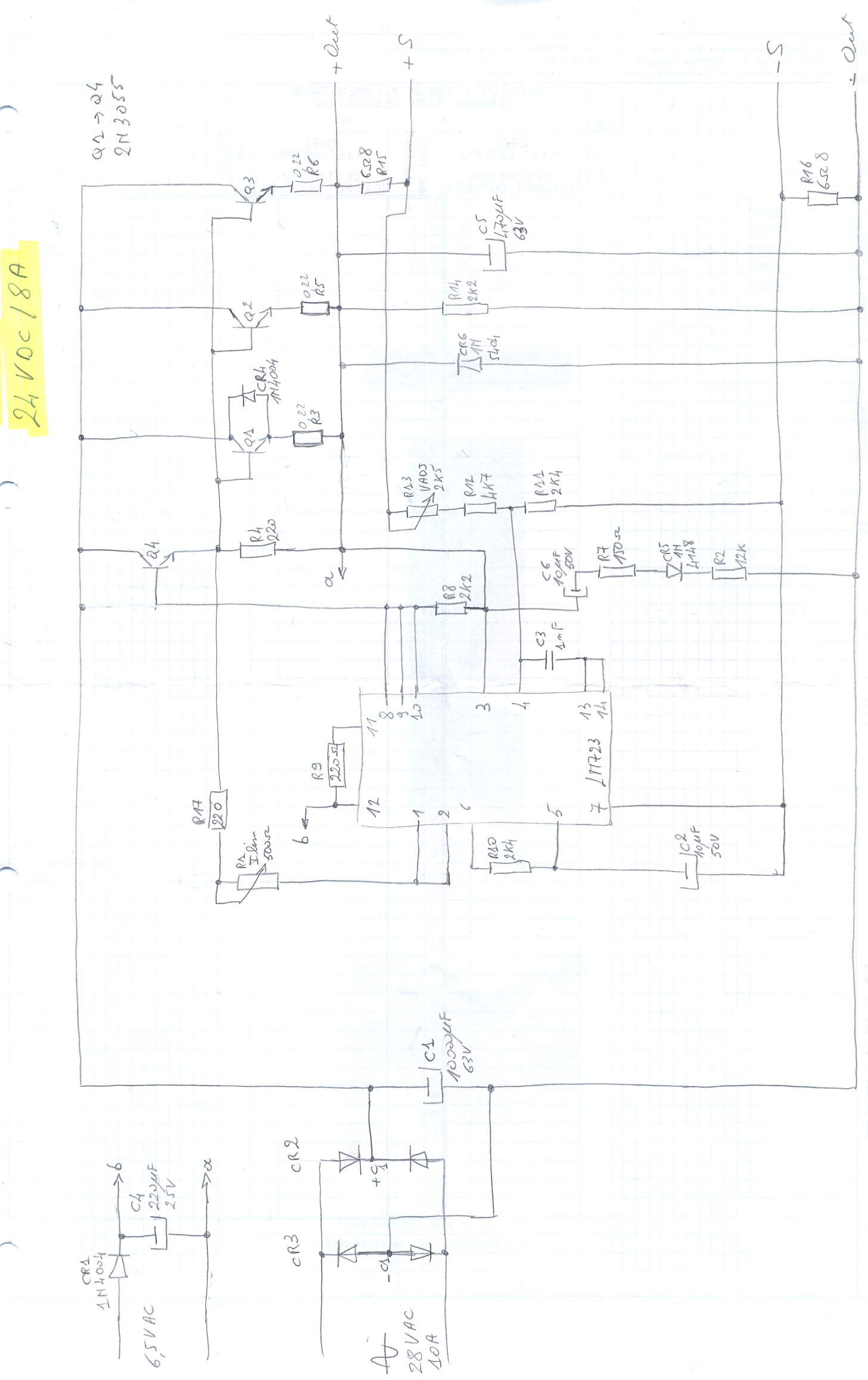

Still need some schematics?
Here are two:
one for 24Vdc/8A
one for 12Vdc/1.7A
I think you can adjust the last one to 3A by adjusting current feed back resistance. A 2N3055 can deliver up to 8A with proper heat sink of course.
You can also use the 8A principle to deliver max 3A in the 12V one.
Your choice :)

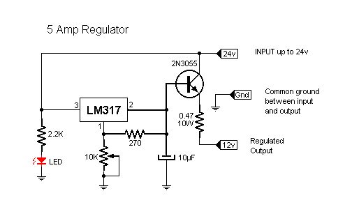

Here is a Handy circuit for 5 amps.
Use a LARGE Heat sink for High Current.

Regulators CANNOT be put in parallel to increase their rating. One will usually end up taking all the current.
What is your source voltage? There are a lot of thermal issues if you have say a 20V source. That would be 24W of heat!
You can always use an external transistor to create an emitter-follower circuit. The output will be 0.5v-1v less than the regulator's voltage. Yes the voltage will change a bit with load.

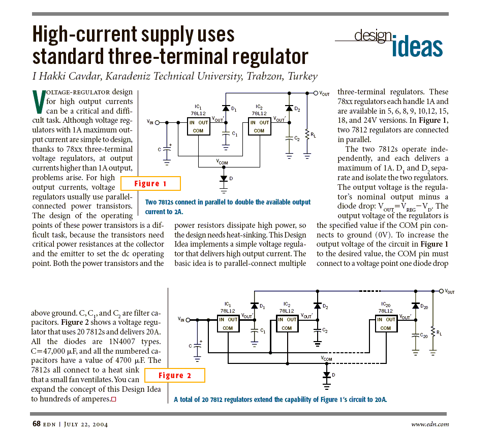

Hmmmm, If this is completely true explain these Articles.
  • Parallel Voltage Regulators.pdf
The article says that current sharing is poor unless resistors or diodes are added in series with the outputs of the regulators. The article says that current-sharing resistors cause a voltage drop of 1.5V at full load so the excellent voltage regulation of the ICs is ruined.
I'd just stick them in parallel (without any series resistors) if I were you.
Most voltage regulators lower the voltage and are protected from thermal run-away. For small loads the strongest regulator will source all the current, as the load current increases it will start to shut down and the slightly weaker regulators will provide the current.
