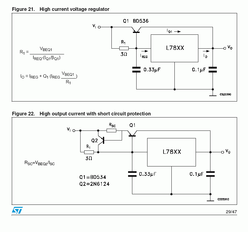

What is wrong with the circuit on page 29 of the Datasheet?

Fig22 indicated by Hotwaterwizard is fine and i was using one and it worked well
