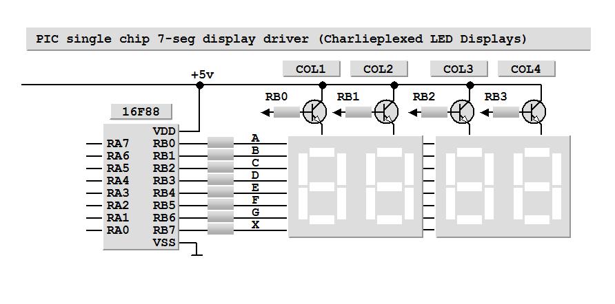

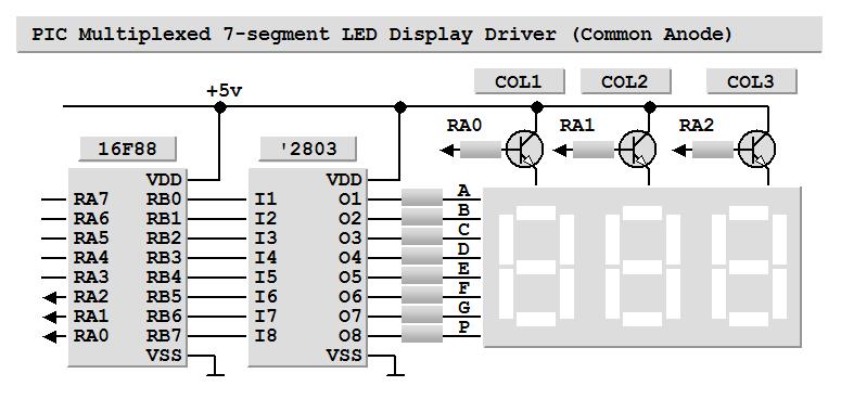

Much easier, less hardware, provided you can write the software and program it into the chip. Plenty of pins left over for 'set' switches and for the "down count" switch input.
Good luck. Have fun. Regards, Mike
<added>
The 1-chip Charlieplexed solution is more a 'novelty'. The 2-chip multiplexed solution, or 1-chip with segment driver transistors, uses more PIC pins but provides a much brighter display.

yup it could be done easy with a PIC and a LED driver from maxim. Anything up to the PIC12XXX serie would be enough depending how many i/o you need.
Could also be a bigger PIC without any extra Driver, no multiplexing and plah plah.
MikeK8LH:
Charlieplexed? I like it :) .. I have done that, just did not know Charlie beat me to the naming rights.

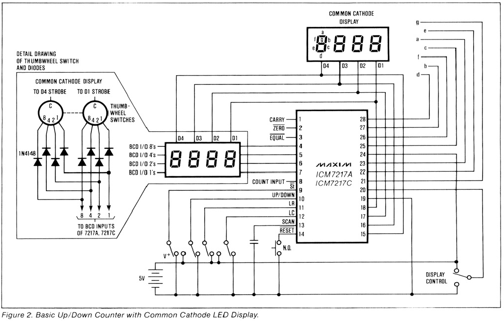

Sorry for the late reply. The Maxim ICM7217A is not a PIC but kind of a hybrid of four 4510s and four 4511s all in a single package. It directly drives the display segments (no resistors) and common cathodes (no trasistors). Here's one of the application examples from the Data Sheet which shows Thumbwheel switches to load the counter as well as an Up/Down switch, a Load Counter switch, etc. Pretty much a single chip solution.
Have fun. Kind regards, Mike

Thanks that looks great! Yeh its not what I asked about originally but I didn't think I would be able to cope with much more lol, this should be ok for me. Not actually homework in this case, I didn't know about this forum when I was doing my AS :p ...less than a month until results day, hope I did good in electronics, want to take it next year too.
Anyway thanks again for all the help guys :)
EDIT: Ok, I was just having a look on that link to the Maxim site, I can't see a "M7217A" listed on that page? Also I typed "M7217A" and "MAX7217A" in the search bar but got 0 results. Am I using the wrong name for it?
The part number is ICM7217A. The datasheet is here.
