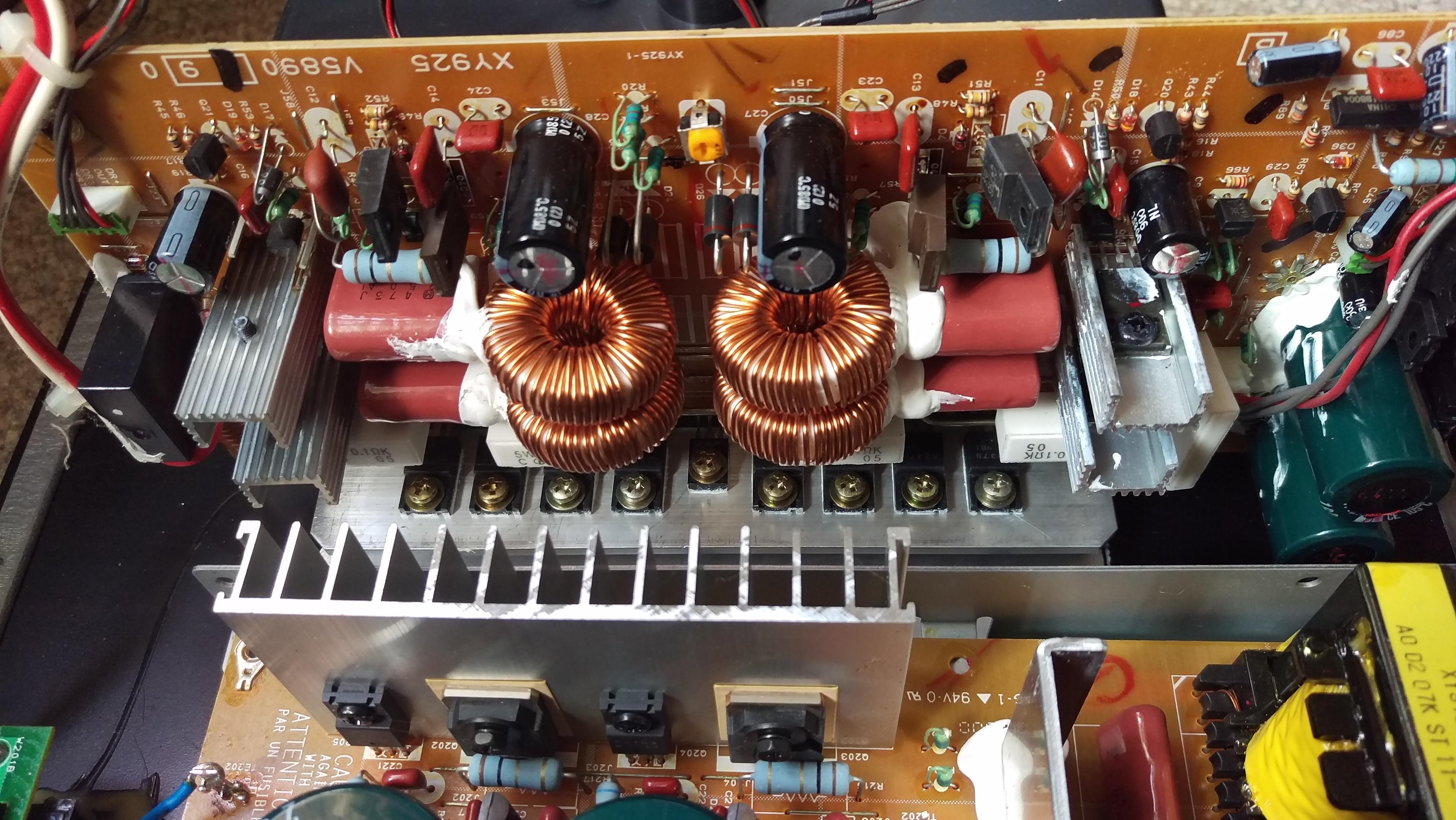

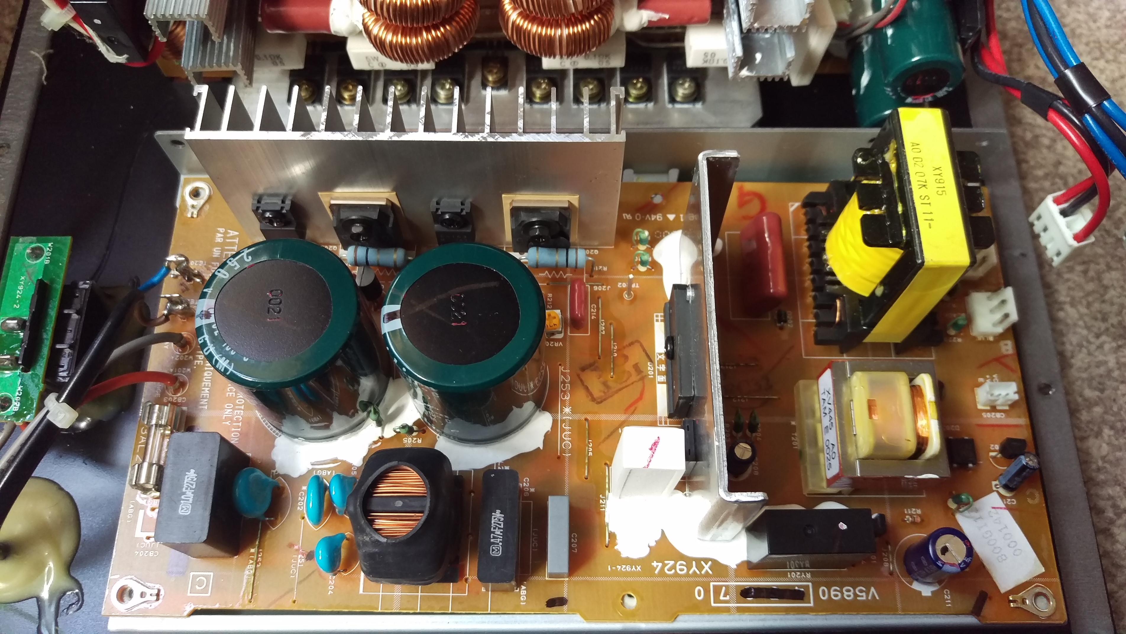

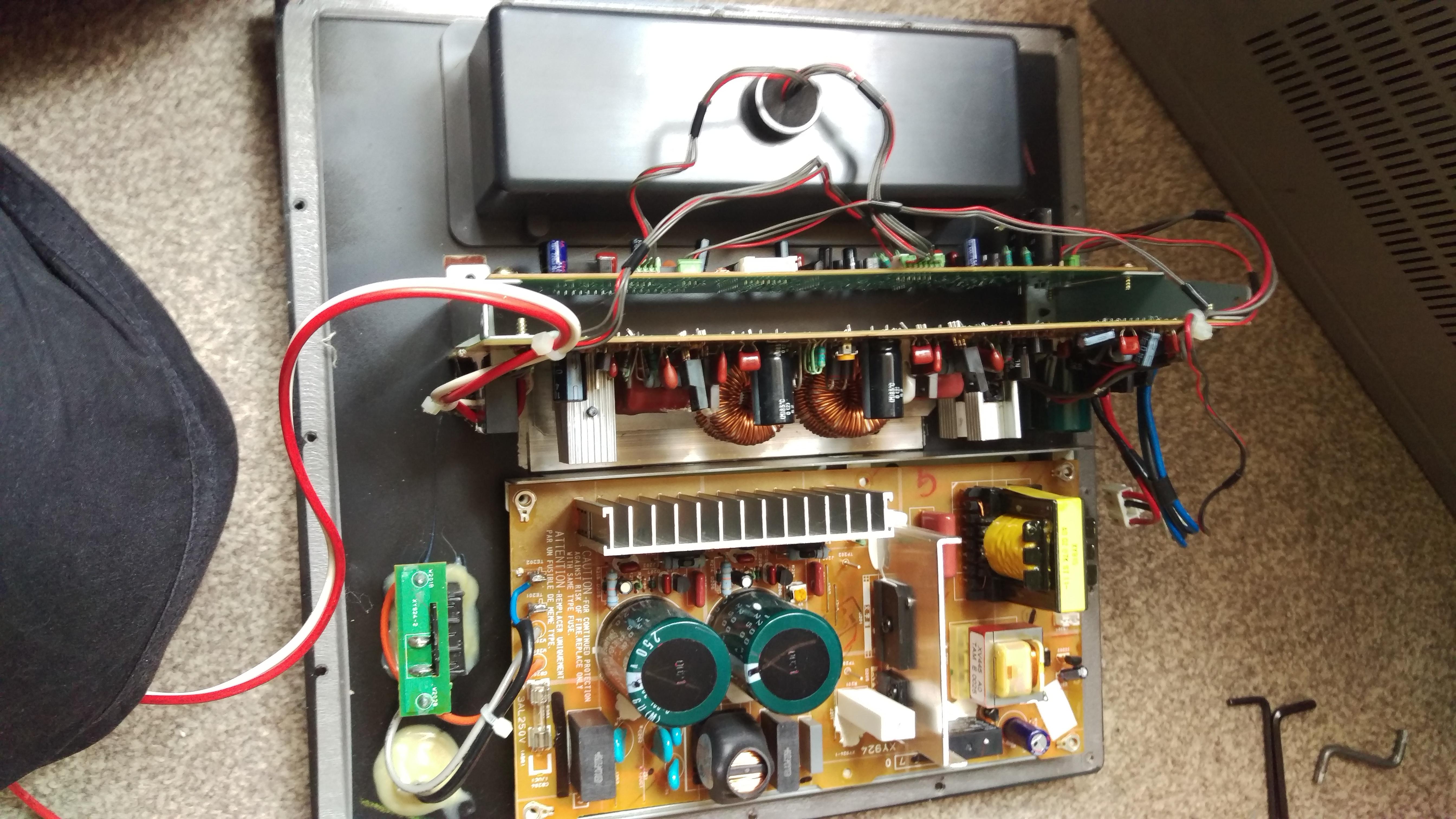

Hi, in short I have this sub X2, 1 went bad a year or so ago, powers up but has no sound, but I bought another quite cheap. However just now it was ok, I left the room and heard a loud pop, as if the relay shut off louder than normal. Now there is no sound at all and the relay will not switch on as the same for the other sub.
Both fuses are ok still in both of them, just do not know what to look for, I guess swollen caps? And burnt, dark patches?
Any help would be appreciated...
Swollen capacitors (or low-ESR ones) are mostly associated with switch-mode power supplies, does it use a switch-mode PSU?.
The loud POP, and now not coming on, sounds more like an amplifier failure.
Hi Nigel, I was hoping it wasn't that. I believe it is a switching mode PSU. Attached a few pictures of it.
The fuse didn't blow, but, should I now check all the caps, transistors just incase? Nothing looks swollen.
I read if the base is defective and not the emitter (if they are bad) then the voltage backup through the circuit is very bad...

Randomly checking components isn't a good way to repair anything, although it's an easy way with SMPSU's to check the electrolytics before you do anything else. However, you MUST use an ESR meter (with the unit unpowered), or a scope (with the unit powered).
But easiest thing to do first is check the voltages in the amplifier outputs - assuming it's spilt supply? (which is likely) then there should be high positive on one rail, high negative on the other rail, and the output to the speakers (before the relay) should be zero or very close to it. The relay is there mainly to protect the speakers in case of amplifier failure, where the output of the amplifier will probably have a high DC voltage on it (which is death to a speaker).

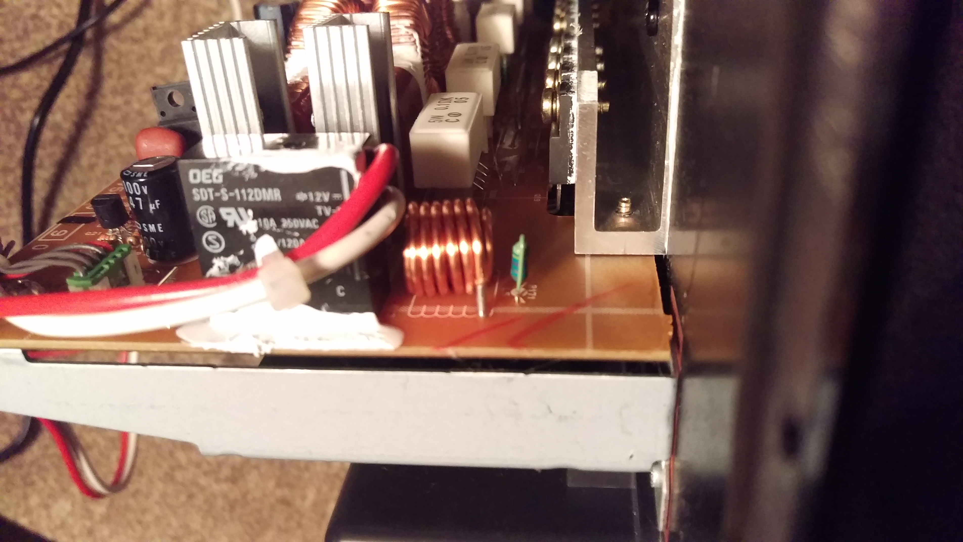

I've just downloaded the service manual, there's an inductor (L5) with a resistor (R171) in parallel that feeds the speaker (before the relay), those should be simple to locate - check the DC voltage on them (from chassis), with the amp turned ON. It should be zero volts, or very close - anything more than a few 100mV shows the amp is blown. DC coupled amps aren't trivial, the slightest mistake is like a chain of dominoes, and if you don't replace all faulty parts, then as soon as you switch it on it all blows again.
I can't get to the resistor in circuit to measure it without having to take the board out... If I do, the transistors wont be touching the thermal paste on the back plate.
In picture 1230 the inductor looks easily accessible, chassis is any of the metal chassis work (which is 0V), the metalwork immediately below the inductor would be fine.
