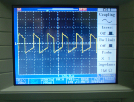

I measured the output waveform of Pin 25 (TX) of my PIC 16F877A using an oscilloscope and I got a constant waveform (as attached) and not the expected ASCII waveforms of 0x59 and 0x4F [b0101100101001111] for everytime i input a high voltage to RC0
prior to this i just tried outputting 1 data at a time and i still got the same output.
Is there any reason why this is happening?
Thank you..

Does that even compile. The line
unsigned char data[2]="Y","O";
is trying to put 4 characters into a 2 byte array.
It should be,
unsigned char data[2]={'Y','O'};
//or
unsigned char data[3]="YO";  // = 'Y','O',Zero
Also, you are randomly sending 'Y' and zero because you use if instead of while not.

i modified my code accordingly as u said . This time the output generated a similar waveform to the previous one except that now the square wave is smoother..(view pic)
the expected waveform(in binary) is
0(Start) 01011001(Data) 1(Stop)
0(Start) 01001111(Data) 1(Stop)
TOTAL= 20 bits
however i got the waveform of a continuous square wave exceeding way over 20 bits . I guess there's something wrong in the implementation of my code? this is my code modified.

There is no while loop, just a while statement.
while(...); is an empty loop and will just wait while the condition is true. Note the semi colon on the while line.
while(TXIF) will wait while TXIF is 1. We need the opposite and so use while(!TXIF);
The reason you see a continuous square wave is because the data is being sent repeatedly.

after inserting the delay, i got a waveform of 3 byte frames as follows:
(UART sending from LSB to MSB)
1011010011 1111110000 1 100110101 0
(The part in bold resembles 0x59 that i assigned for ASCII 'Y')
the other 2 bytes seemed to get muddled up and I only sent 2 bytes out...
however, because i had to keep RC0 "HIGH" for this to happen so im guessing that
1. Im not getting 3 bytes but actually a consecutive repetition of the 2 bytes which results in:
2. the waveform getting muddled up..
referring to this part,
for(count=0;count<2;count++)
out=data[count];
while(!TXIF);
TXREG=out;
DelayMs(250);
at the point where the delay is executed , im assuming the line be held back to a 'HIGH IDLE' state before the next byte is transmitted?
therefore when observing the output on the scope, i have to take into consideration an additional couple of parts of the waveform where there will be a continuous stream of Logic 1's during the delay?
so i guess the best way to test UART transmissionis by using hyper terminal or to another PIC..
is my understanding of the matter correct?

I think you will get the best results looking in hyperterminal. You'll need to hook it up via a max232 to get the correct levels.

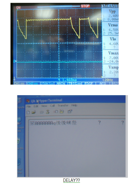

sorry for the late reply as i have been extremely busy..
I have interfaced the PIC to Hyper Terminal via MAX 232, I sent out the ASCII character A in an infinite loop from the Tx pin.
I noticed the waveform on the RS-232 output pin of the MAX -232 (PIC ATTACHED)
Logic 1s on the waveform seem to be spiked and do not resemble a perfectly undistorted square wave..Are RS-232 waveforms meant to be like that? Or could it be noise generated by the MAX 232?
However, I managed to get the desired output on Hyper Terminal...Some of the characters got distorted though( PIC ATTACHED) .. Could it be that I have to insert a LONGER delay between the transmission of each byte?
The MAX232 is not providing the current required to drive your PC input. It probably means that the capacitors (on the data sheet page 17, C1 thru C5.) All capacitors must be 1.0µF or greater. I would say anything between 1.0 and 10µF is OK. Polarity is important. To confirm proper operation, make sure the voltages on pin 2 (+10) and pin 6 (-10) are OK. Anything from 8V upwards (during transmission) indicates that it's working.
the capacitors used are 1.0uF using MAX232 (Not 232A)...anyway ill give pin 2 and 6 a check on the DMM when i get back to the lab..thanks!
I have seen high ESR capacitors causing problems. The problem was on a MAX202, but the principle is the same as your MAX232. The caps must be low ESR. In that case the designer thought that cheap 10µF electrolytic capacitors would be better than the 0.1µF ceramic in the MAX202 app notes. He was wrong.
Tantalums might work well.
