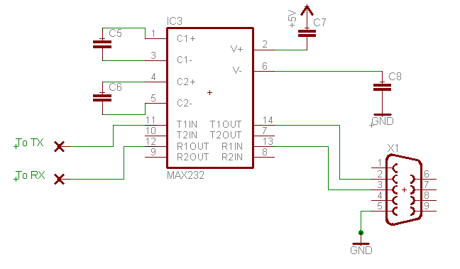

the bytes on the scope came out as expected..however when i connected it to hyper terminal, 4 bytes came out but are not AT <carriage return><line feed> but some jumbled up characters..im guessing that its a problem with my max232 converter cuz the pk to pk rs232 waveform converted by the max232 is only about 4Volts...

That code works fine. You probably didn't see anything on the scope because it was too fast with the delays removed. However, you can't keep the delays as the phone will reply during the delay.
Before going any further you should get it working with hyperterminal. Check you have the right baud rate, start/stop bits, parity etc. I assume it should be 9600,n,8,1.
If that is correct then double check your wiring of the MAX232. See attached.
Edit, a 5V power supply also needs connecting to the MAX232.

based on ur given max232 diagram, it appears that caps C5 and C6 on your diagram are connected in reverse polarity to what is stated in the datasheet. is the datasheet connection wrong? i tried both connections but my pk-pk value is still 4V+..i even replaced my old max232 with a new one i bought just now...still 4V pk-pk
http://www.datasheetcatalog.org/datasheet/maxim/MAX220-MAX249.pdf
The caps aren't polarized, they are 1uF ceramics. If you are still seeing only 4V then I would suspect your power supply isn't up to the job.
i have identified the problem (my breadboard connection oversight did not power up the max232) thank you so much for your help=)
