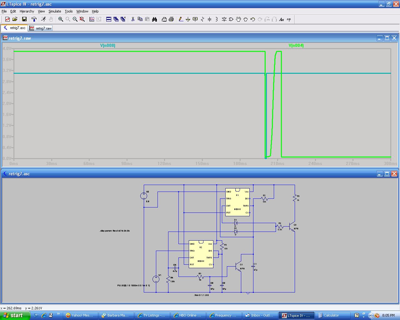

Here's something else to try. I used a second 555 timer, because if you sensor can drive one, it should be able to drive 2. You can get a dual 555 in a single package, it's a 556. The 2nd timer is set to produce a short discharge pulse to start the time cycle over for each pulse received from the sensor.
I would have suggested something like this from the beginning, but I didn't anticipate the problems with our simpler drivers. Live and learn.
PS: Before you go to the trouble to build yet another circuit, it might be a good idea to measure the output capacity of your sensor. You'll probably need an oscilloscipe to do this. Beg, borrow or steal one. This is the way engineering should be done. Guessing sucks, as you have learned.

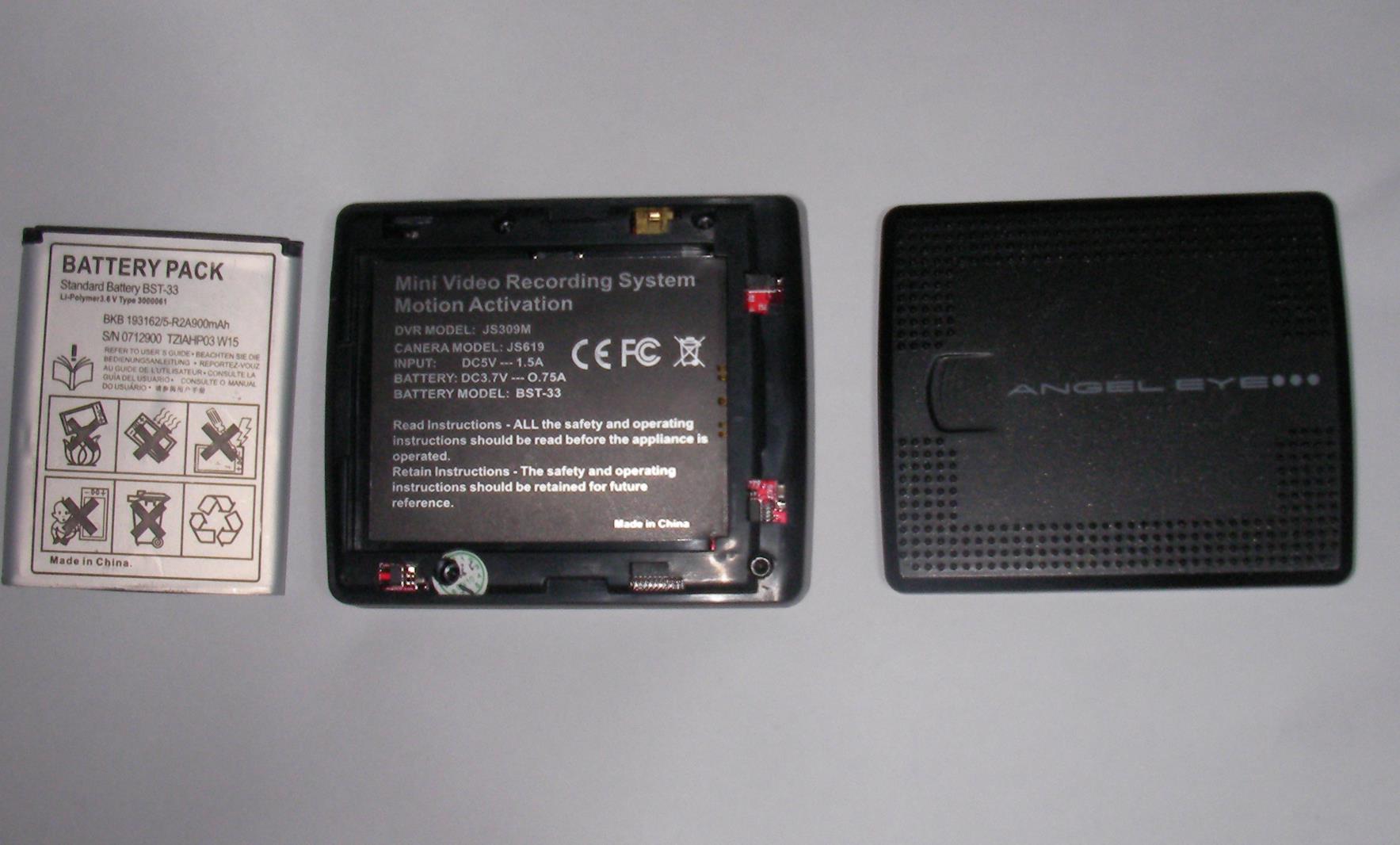

While I was testing it I noticed an inconsistancy in the commence recording cycle, for some reason best known to the manufacturer/designers if the LCD display goes into standby, then it ignores the first motion input, and simply turns the LCD display back on awaiting another motion trigger before it starts recording!!
This isn't so much an issue when it will accept a new trigger every second or so, but once the timeout is triggered it won't accept a new trigger untill motion is no longer sensed and the timer has completed it's cycle. Then it will commence recording if it is re-triggered.

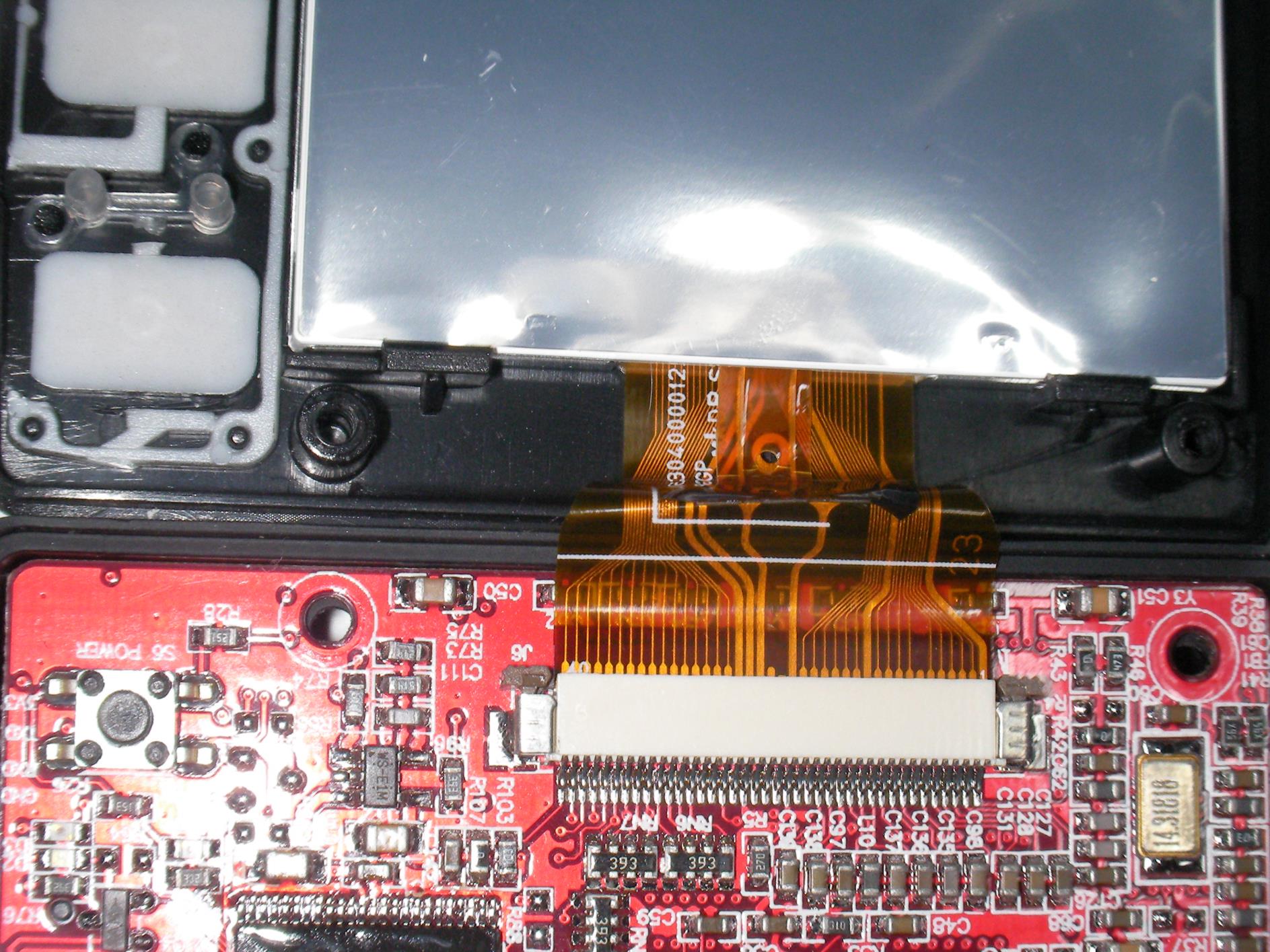

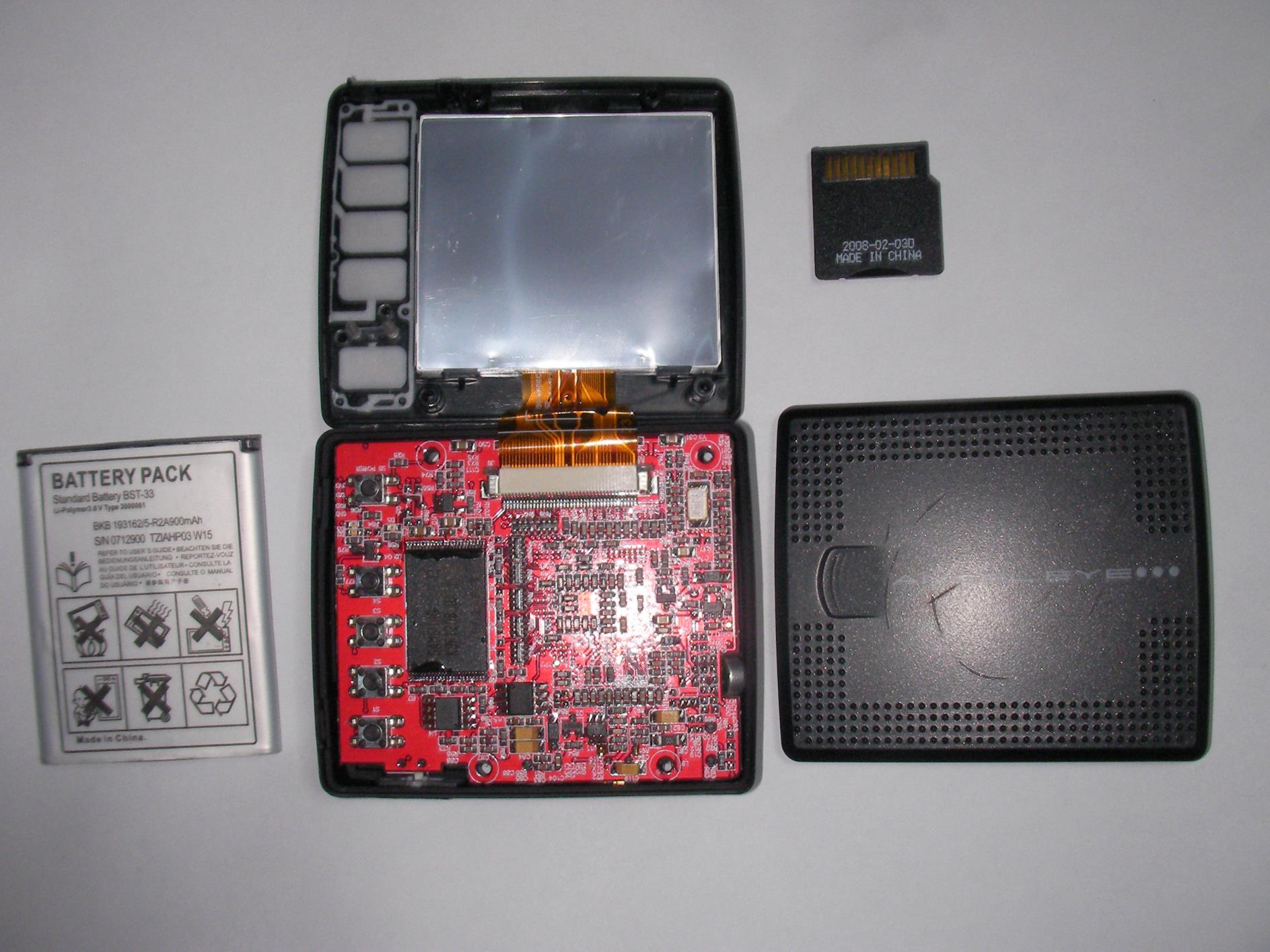

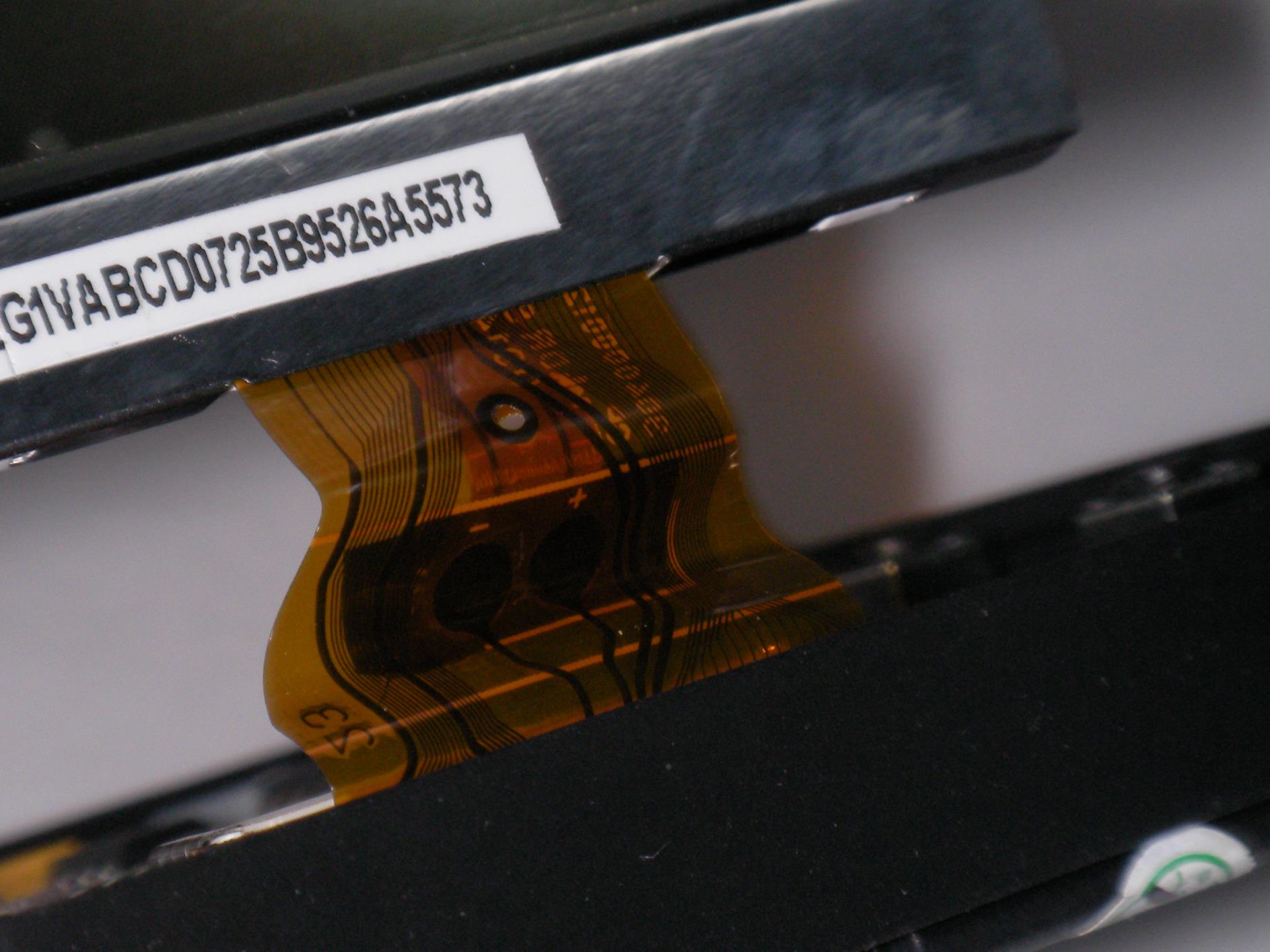

I don't think putting a manual switch on the LCD display is going to work, I did take the DVR apart but as you can see from the photos, it's the usual ribbon/tape connection to the display, which I would destroy if I put a soldering iron anywhere near it!!

Attached are the photos of the internals.. right before I took a lump hammer to the whole thing :mad:

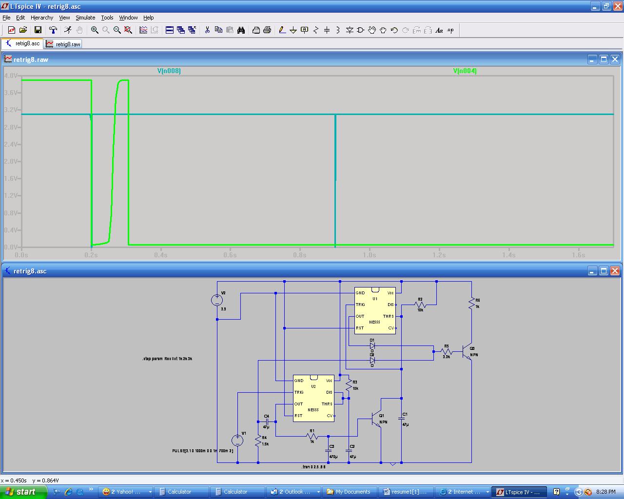

If I understand the issue, there should be an easy solution without another timer. All it needed is a short "wake up" pulse. We can simply hold off the timer for a few mS while we pass the signal straight from the detector to the recorder. The detector signal wakes up the recorder, then the timer signal kicks in a few mS later to start the recording process. What do you think?

Here's what I'm working on. Look at the waveform. The pulse triggers the circuit at 1 second. The output is a short pulse followed by sustaned low level. The initial pulse wakes up the recorder (hopefully) and the sustained level controls the recording. There are 3 critical timing nets that control the pulses. First, R1 and C3 delay the triggering of U1 to allow time to send the wake up pulse. Second, R3 and C2 ensure there is enough time for the delay and the subsequent trigger for U1. Last, C4 and R4 terminates the wake up pulse in time for the output to return to a high level, before U1 fires. Please study the circuit and let me know if there is anything that isn't clear. It may be required that the 3 timing nets by "tweaked" to get the pulses correct for your recorder. We can streach or shrink each of these pulses as required.
I have more testing to do on this circuit before you try it. I'll continue testing and let you know when I have confidence.

Looking good, my main concern was the 5mS pulses in the waveform shown maybe too short.
I've tried to test this by manually "dabbing" connections to replicate a trigger by removing the output (Collector Q3 NPN transistor) in this sequence ON OFF ON OFF as fast as I could and that did successfully wake the DVR and then start recording, so now I'm reasonably confident fairly short pulses should do the trick.

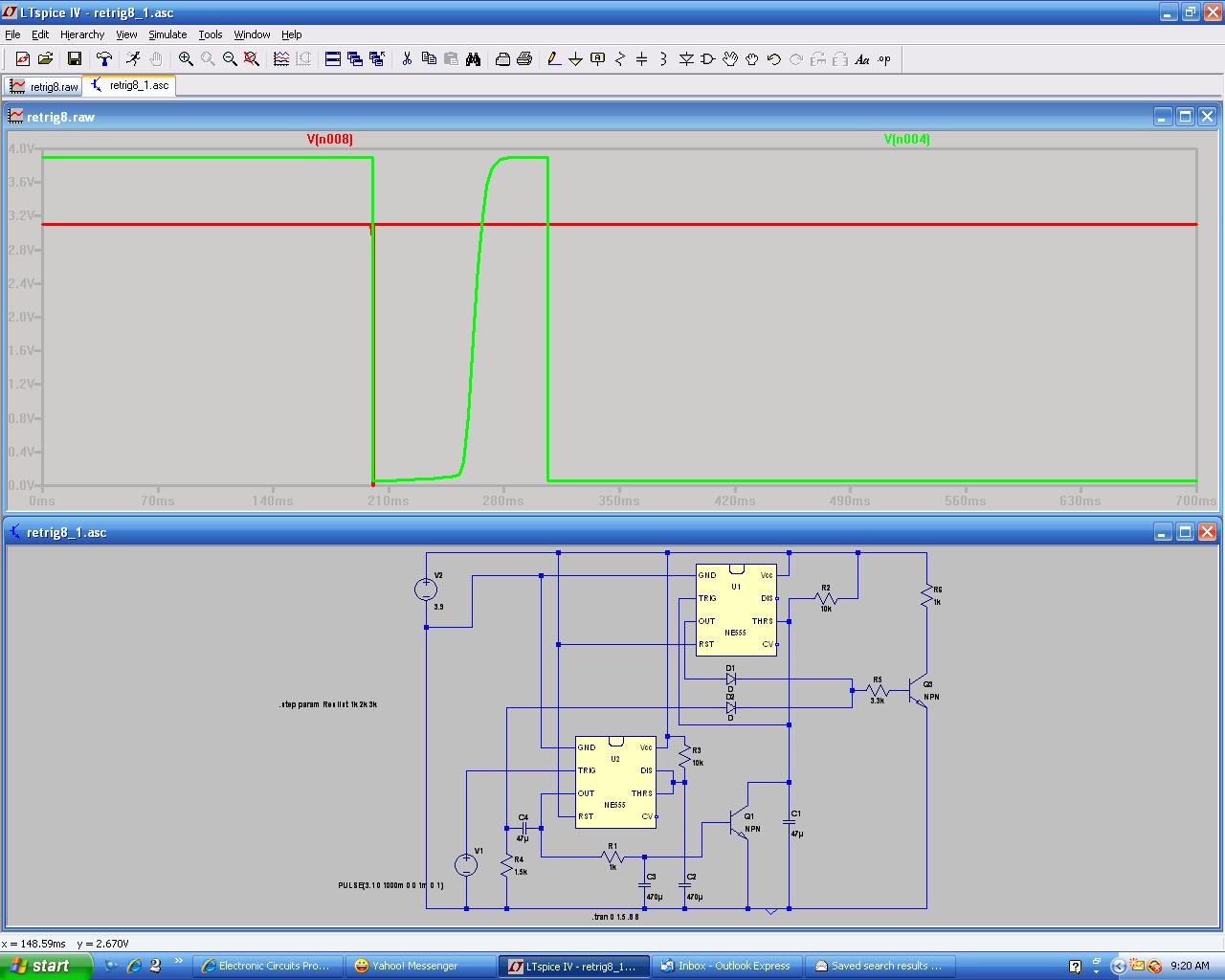

Well, at least all the timing nets can be scaled together. Here is a modified pulse of about 50 mS, uning linear scaling of the 3 time nets discussed above. Still testing...
EDIT: We might want to replace the diodes and output transistor with integrated gates. You might have to lose your resistance to them. :)

Here is the final version, fully tested. I made one small change from the previous one. I wish I had time to breadboard this, becuase some of the timing is a little tricky. If you can't get this to work, I'll make some time to build and test the "real" circuit.
EDIT: You may change R1 and C3 to 10K and 47u respectively if you wish, just to make part ordering easier.
I hope only one wakeup pulse is needed; otherwise, we're screwed.
