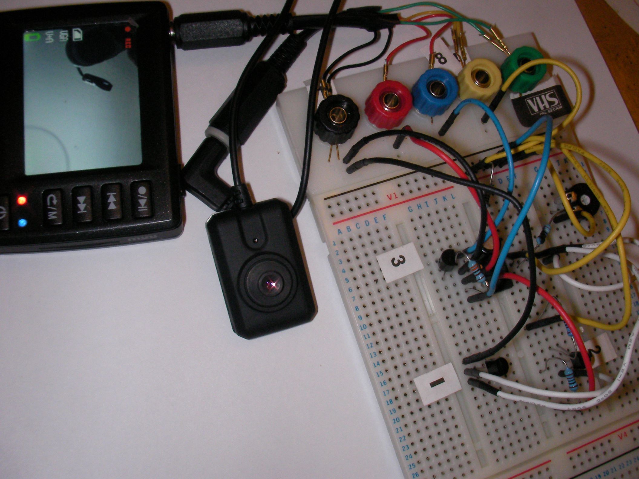

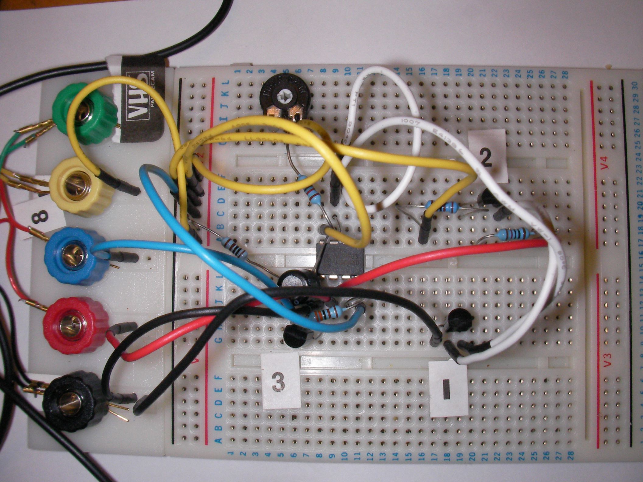

I got the parts, but I'm sad to say the circuit doesn't appear to be working. :(
I took the output from the circuit from the area where you wrote "Out" ie between R6 and Q3.
I can't see any glaring mistakes, on either the circuit diagram or the connections, but I'm fairly tired at the moment so I could be over looking something obvious.
I'll attach two photos of the circuit on the breadboard to see if you can see anything, but the photos just look like a jumble of wires so I doubt if they will help..
Cheers
Al
EDIT: forget to mention with pot set at 650 ohm, turn unit on it goes into sensor mode, but after approx 4 seconds it starts recording regardless of whether of not there was motion sensed.

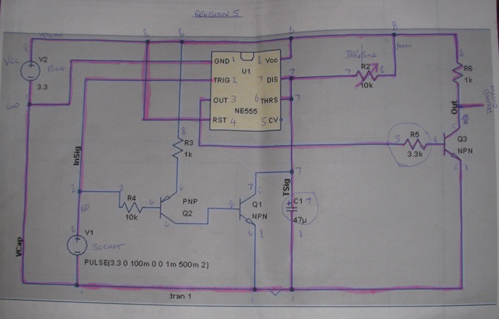

This circuit should be exactly as the one you built the first time, but with the additions of Q1, Q2, R4 and R3. Pay very close attention to the orientation of the transistors, especially Q2, as it's going to be connected reverse of the other two. I would also suggest that you remove the additional components, build and test the circuit identical to the one already working. Once you're satisfied that the "original" design is working, then add the new components.
aha, I didn't realise it was mostly the same circuit.. I've totally reconnected everything, and the "original" circuit works exactly as before.
So far so good. but the addition of the extra components performed exactly as the first test, ie straight into record mode after 3-4 seconds approx and not turning off.
I've added a revised circuit diagram but no changes from yours BrownOut, just highlights the old and new components.

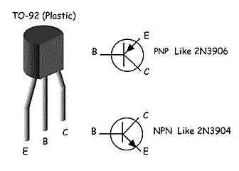

I've rechecked the circuit and the only suspicious area is the PNP transistor connections, simply because I'm not familar with the connections.
So correct me if I'm wrong, the 2N3904 NPN transistor and the 2N3906 PNP transistor seem to connect the same pins C-B-E where flat side down, curved side up, the left pin is C, the centre pin is B, and the right pin is E.
On the circuit board the PNP Q2 connects..
to the centre pin B via a 10kΩ resistor to the trigger voltage and 555 pin 2
to the right pin E via a 1kΩ resistor to Vcc or 555 pin 8
to the left pin C to NPN Q1 pin B
which seems all in order.

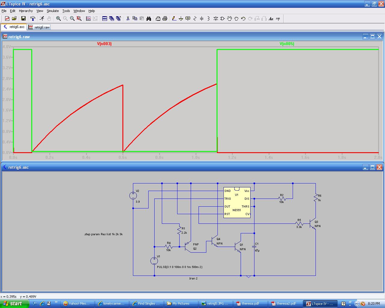

The attached circtuit adds R1, a 2.2k ohm resistor, and q4 to the circuit we've been working with. R1 pulls the base of Q2 up so that it is in cutoff when there is no motion. q4 makes up for loss in gain of Q2 because of the resistor R1. Try this circtuit. It simulated successfully with the input at the level you're using.
It doesn't appear to be working, it just sits there not seeing motion, which translates as there is a voltage permanantly on terminal 2 on the T555 I would guess.
Which if you look at the circuit, R1 (2.2kΩ) sits between terminal 8 (Vcc) and terminal 2 via R4 (10kΩ), which basically means there is a direct connection between t2 & t8 (3v+) with 12.2kΩ seperating the two, so terminal 2 is unlikely to ever see 0v.
At least that is what it looks like is happenning to me.
Removing R2 makes the DVR record in the exact same way it always does without the circuitry, ie no time delay when it doesn't sense motion.
Any ideas?
Why remove R2? Do you mean R1???? To say there is a direct connection with 12k ohms between is a contradition. 12K ohms is alot of resistance, so the connection is not 'direct.' If removing R1 makes the circuit 'work' then the output resistance of your motion detector is seriously high! Logic output is typically in the 50-ohm territory, and should by nothing with connected to 12 K ohms. Is it possible to measure the output voltage of the motion detector? I just can't believe it can't drive this very high resistance.
EIDT: Re-read your post. You're concerned about pin 2 reaching 0V. Don't be. It only has to get to VCC/3. In this case, 1.3V. It should make that easy, if the output impeadance of your detector is reasonable.
One more thing, take a jumper and quickly temporarily gound pin 2 and tell us what happens. Thanks.
