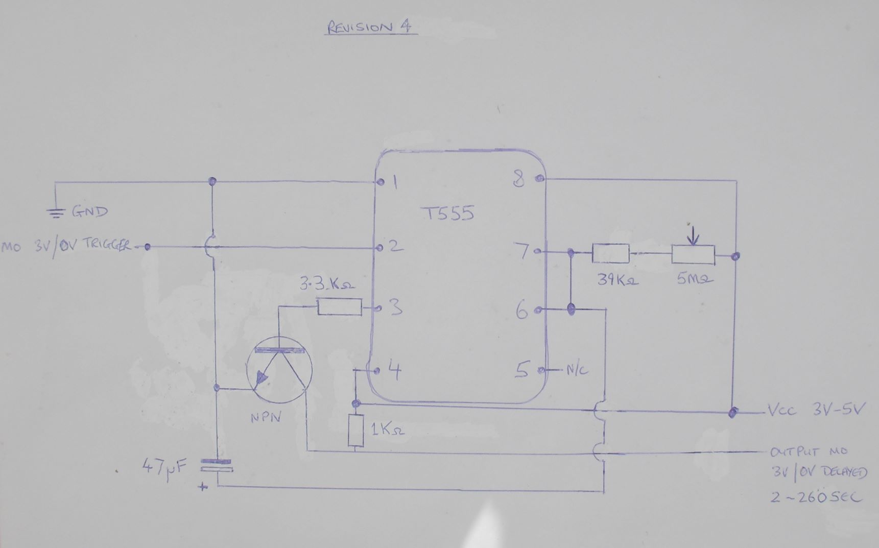

Circuit Drawing No4

Here's the latest drawing with the updated resistors and diode removed..
and the latest parts list..
Resistors: 39KΩ, 3.3KΩ, 1KΩ

Very strange, absolutely no change in the performance at all!!!
I figured it would either work or not work, but to have not changed anything is weird!!
So I guess that would indicate no resistance between Terminal 2 on the T555 and the output signal on the collector side of the NPN.
The potentiometer is set to 1.1MΩ which should give somewhere in the 60second delay if it were working I think, but it's still under 1 second. Adjusting the pot makes no difference to the delay either way.
I will totally recheck the circuit connections later today, but can anyone see a reason for this not working based on the circuit diagram?
Al
Your variable resistor is connected incorrectly. The wiper need to be connected ( the part with the arrow, which you show is not connected.) Connect the wiper to the 39K Ohm resistor. Sorry I missed that detail before.
EDIT: Double check the connections for the timing components, the variable resistor, 39K resistor, the 47uf capacitor, make sure of the value and orientation of the capacitor. With the variable resistor connected as drawn, you should have observed a maximum time delay. You're reporting a minimum one, which indicates to me you have a problem besides the variable resistor. Make sure you know the pinout of all your components.

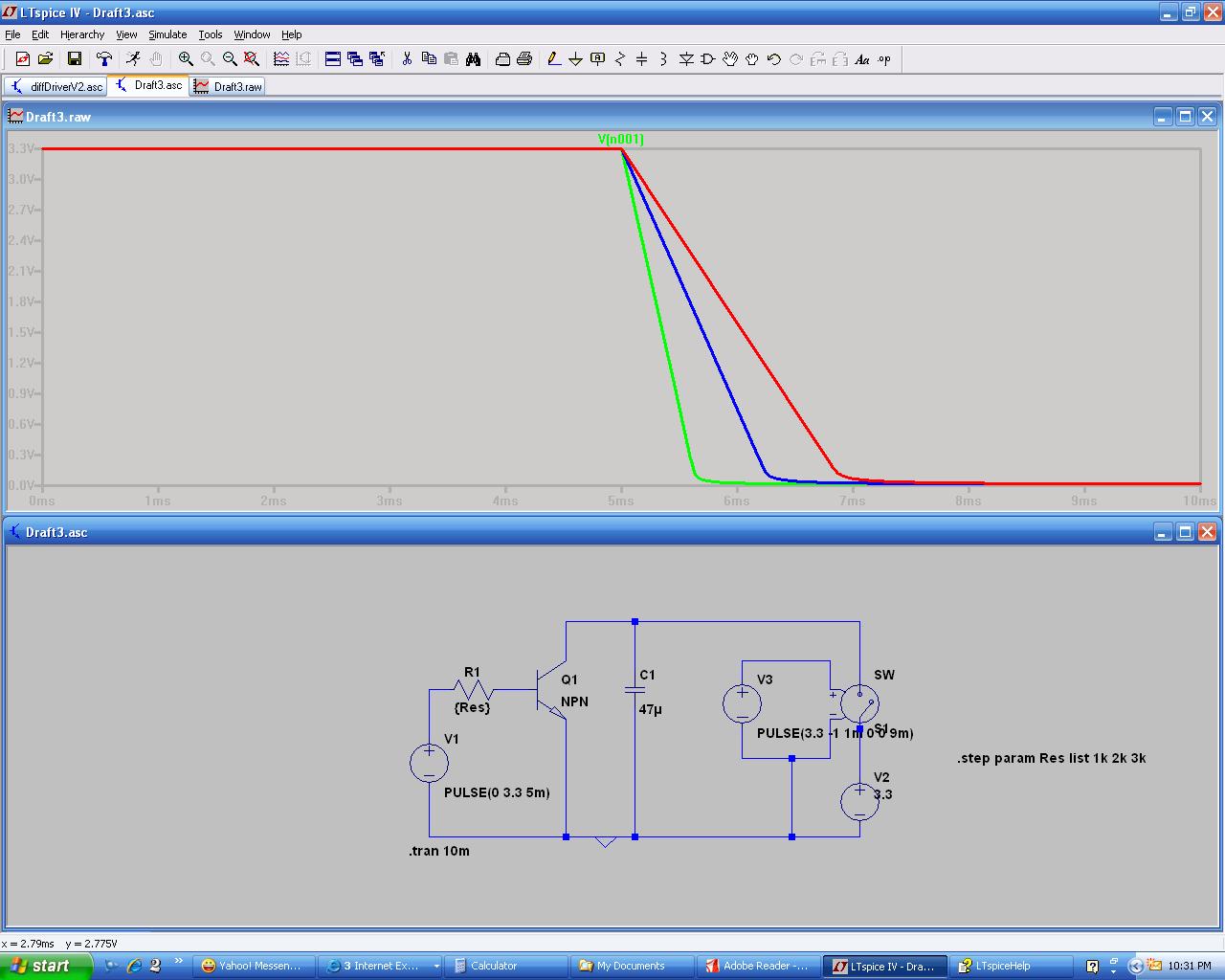

EDIT: if your signal from the motion detector is 100 mS or so, you could get away with just the transistor. In the attached diagram, the 47uf capacitor represents the same as in your original circuit. The waveform shows how the capacitor discharges for base resistances of 1k 2k and 3k. The cap can be completely discharged ( ie the timer is reset ) for a pulse of less than 100mS if the base resistor is 1k.

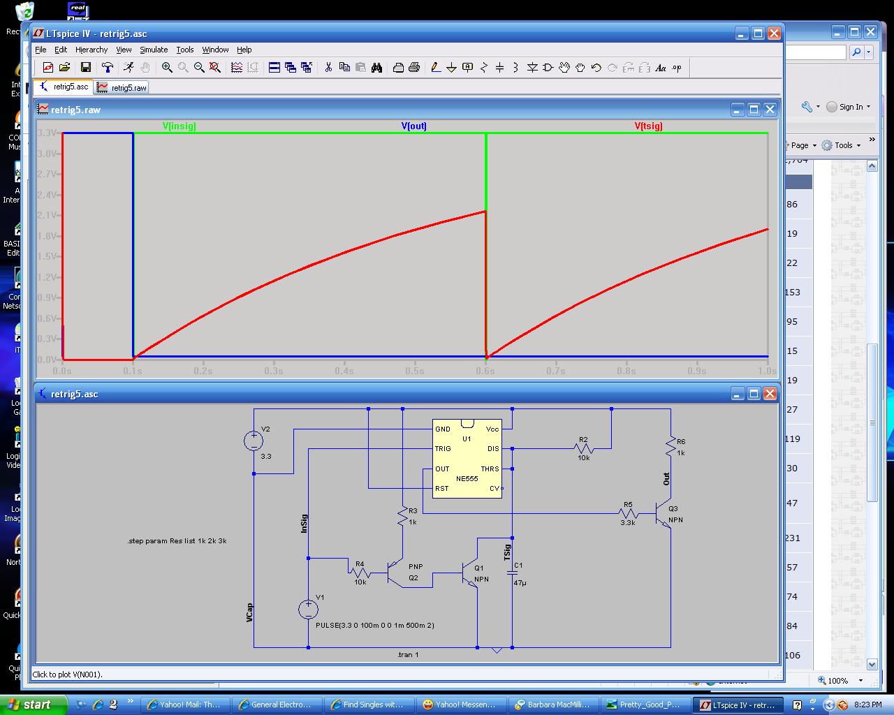

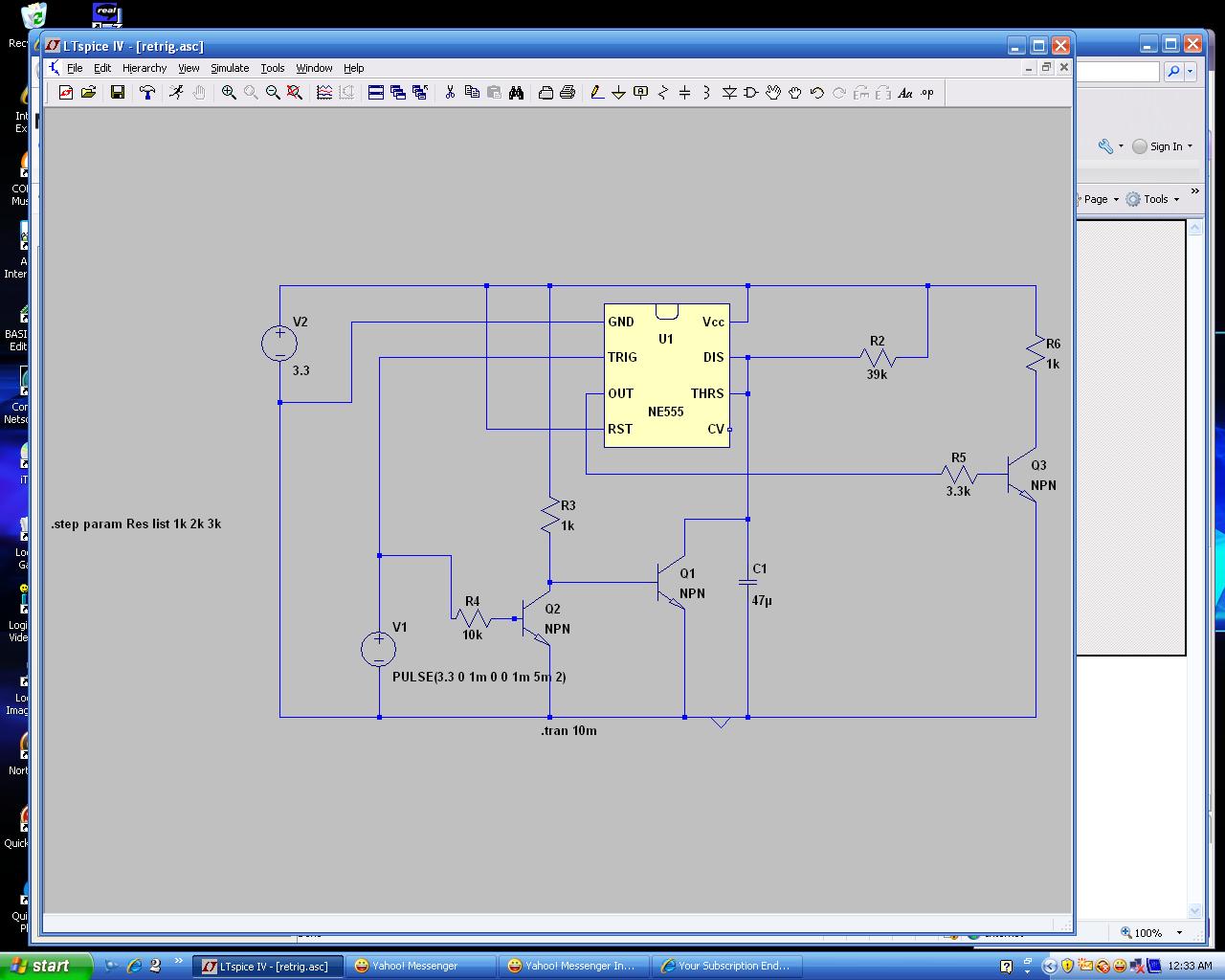

Ok, I drew up a complete design. But for some reason I can't get it to simulate. Here it is, maybe someone can make it work.
EDIT: Ok, I finally think I got it to simulate. More on this tomorrow.

The circuit posted above passed simulation, but it has a glaring issue. Q2 is on almost constantly, consuming power, and I remember you were concerned about power. This circut operated identically, and much more efficeintly. In the simulation, a short pulse comes in from the motion detector at 100 mS and 600 mS. This input is modeled by V1, and shown in green on the wave viewer. The signal that determines the timeout of the timer is shown in red, and completely resets at each occurance of the input signal. The output in blue, remains active over the simulation period. Without the retrig circuit, the output would have gone high somewhere around 800mS.
The input from the motion detector needs to be active for somewhere around 1mS to reset the timer. That should not be a problem, as motion tends to be much slower.

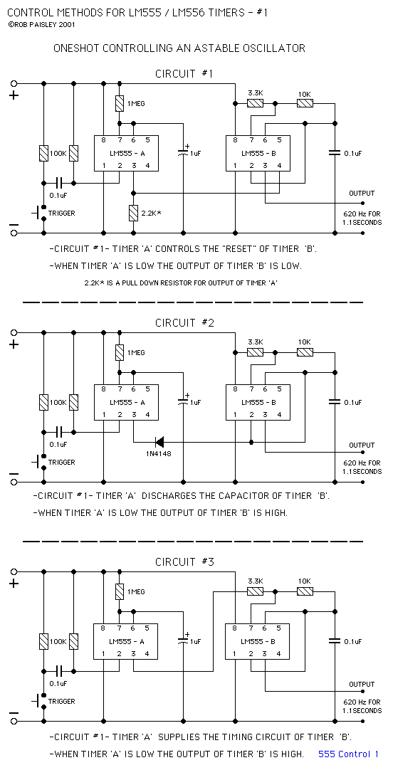

Here's 3 ready made diagrams, I was just going to ask which circuit looked best before I went ahead... looks like all the action is on Pin3 of the first timer..
Diagram from here... **broken link removed**
