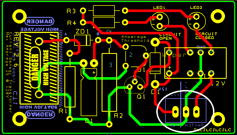

Help Debug Circuit
Good news!So being that the 3906 & the 327 have an emitter voltage of 5
Not exactly correct. The breakdown voltage is the minimum value specified *not* to cause reverse breakdown. For the 2N4401 it is 6.0 V. this means that at 6.0 V, the junction will not conduct (except for some very small leakage current), behaving like any normal reverse-biased diode. But at anything from 6.000001 V to 99 V, the diode will break down. I made up the 99 v, but you get the idea. I don't think I've ever seen the max breakdown voltage specified in a datasheet.
My guess is that the actual breakdown voltages for the two transistors are different enough to affect the circuit.
I think you've rediscovered why using a reverse-biased transistor as a zener diode is a very uncommon practice. It is an interesting characteristic, and can be used to make the world's most simple oscillator, but it is so unpredictable that another thing I've never seen (except for Dick Cappels oscillator) is a design paper / app note / whatever proposing its use. In the classic two-transistor multivibrator circuit, it can have a real effect on the output frequency when the reverse biased transistors clip the peaks of the timing capacitor voltages.
For a one-off home project, with a lot of adjustment range, by someone with enough design experience to handle the consequences, it's fine. But you can see (37 posts later) what happens when the idea gets outside of that safety zone. I'm working on a control system for my garage doors, based on using the parts I have at home and it being used ***only*** by me. Nothing in the design is stupid, but I would not take some of the approaches in a commercial design.
ak
I am so grateful for all the time you dedicated to my project. I have learned a bit more about this circuit and even more about transistors. Yes the start delay range has changed (longer 3-9 as apposed to 1-5 seconds) but as you said these are for my shop and i can handle the changes. My initial concern was that i had wired something wrong or mis interpreted the schematic. But now i know that i got it right and understand just what was wrong. The design. And to top it off its working too. Thank you again ak. :D

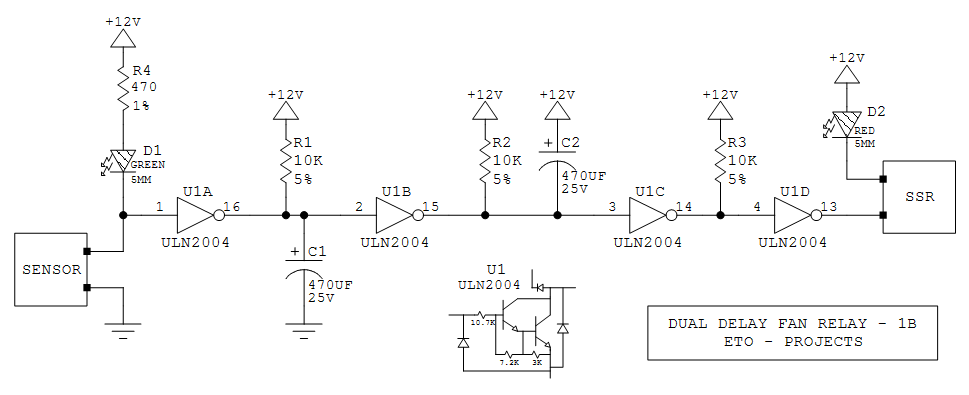

Here is another alternate circuit. This uses one of my favorite parts, the ULN2003/2004. This is a transistor array chip, with seven darlington transistors. It is intended as a driver for small relays, lights, LED digits, etc. In fact is has a zillion uses. I've often used it as an industrial-strength logic device. It behaves as a sept-inverter, a hex inverter with one extra gate. Each transistor is rated for 50 V, can sink 1/2 amp, and has inductive kick spike suppression built-in. It is a great part for harsh electrical environments, such as automotive. You would not believe what the power system in an ambulance looks like. If I were doing this for myself, this is the circuit I would use. But part of that is because this is an old friend. And I have about 50 of them.
In this circuit I use four of the sections as open-collector inverters. You can see the internal schematic for each stage in the insert below. In very round numbers, each input has a transition level (the voltage at which the output changes state) of around 5 V, and appears sorta-kinda as a 20 K resistor to GND. Because this relatively low input impedance is connected to the timing capacitors, the cap sizes are increased to get the same kinds of time delays as the original circuit. Again, the parts values shown are coarse estimates.
With no input, the U1A input is pulled high by the very low current through the LED, probably not enough to produce visible light. This holds U1A's output low, keeping the capacitor voltage and the U1B input near 0 V. U1B's output is high (open), so R2 holds the voltage across C2 a 0 V (+12 V on both ends). This drives U1C's output low, which forces U1D's output open, and the SSR is off.
When the sensor contacts close, U1A,s output goes open and R1 starts to charge up C1. When the voltage on C1 crosses 5 V, U1B's output goes low. This yanks the input to U1C low, and charges up C2 very rapidly. With the U1C input low, its outut is high, the output of U1D is low, and the SSR comes on.
When the sensor contacts open, its input is pulled high enough to drive its output low. This discharges C1 rapidly and drives the U1B output open. This allows C2 to start discharging into R2, and the input to U1C begins to increase. When it (finally) crosses 5 V, the output goes low, making the U1D output go high (open circuit), turning off the SSR.
That sounds like a lot, but it is very similar to how the original circuit works - the action of one timer affects the action of another timer - the end of one timer initiates the beginning of another timer.

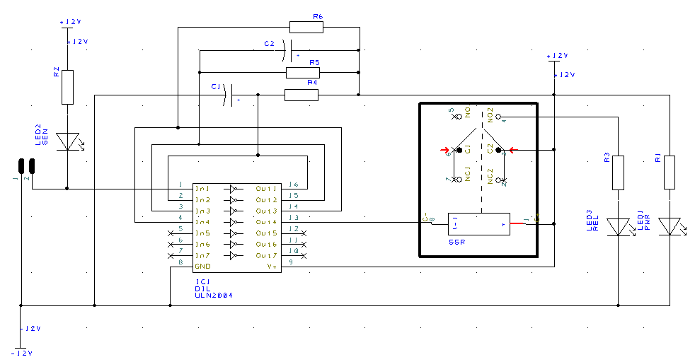

COOL! Ive got a few TBD62003. A quick search shows that they are similar. I could breadboard with the 62003 then order ULNs
I see the dif between the UL...03 and the 04 is the resistor value. 03 is safe with 5V and 04 is good for 15V.

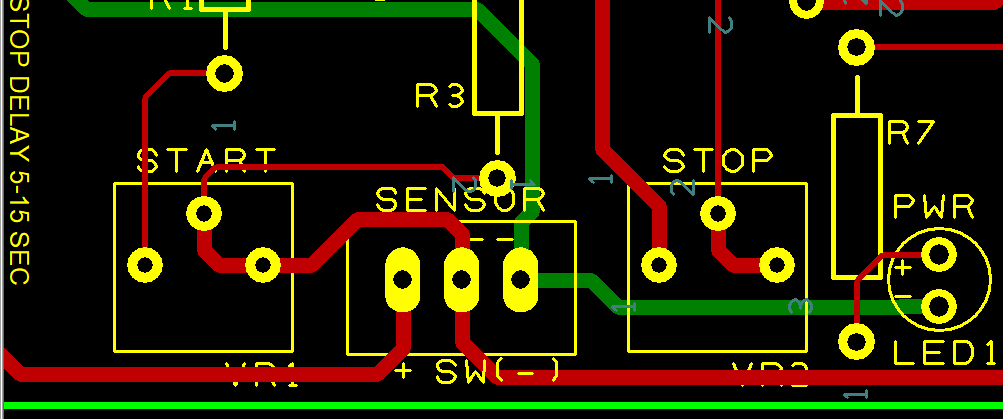

The schematic is difficult for me to understand but ill place it in DesignSpark and see what happens when i let it make a pcb for me. That will give me an idea of how the other components are connected to the ULN.

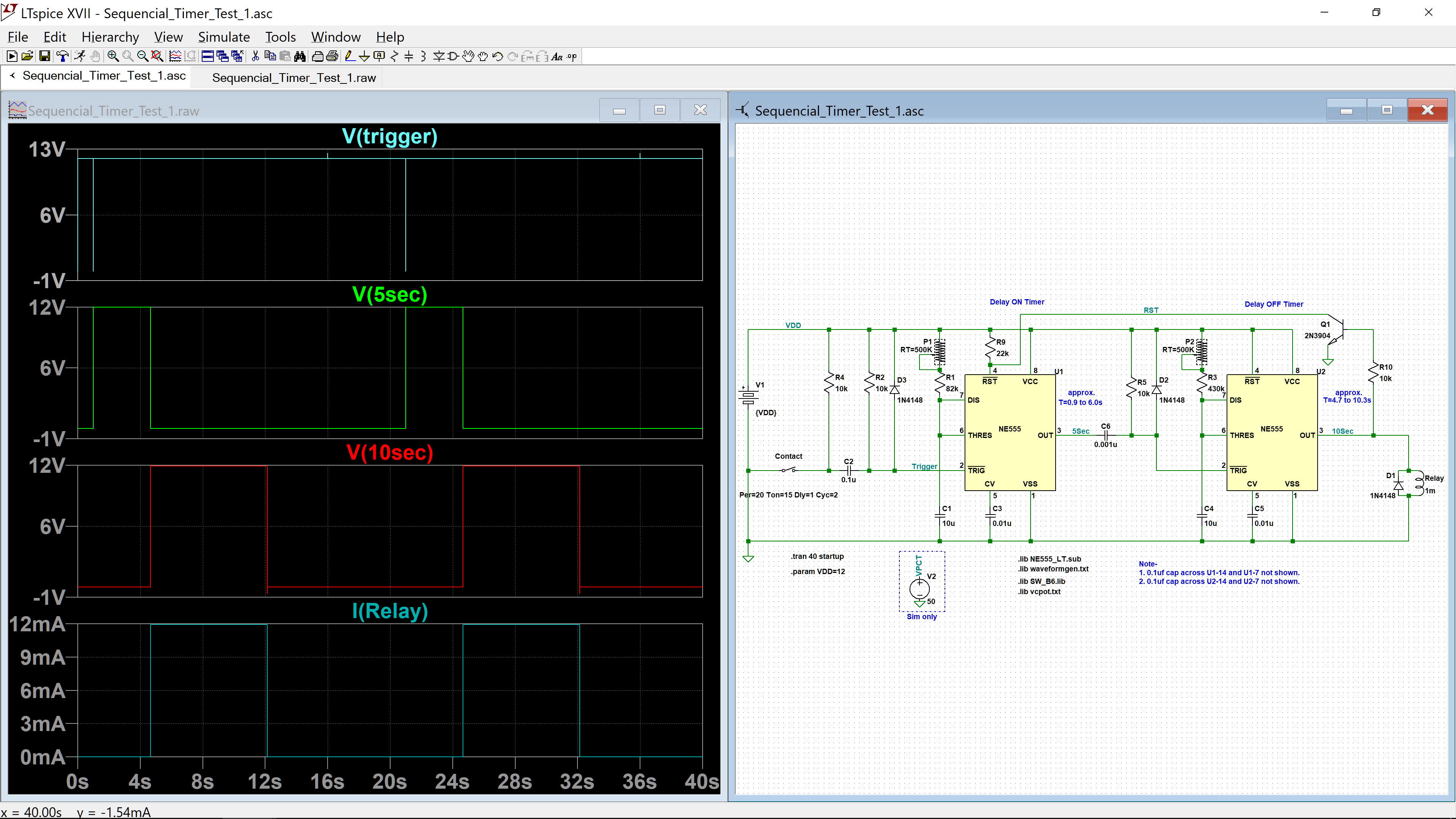

Hello,
If you have a couple of 555's laying around, here's an optional DelayOn/DelayOff sequential timer circuit.
The first timer starts when the contact closes, expires after 5 seconds, then triggers the second timer that energizes the output relay for 10 seconds.
Both timers are adjustable. The BJT prevents the first timer from triggering again until the second timer expires. The output can drive an SSR if desired.
just so im understanding your description. 5 second (adjustable) delay energizing relay after contact closes then 10 second (adjustable) delay de-energizing relay after contact opens.

Thank you for providing a simple but powerful example. Im going to get some ULN2004's The TBD's are not available at Tayda. But the others are. And only .34 each!
Ive read your explanation of how the project works but i dont know how or where to add the variable resistors so i can adjust the on/off. But based on the info you provided i think R1 for the ON delay and R2 would be for the OFF delay. Now from what ive seen in other schematics you need both a fixed resistor and a variable pot in line to provide the minimum and maximum range. I have tried to understand the formula to determine what combination is needed I have to confess my algebra is very poor. My kids however are extremely smart. I mean it too. My oldest is a scientist and my youngest is the youngest person in her Algebra II Honors class. Nevertheless could you tell me what combination i would need to add the delay function ranges?
