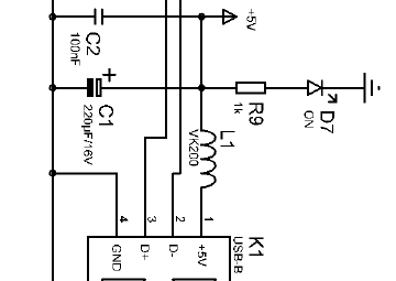

BTW this is the PCB layout , and i wonder what is a good alternative for the L1 component (VK200 self ) , am not sure i will find one like it easily .

could i just use a strap as a replacement for the VK200 self L1 ?
Looks to me like it is part of a noise filter on the USB 5V supply:
